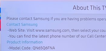

So no Q65FN on the list? I imagine Costco sells a lot of these. But Samsung seems to ignore these models when releasing firmware updates. :/

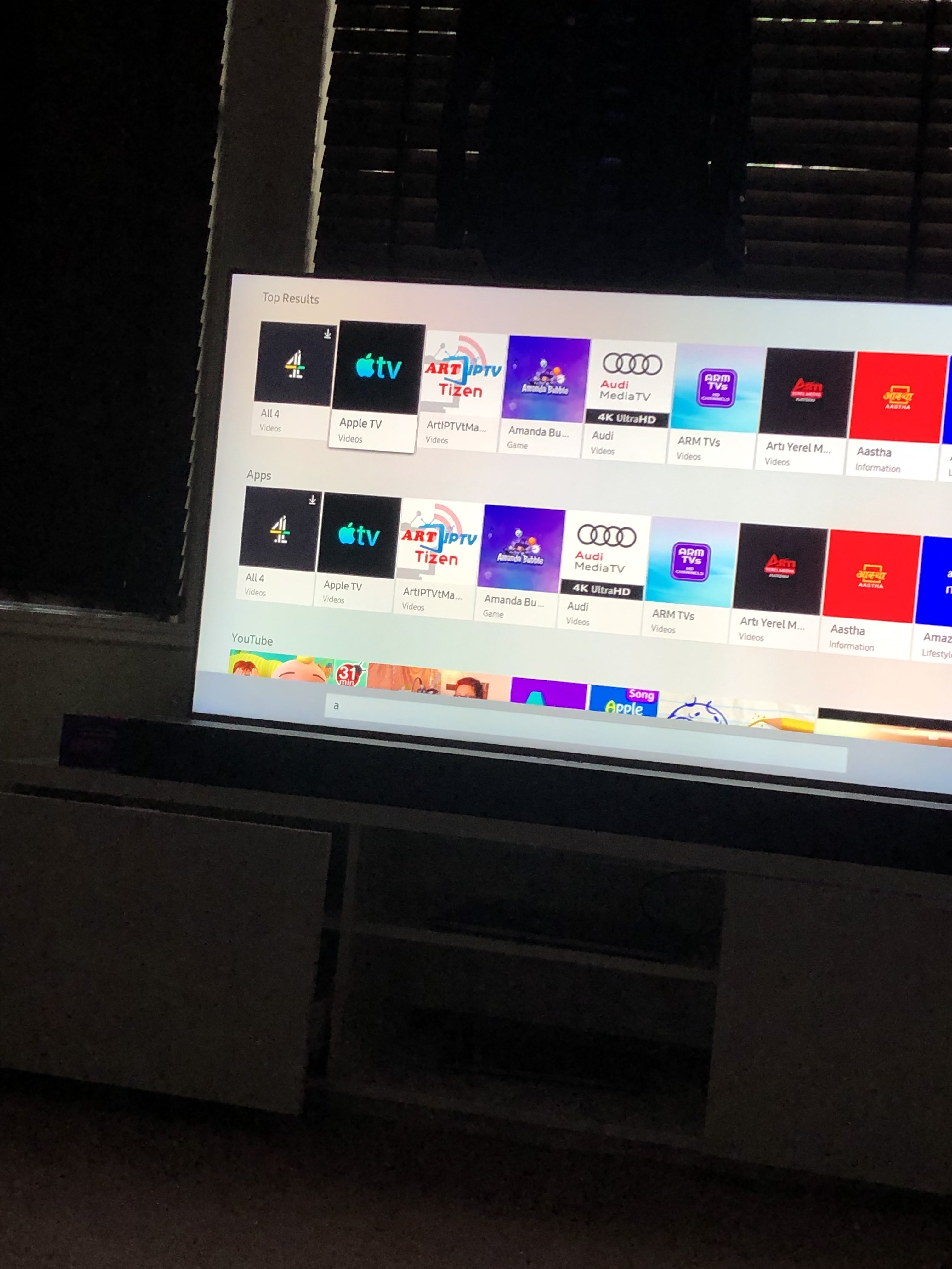

Good question. I have this model number I just got last year and I don't see an update for it. I can see the Apple TV app listed there in the App Store when I search for it but I can't click it and do anything with it

Same exact as yours. It says 2018 Q6 is supported right? I got mine from best buy..not costco.

I had the app on the store and it wasn’t clicking getting the error message. Just reset the tv and now the app isn’t even showing - something must be wrong and they’ve pulled it.

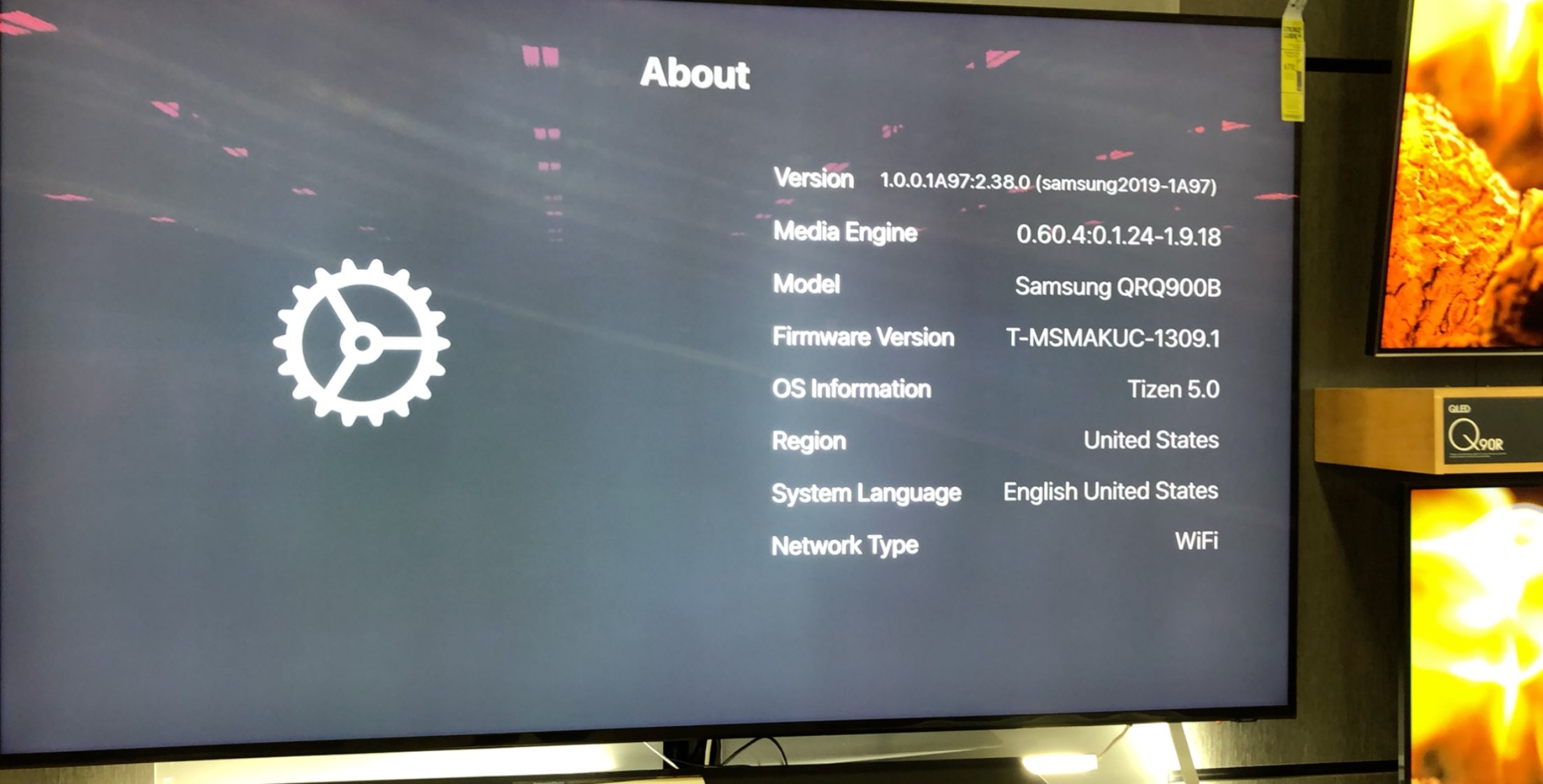

So my Q65FN has the same firmware version number (1251) as the 6, 7, 8, 9 does in the download center. The online download center just doesn’t list a downloadable firmware update for the 65 specifically. I think the TV is updating itself... I’m pretty sure the software version used to be 1209. But who knows. I guess I’ll find out later today or tomorrow.

FYI I still don't see the Apple option anywhere - in the app store or appearing by magic.

My tv model number is UE40NU7120K. Does anyone know if this is supported? I have no new update and I can’t see the app as of yet. I’m in the UK if that makes a difference.

I have a 75" 2019 Samsung Q90R (stellar TV BTW 110% recommend it) and the Apple TV app loaded fine from the store and is working great. I did not need to update the firmware. I'm assuming I will need to update firmware to add Airplay 2 native support. There is no current update available for the TV. My Q90R is currently on version 1065.
