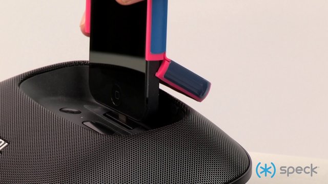

Looking for a dock or clock radio compatible with iPhone 5 with a Speck CandyShell case.
If you'd use a CandyShell Flip instead, all of them work.
It doesn't look like there is enough room behind the lightning adapter on the Sony for the flip cases.

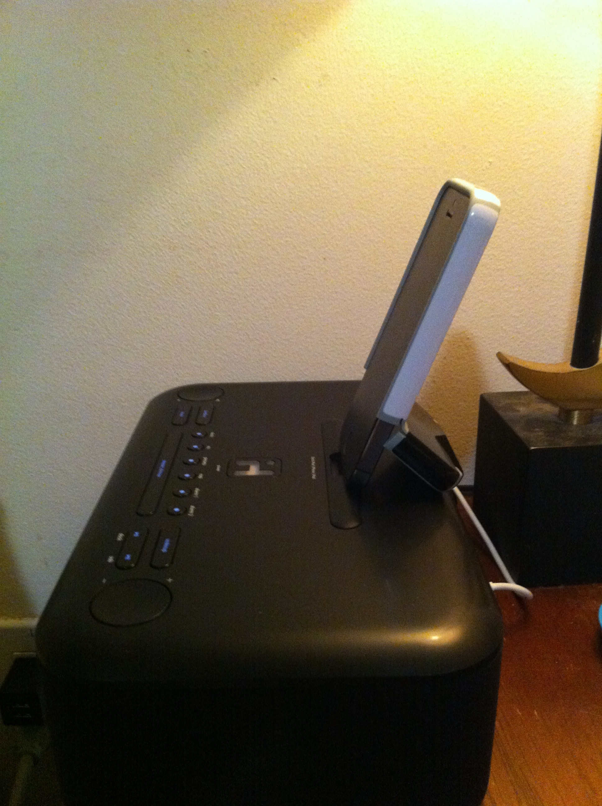

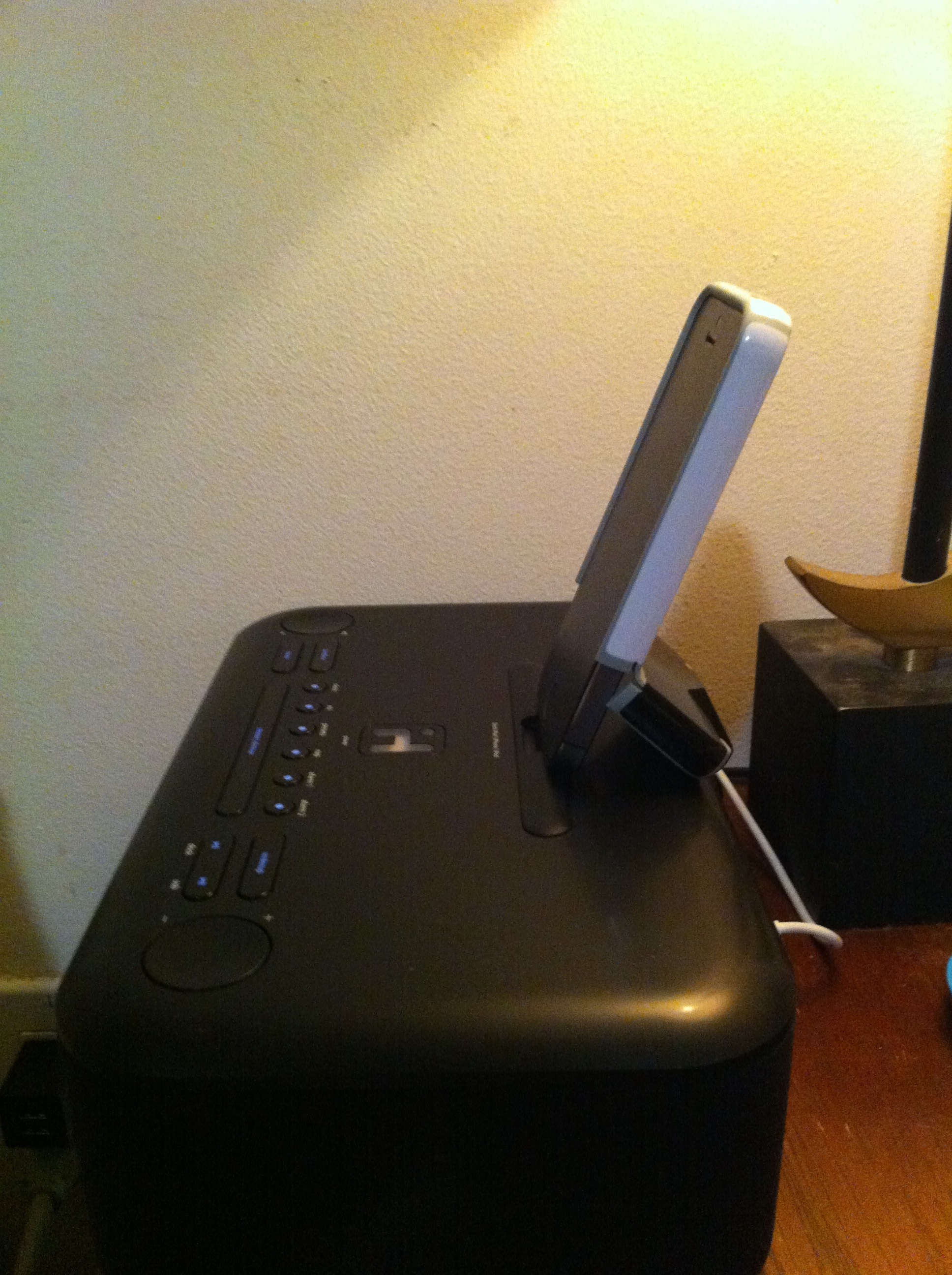

Quick fix for Ihome iDL45 and iPhones with cases
Just a heads up for those who want to get or have the Ihome idl45 and use it with their case attached while on the dock, but can't since the support bar for the iPad gets in the way. Anyways, I was bored today and wanted to see if the bar could be removed without damaging the unit. Turns out it was really easy and took less than 10 minutes. I'd post pictures of the whole process, but don't want to take it apart again, but it's pretty simple.
You'll need the following:
Small phillips head screwdriver.
Small flat head screwdriver.
1. Turn the unit upside down and unscrew the 8 black screws with the phillips screwdriver.
2. Remove the side panels and you'll see that the top panel has a ribbon connected to a circuit board .
3. CAREFULLY pull the tab that connects the ribbon to the circuit board and set aside.
4. Unscrew the 4 silver screws that connect the circuit board to the body, then pull it out and set aside.
5. You'll see the support bar is connected by two more screws. Remove those and then use a flat head screwdriver to loosen and pry it out.
Take out the bar and set it aside for possible future use and then just reassemble everything, by doing steps 5 to 1. If you don't like or use the radio antenna, just tuck it in the body before you're done and it looks a lot cleaner.
Final Product shot with my Speck Candyshell flip. Connects just fine! 😀

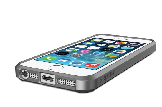

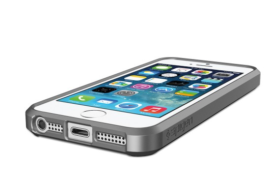

Any updates? Anyone find a working Alarm Clock/dock that works with a case?
I have a Spigen Ultra Hybrid and wonder if it would work with one of these?
