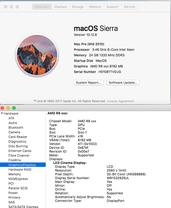

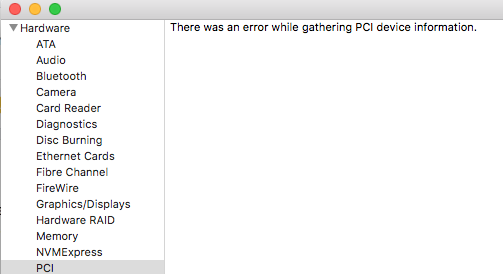

My MSI RX 580 boots in MacOS as long as you have 10.12.6.
Uni performance seems comparable same as my R9 did.
Stuff isn't listed correctly, but that's to be expected. Let's see what High Sierra does when it comes out.
