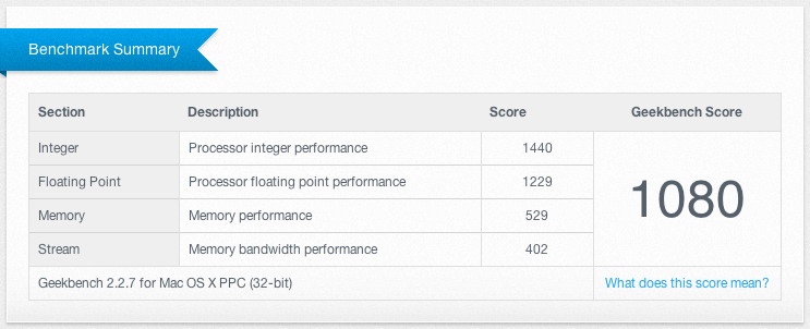

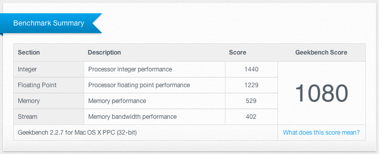

This is me, a solid 1080.

Someone else also has a dual 1.25Ghz G4 MDD and we're nearly identical.
And they weren't kidding when they said a low end G5 was around 1000, I was surprised to see a SP 1.6 GHz G5 on here recently.

Sorry... I checked with my buddy, as I borrowed his MDD for a few weeks years ago, and it's actually a dual 1.42. I remembered it as a dual 1.25 for some reason. Anyway, I remember getting 1200+ in GB 2.
Sorry... I checked my my buddy, as I borrowed his MDD for a few weeks years ago, and it's actually a dual 1.42. I remembered it as a dual 1.25 for some reason. Anyway, I remember getting 1200+ in GB 2.
And I mean, it doesn't mean I don't want to end up with a dual 1.42. But as much as +200 on GB2 seems like a lot, when you start comparing the scores to Powermac G5 systems on the list, you get things like:
I actually have one of these, the dual processor and dual core 2 Ghz G5 systems simply lap a 1.24 dual MDD G4, with a 1909.
