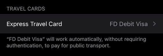

Any of you enabled an 'Express Travel' card and still experience this problem ?
If you mean 'Express Transit', it's not yet enabled on the London transport network, so it will (unfortunately) make no difference to this experience until it is.
Also see https://www.theverge.com/2019/5/30/18645394/apple-pay-express-transit-london-tfl-tube-support-uk

Well, 'transit' in the USA, 'travel' in the UK ;)
I was curious to know whether TFL might have partially enabled the technology and it was causing issues for the AW4 ?

Apple refer to the capability as Express Transit, which was why I asked: https://support.apple.com/en-gb/HT209495 ... though I note in Settings it refers to the card as Express Travel Card (even in the UK). Confusing!
In any case, the issues noted above started way before there was any such thing, so I highly doubt it's related.
