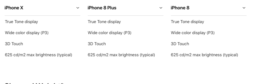

Galaxy Note 8 seems to have a lot brighter screen than iPhone X. This could cause problems in sunlight. It's little bit problematic that Samsung most likely uses their best OLED's to their own phones. What do you think? Could LG come up with better OLED's for more competition?
Samsung Galaxy Note 8 OLED 1240 nits.
vs
iPhone X OLED (made by Samsung?) 625 nits.

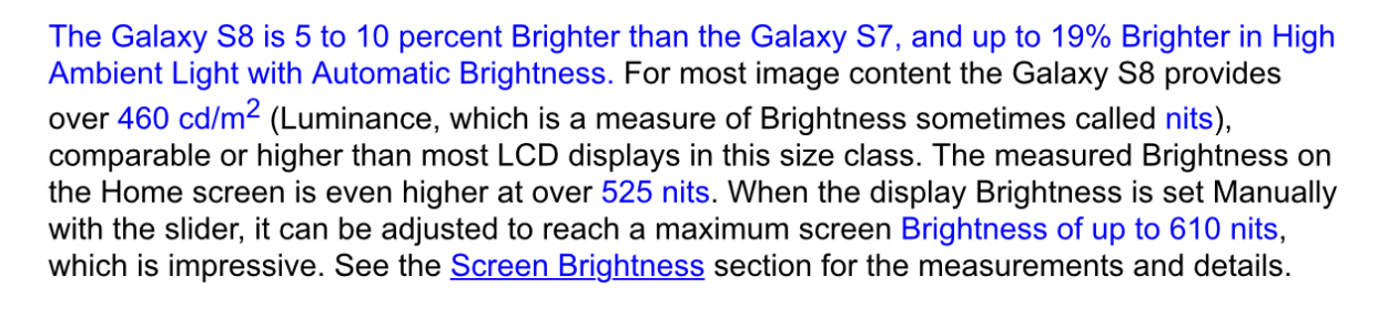

Doesn’t look so bad now eh 🙂 courtesy of DisplayMate

not too worried. we don't know how apple measured this and if it's really the max value on auto brightness.
samsung always had a very high max value for the last few years, but that value was not sustainable and the base value is much lower.
and keep it mind that very high brightness reduces the OLED lifetime faster.

View attachment 718487 View attachment 718487
You need to read the complete write up...
“When Automatic Brightness is turned On, the Galaxy S8 produces up to a very impressive 1,020 cd/m2 (nits) in High Ambient Light, where high Brightness is really needed – which is the brightest Smartphone display that we have ever measured.
If a screen is 500 nits 95% of the time (100% of the time for people who don't use auto-brightness or are indoors) then it is a downright scam to market it as higher. I have read the whole article
Oh and the value is actually "560 – 1,240 cd/m2". It depends on the picture level. Displaymate is not very clear about this, but most likely the highest value falls into the "This is the Peak Brightness for a screen that has only a tiny 1% Average Picture Level." category.

The iPhone X should appear to you as bright as the iPhone 7 (625). Before the iPhone 7 they were 500 nits. If that doesn't put your mind at ease independent reviews found all iPhones exceeding Apples rating when set to automatic brightness (example iPhone 7 from displaymate had 700 nits). Since Apple is referencing ALL iPhones they have a margin for error.

I personally think it's not the display, but Apple holding back the brightness on that phone. It's the same nits as the 8. That should tell you something.
