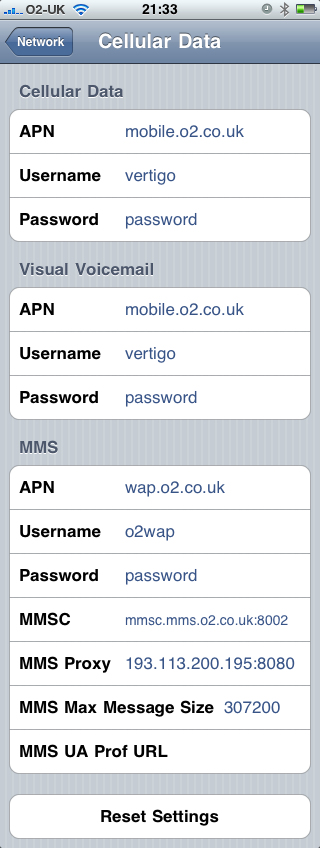

Patched Carrier File
I've patched my carrier file with settings attached (see the image) and both tethering and MMS work for me. I'm unsure about billing implications at this point.
From my testing, tethering works perfectly with mobile.o2.co.uk but looks like you need the tethering bolt-on to use idata.o2.co.uk.
Unless all APNs are set to use idata.o2.co.uk, the iPhone will fail to tether and will remove the tethering option. This must be hard coded.
Therefore, the answer is to avoid the idata.o2.co.uk APN entirely.

To get tethering working I didn't actually manually type in the details shown in the screenshot. I edited my carrier file to apply the details for me.
All the carrier file does it let you edit the default carrier settings such as user names and APNs.
You can use the latest iTunes 8.2 to upload a new carrier file by making a small config change seen here: http://www.unlockit.co.nz/forum/index.php?topic=4.0
I've attached mine, simply remove ".zip" from the filename.
In response to tethering over idata.o2.co.uk, I could enable it but couldn't get any internet connectivity. I reckon this is controlled by O2 depending on whether I pay for the extra bolt-on.
Some people have reported manually having to add the following MMS settings under "Cellular Data Network" but it's one small step to get tethering working:
APN: wap.o2.co.uk
Username: o2wap
Password: password
MMSC: mmsc.mms.o2.co.uk:8002
MMS Proxy: 193.113.200.195:8080
MMS Max Message Size: 307200
MMS UA Prof URL: [Blank]

Check your Cellular Data Network settings and ensure MMS is complete:
APN: wap.o2.co.uk
Username: o2wap
Password: password
