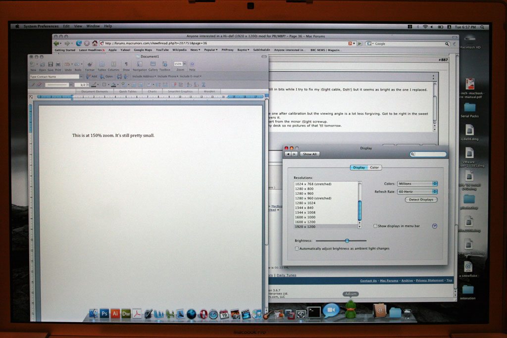

It Lives!!!
The LG screen works!
I used the sleep method, wouldn't just boot even on Leo.
For those who are wondering, it doesn't have to be a 1900x screen, I just used an old 15" we had floating about at work. Hit "Detect Displays" after the swap and it bumped me up to HIGH res!
The brightness controls work fine, I've not had a chance to play with it (the machine is still in bits while I try to fix my iSight cable, Doh!) but it seems as bright as the one I replaced.
I'll post pictures and answer any questions when I get home.
EDIT
Ok, Got my iSight working again. The screen is just about as bright as the standard Apple one after calibration but the viewing angle is a lot less forgiving. Got to be right in the sweet spot or the brightness tails right off. But the increase in screen real-estate more than covers it.
I've restarted, slept and everything is working fine. I'm surprised at how well it went, apart from the minor iSight screwup.
Unfortunately I left the memory stick with the pictures of the back of the LCD board in my desk so no pictures of that 'tll tomorrow. Just one of the desktop as it is now.
