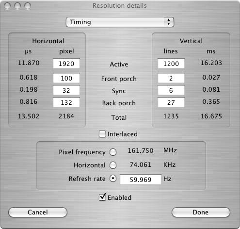

Well, I've had a partial (and by that I mean very partial) success. Using PowerStrip in windows to get the timing data, I mucked around with it using DisplayConverterX. However, it wouldn't let me enter the values exactly, it kept changing them no matter what I did, so I was only able to get close.
The display now displays the bootloader at native 1920x1200 resolution, in correct color. It also displays the booting apple symbol, and the little spinny thing below it in correct color at the right resolution. As soon as it hits the desktop though, everything goes to hell. I'm sort of at a loss as to what to do at this point.
OK, I tried using SwitchResX instead, and it let me set the values properly, but the status is the same. Everything works fine until the desktop appears, then its all gibberish.

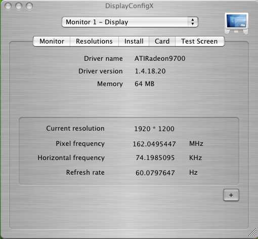

I don't think ther resolution is the issue here. Clearly the hardware can handle it as demonstrated in XP. I believe it has to do with the default refresh rate of the MBP under OS X - Most probably to do with the panels that ship with the MBP being quite new. The panels we are trying to use are quite old by comparison and use a 60Hz refresh rate. Also LCD's are often a little more fussy about refresh rate than say CRT monitors. I'm just wondering if there is a way to unlock the refresh rate feature through a terminal comand or something. It seems as though Apple block you being able to change it through the standard displays pref. Also I can't quite remember but maybe you can't changer it on all digital connections? Like when using ACD etc...
Anyway here are some specs for my panel running OS X maybe shed some light.
According to the OSX86 project you can edit your boot files to set like 1920x1200@60 or something like that... haven't tried it out yet though.
Hmm.. I attempted to run displayconfigx to see exactly what my MBP puts to the screen, but it is not giving me any results; it wont let me install any resolutions (its unregistered) and the card info window wont give me any info except what vid card its running.
Think the info would even be of use?
