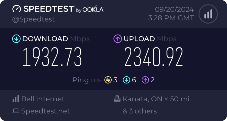

seems the same here on my MacBook Air M3 with my 2.5Gbit Anker USB-c adapter:

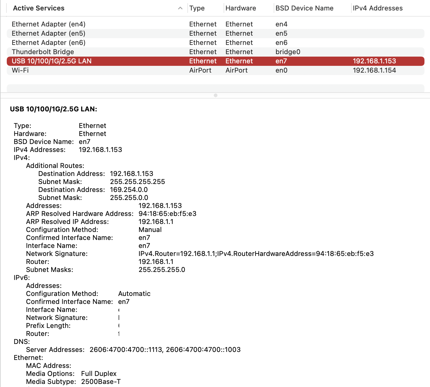

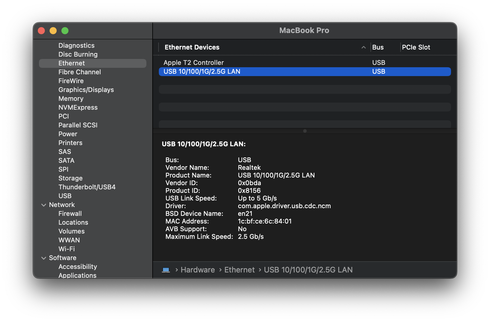

With your ethernet adapter attached, open System Information > Ethernet and locate your adapter. Curious which driver is loaded in Sonoma vs Sequoia.
Is this what you are looking for @Bigwaff ? This is from the 15.0 install. I don't have the Sonoma Mac at the moment.

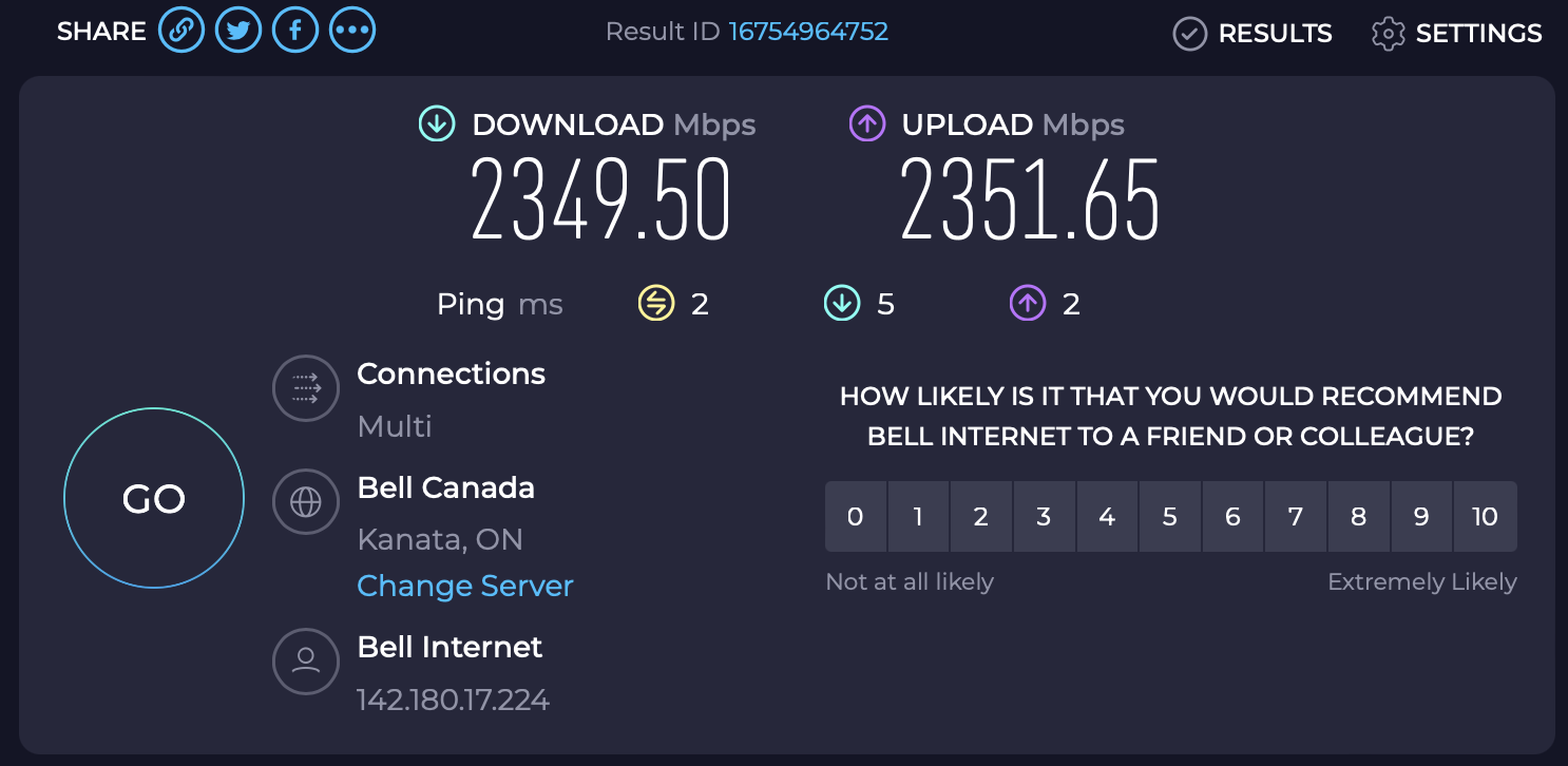

@SG- @Bigwaff @dmccloud today I got the Sonnettech 10GbE adapter, it gets the right speeds! So MacOS, iOS, iPadOS don't handle the 2.5G adapters at full speed right now. 10GbE adapters, albeit more expensive, are all probably fine.

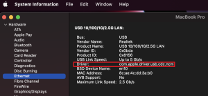

The driver is Apple provided. macOS will load the NCM driver for 2.5G adapters. Good intro at this link.
FYI this is a bug supporting full speed with the 2.5G adapters....I just set up a 10GbE adapter from Sonnet, and it gets full 2300+ d/l speeds on the same MacBook Pro.
Not fixed in MacOS 15.0.1.......Belkin 2.5G adapter gets around 1945 Mbps d/l/ max, Sonnet 10G adapter gets 2350 Mbps d/l on my Comcast plan.
