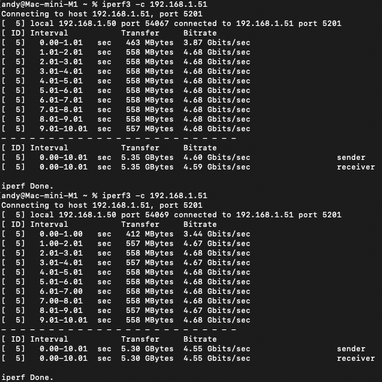

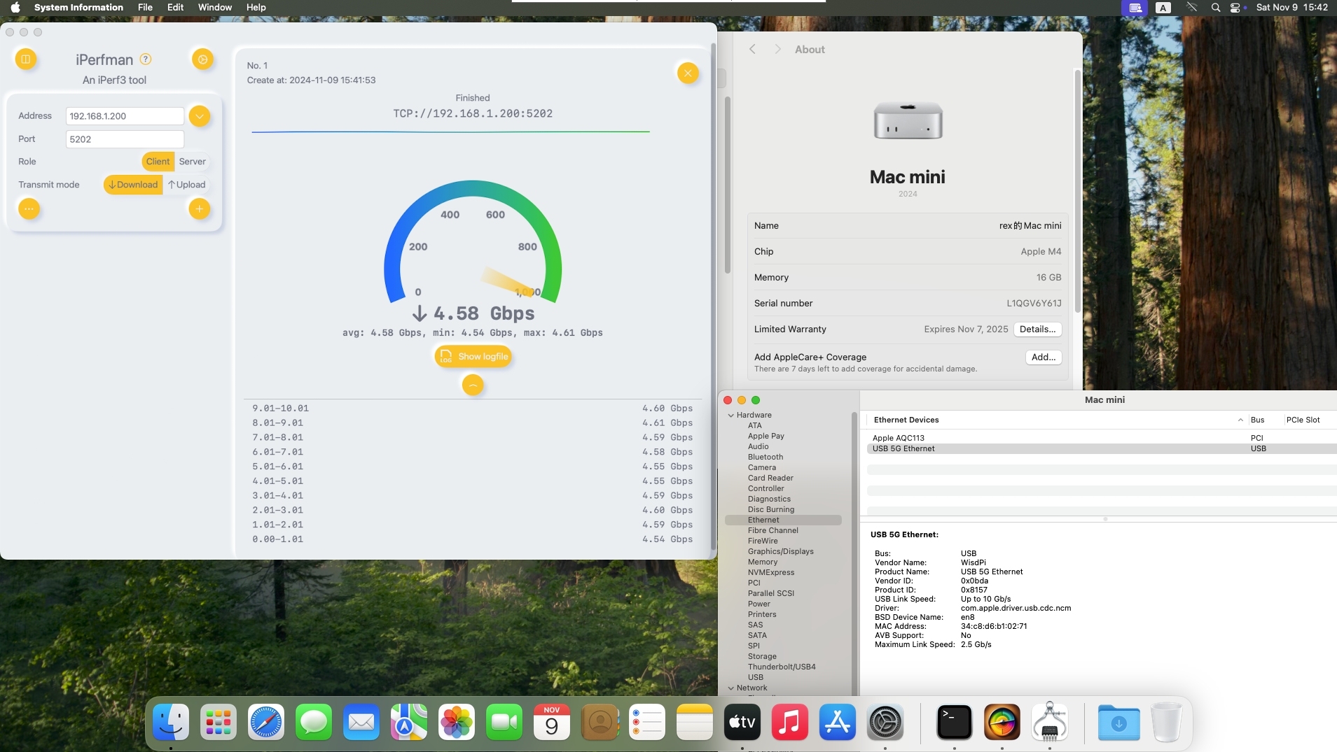

here we go:
(Direct connection between the two macs, my network hardware has just been upgraded to 2.5gbps, it will be some time before I upgrade to 5/10gbps ;) )
Excellent job with this adapter @wisdpi, it doesn't even get hot, so far I haven't detected those network instabilities in the logs anymore (knock on wood).

here we go:
very nice to see near 5Gbit speeds.
I agree, it stays cool and the adapter comes with both usb-c and usb-a cables in case you need to use it in older systems.

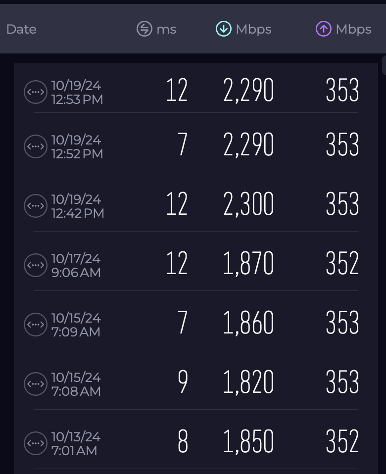

Just got one of the Wavlink 5G adapters (I ordered a WisdPi one too, to test!).

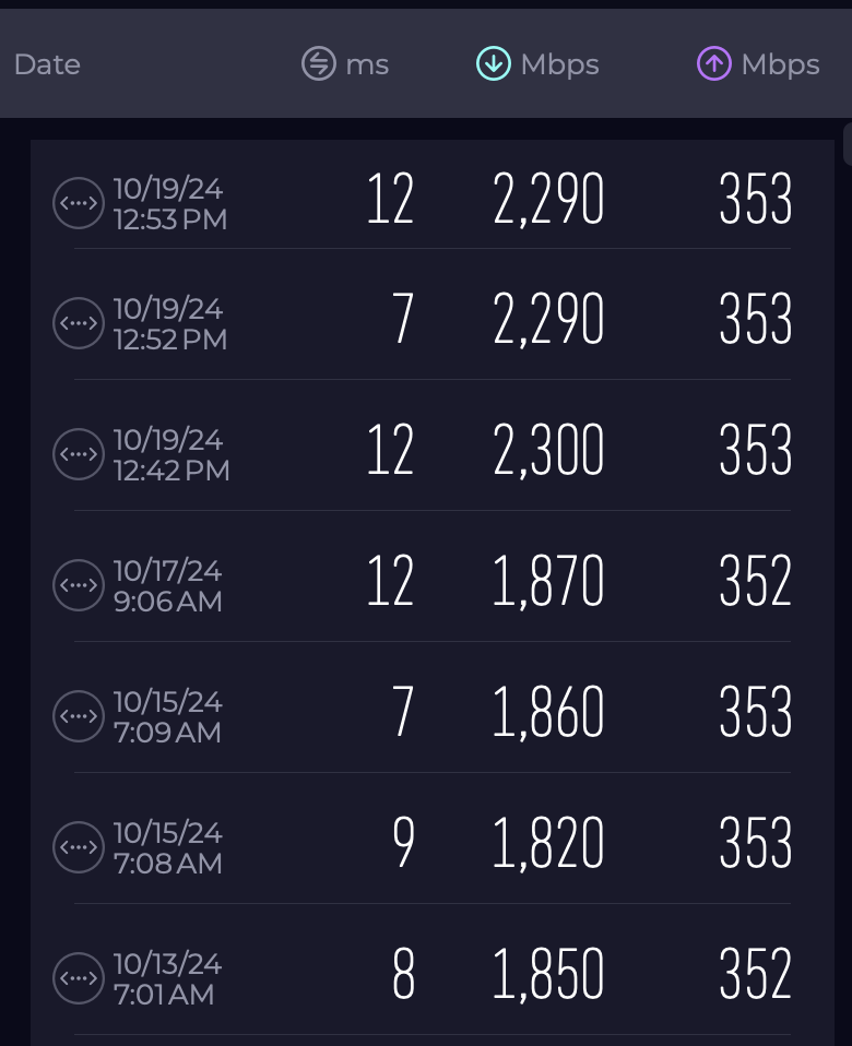

I just plugged it in, out of the box. Speeds look good, you can see the jump in speed here:
So far it's only slightly warm too.

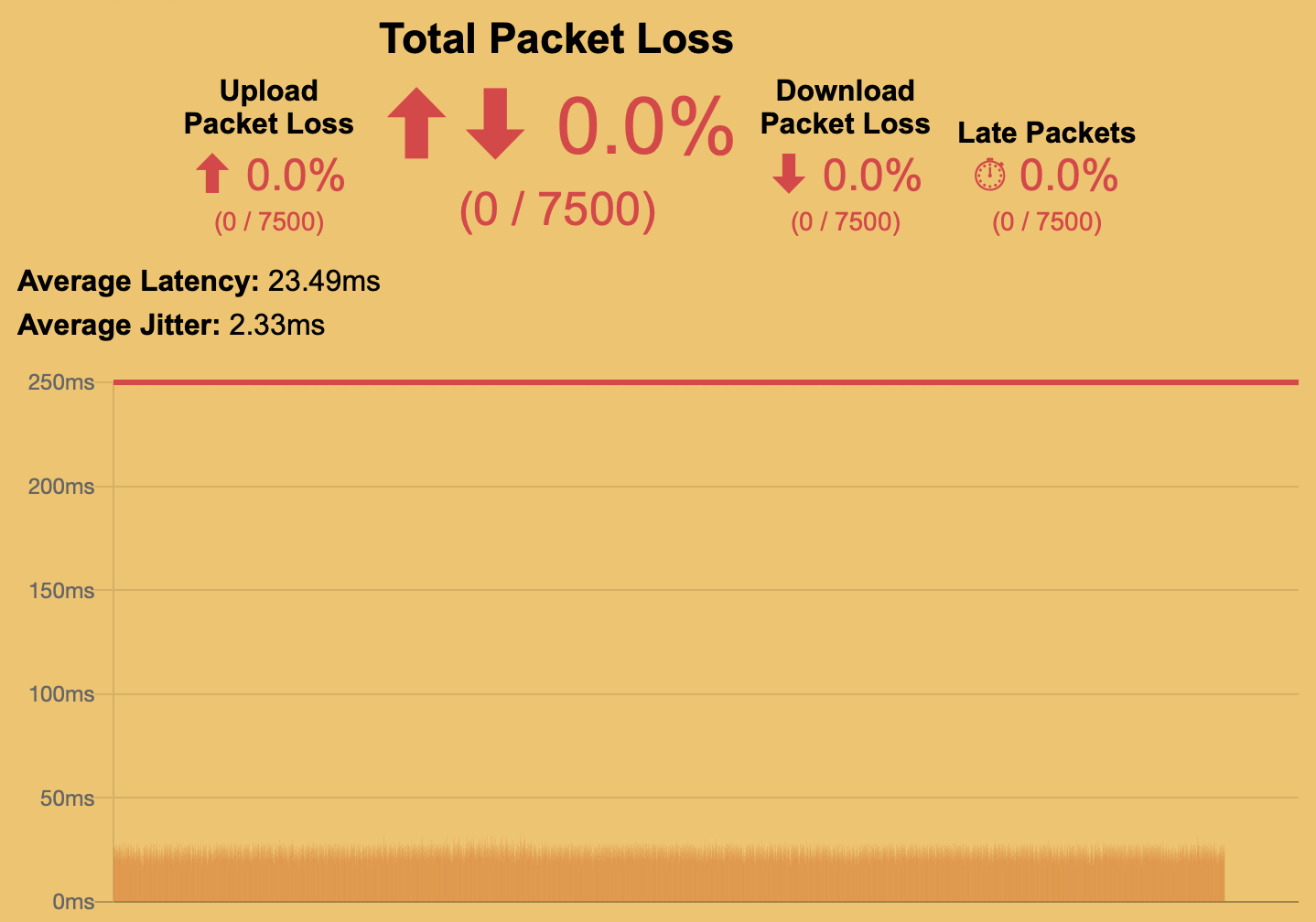

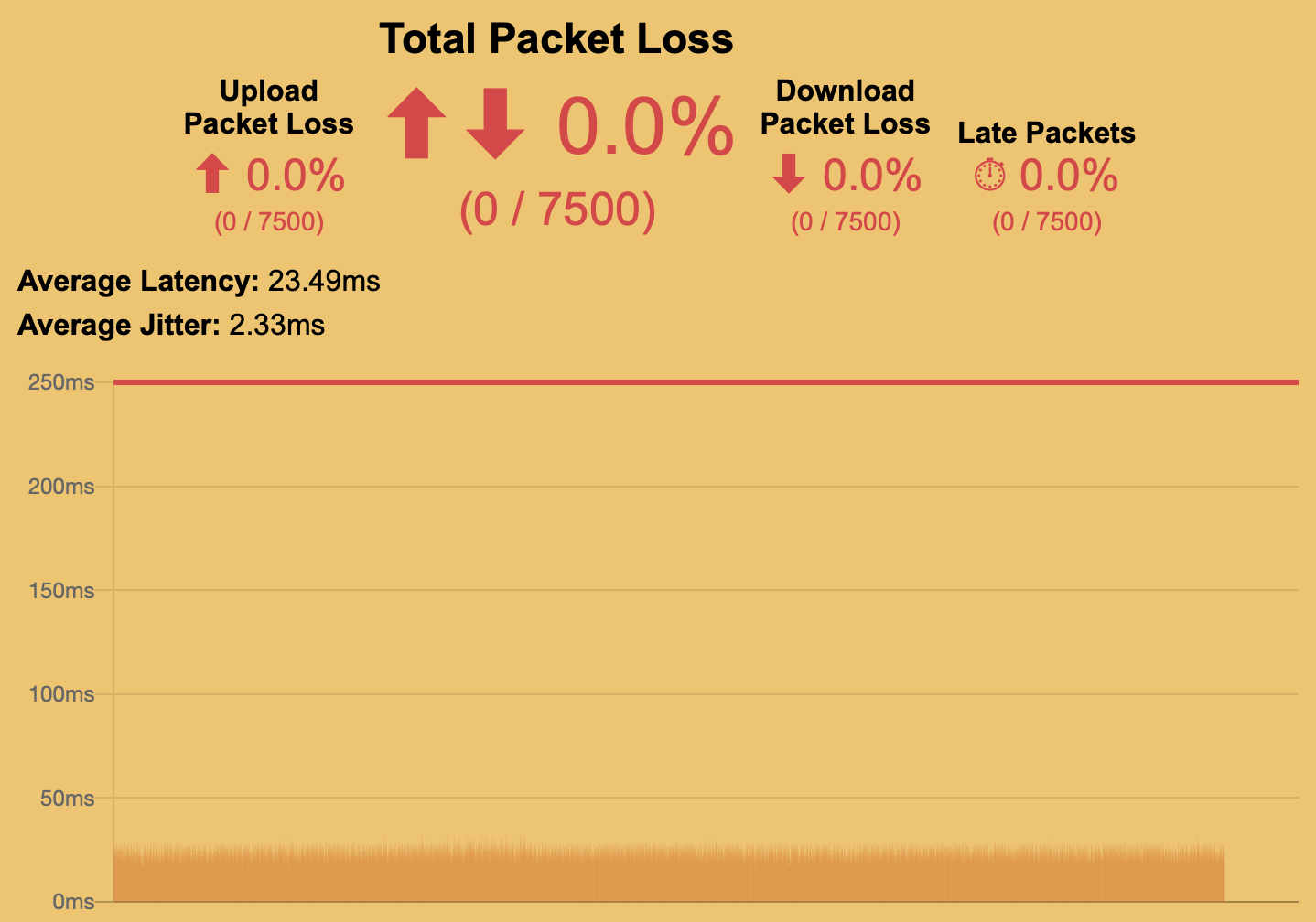

Packet loss/jitter test for 30 seconds was great - no late/dropped packets - I did the "Zoom video" config test, being more rigorous in data sent/received:

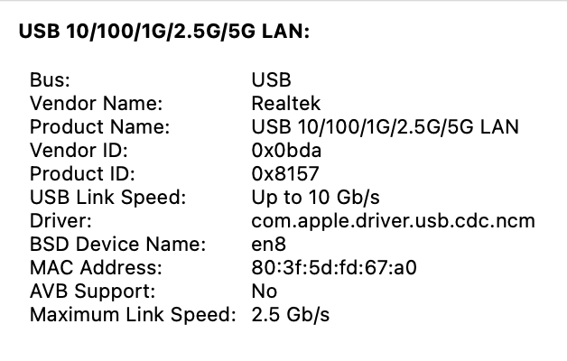

1) The pamphlet mentioned loading a driver for the Mac. I checked there web site, there is one - looks like it might be version 1.0.22. Is this needed, and/or did those with the Wavlink install the driver from the web site?
2) How can I tell which version driver my Mac has now, to see if it's older than 1.0.22?

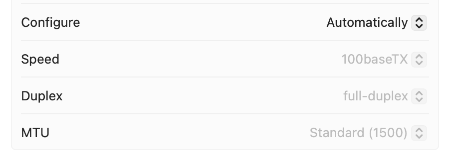

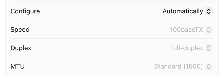

3) As you can see speeds are full 2Gbps again, yet this was odd - in the settings under the network connection, under hardware, see this - it says the connection is 100BaseTX. Is that due to old driver or just a mistake?

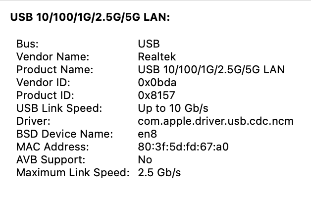

The System Report info:
Mine shows the same on my MacBook as well. I did wonder why the 100mb connection speed was listed but if you change to manual there isn't a choice for anything above 2500. Also noticed the Maximum link speed says 2.5gb/s. I am running beta 4 and all of that shows the same for me. Speed are as expected with the 5gb adapters (WisdPi & Wavlink both 8157 chipset) but still slower with any 8156 based chipset adapter.

Been testing the WisdPi adapters, it gets the right speeds for me (2200-2300) as well as the Wavlink one I tested further up. I prefer the WisdPi one as it's a little cooler to the touch.
