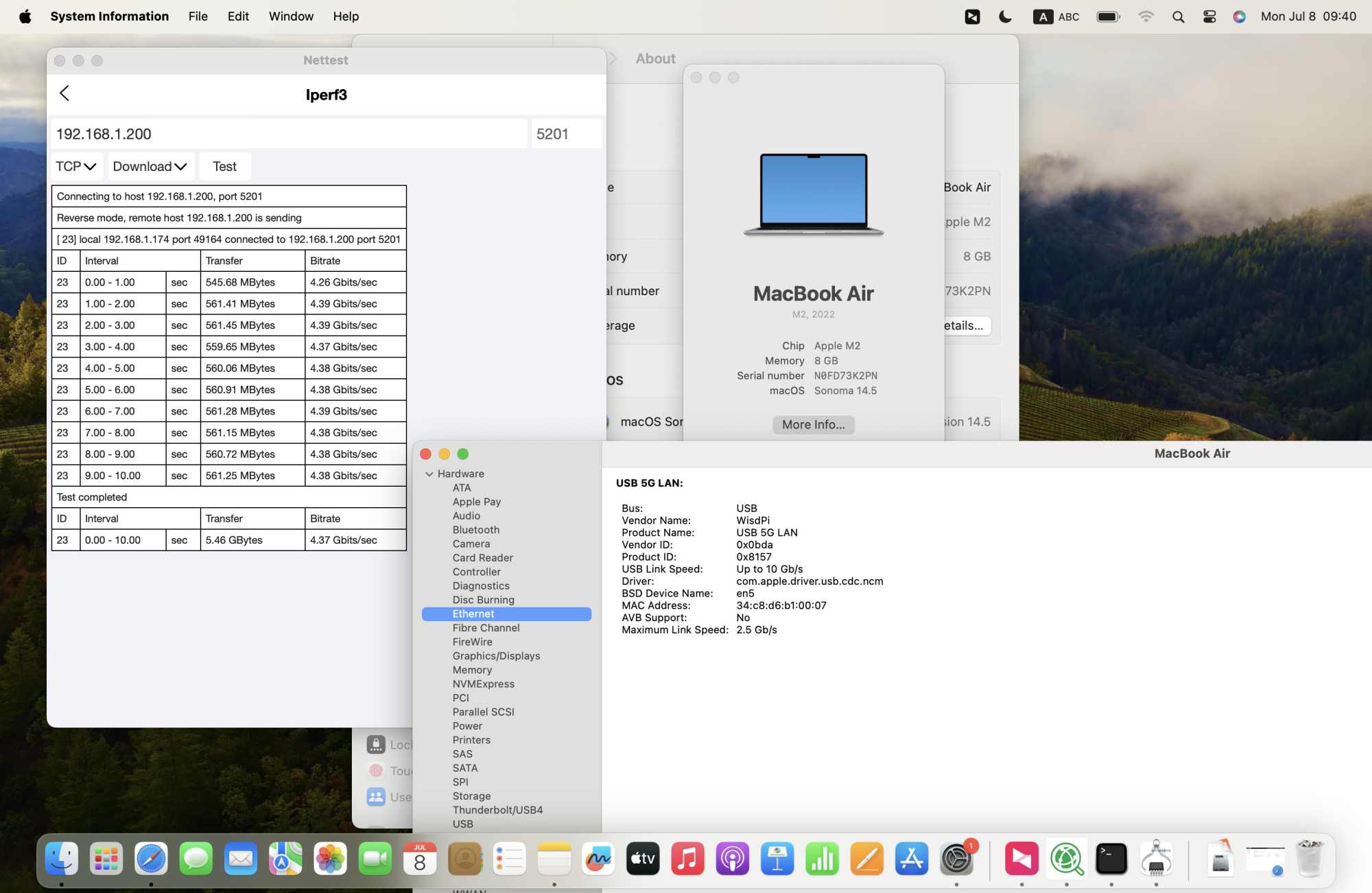

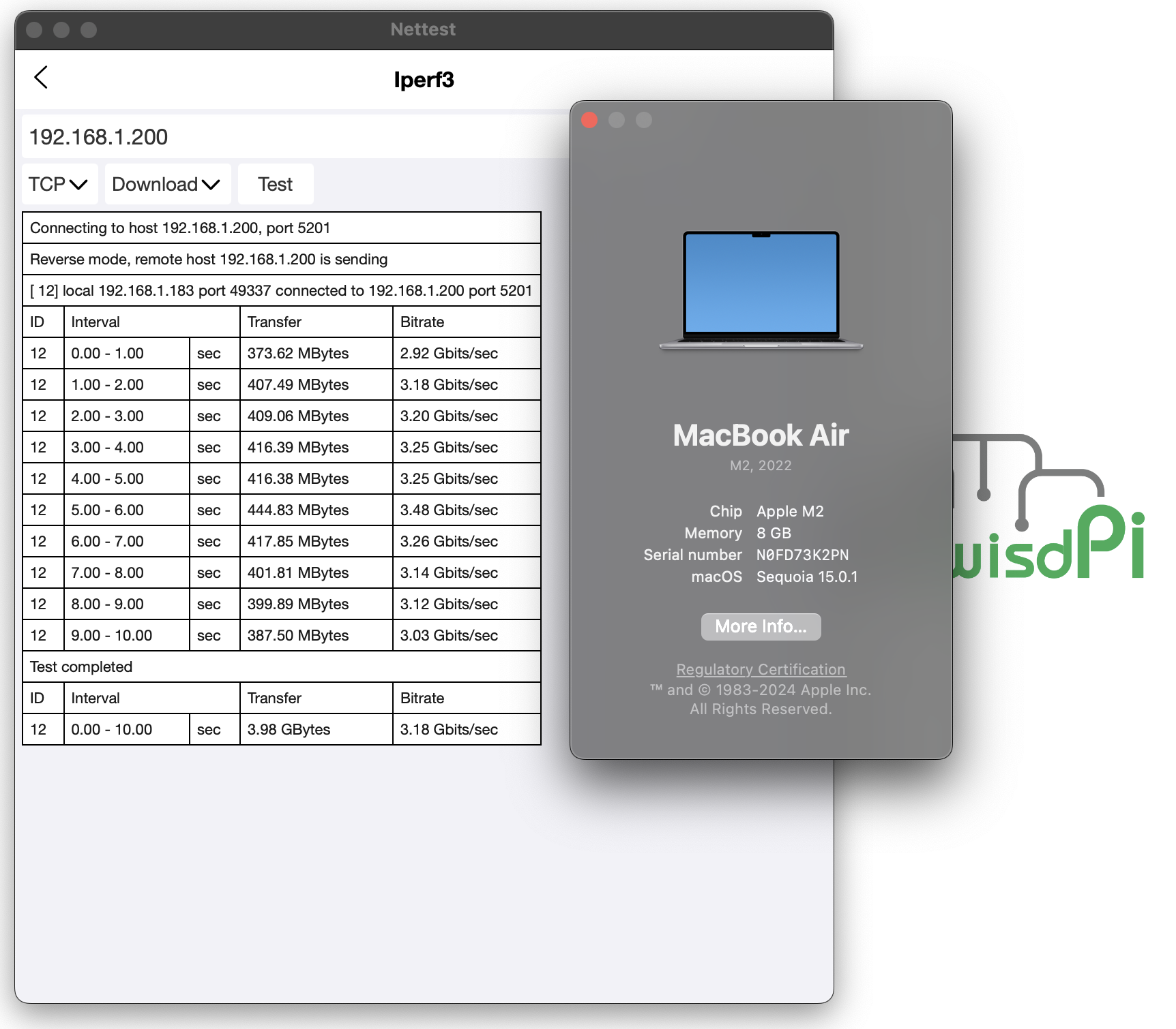

WP-UT5(RTL8157) can achieve speeds over 2 Gbps on macOS 15.0, but unfortunately, it is much slower than on 14.5. Here are some differences between 14.5 and 15.0.
WP-UT5 + Mac OS 15.0
WP-UT5 + Mac OS 14.5
