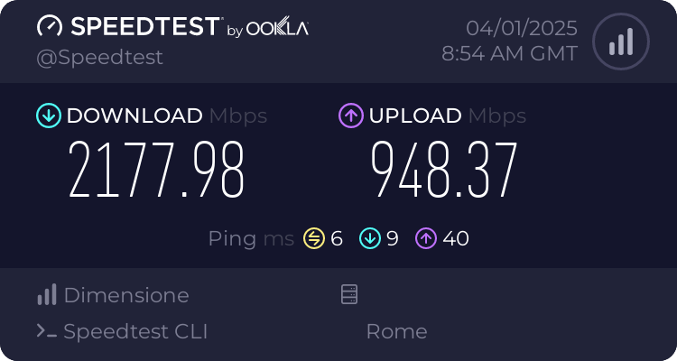

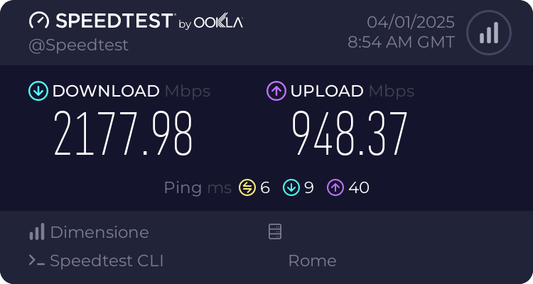

I gave in a few weeks ago and bout a Wavlink 5GbE adapter, and IIRC Sequoia identified it as such already. I may be wrong, though! It definitely did and does not have the "1.8 Gbps cap" problem:
It's especially nice to max out the transfers to and from my NAS. 😀
Ye, but it didn't have a "complete" driver, but with MacOS 15.4 released yesterday, the system is able identify the device and able to change manual speed in system settings. Not sure how much improvements, but this means Apple had added driver support for this Realtek chip.
