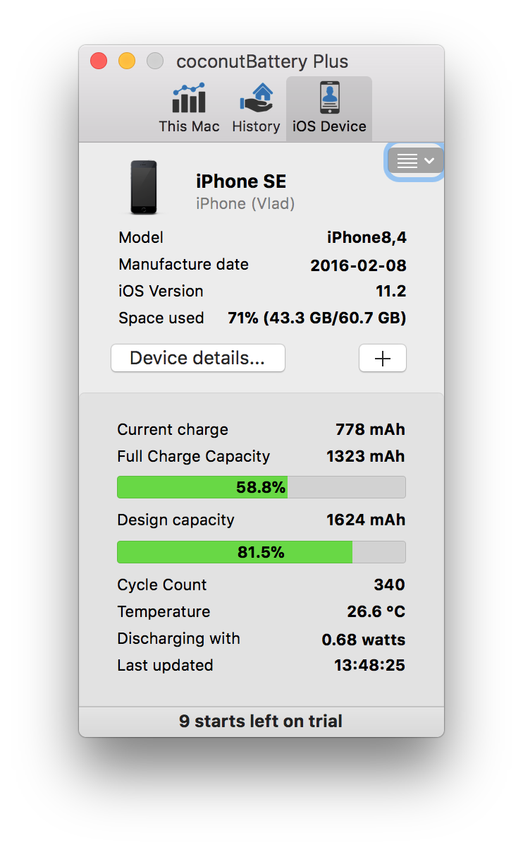

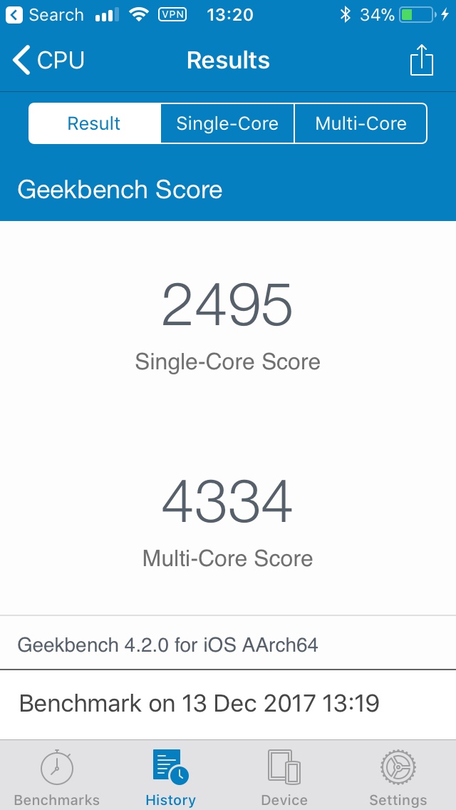

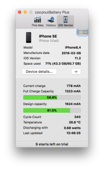

Today I’ve proven myself a controversy that iOS throttles down performance of your device when Battery dies. CPU in my iPhone SE couldn’t go above 900MHz for the past month. So I decided to replace battery and everything is back to normal. iPhone SE is very snappy on iOS 11.2 now!
Old Battery:
New Battery:
Old Battery:
View attachment 741835 View attachment 741832 View attachment 741831
New Battery:
View attachment 741833 View attachment 741834
Old Battery:
New Battery:

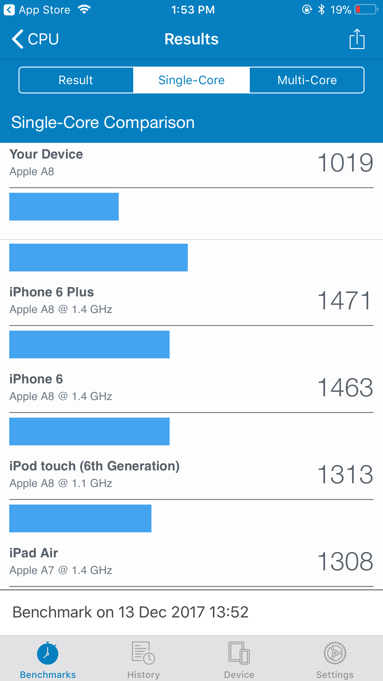

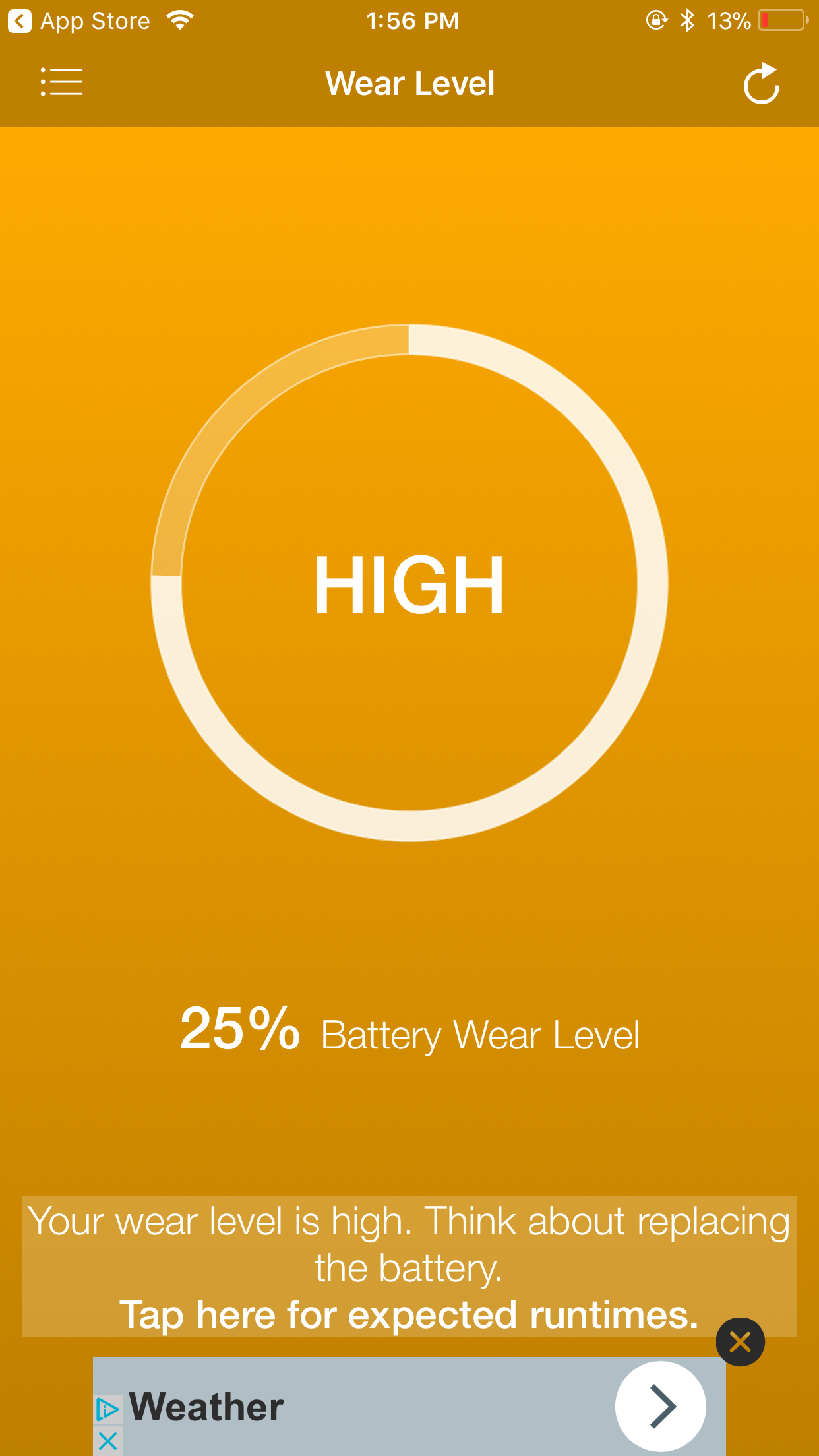

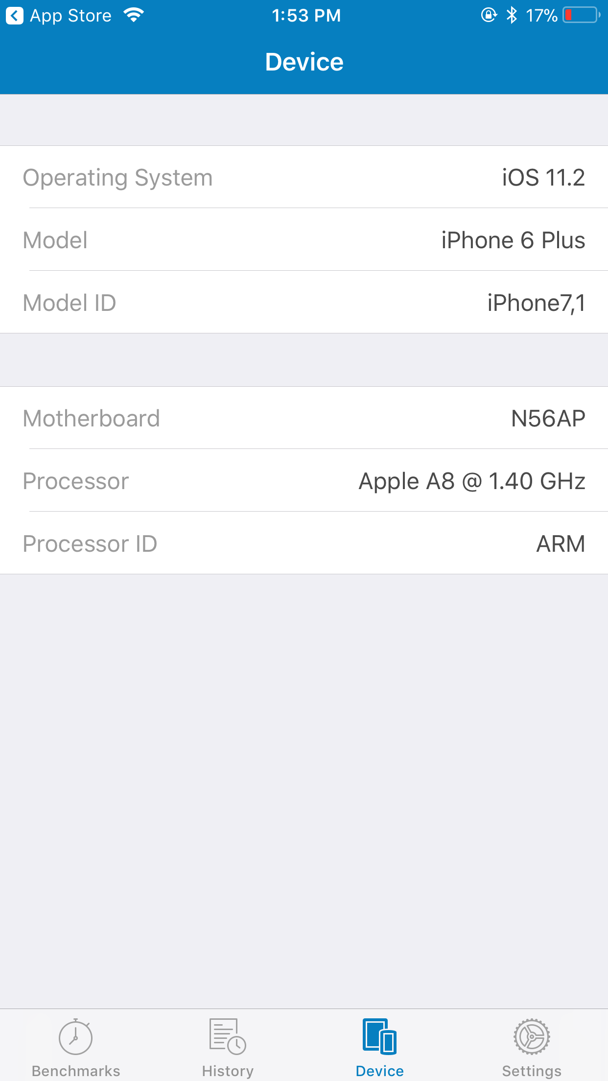

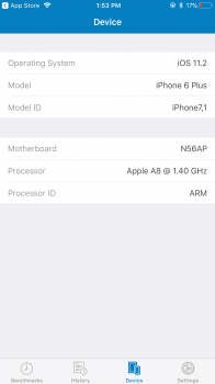

I just ran a Geekbench test and Battery Life test on my 6+ I've had since release day. I'm not sure I'm going to spend the money to replace the battery as I only use this phone as a GPS for my motorcycle in the summers. It is always connected to a lightning cable when I ride.

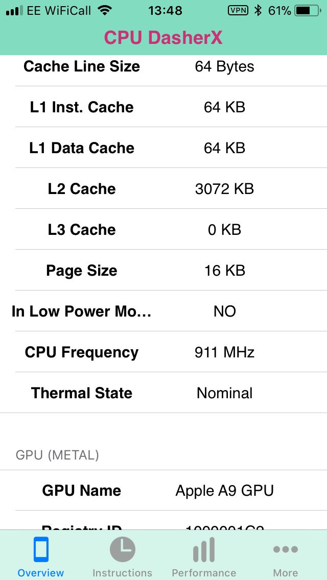

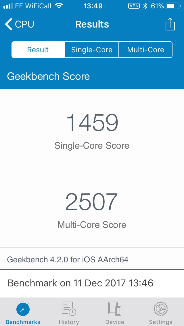

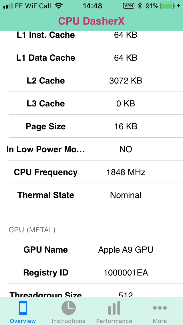

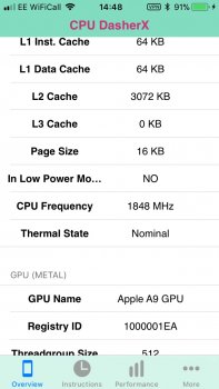

For those using CPU DasherX. I would open and close the app a few times to check your cpu speed. It reports the speed at the time not the max speed. Either that or my iPhone X is wonky as when i last looked it was showing it as 2064mhz and i'm not in LPM.
The text in CPU DasherX is almost all Chinese for me (literally Chinese characters). Not sure why or how. Is the version on the Irish store different to the US store? Now that we don't have the iTunes connection, we can't tell version numbers...
