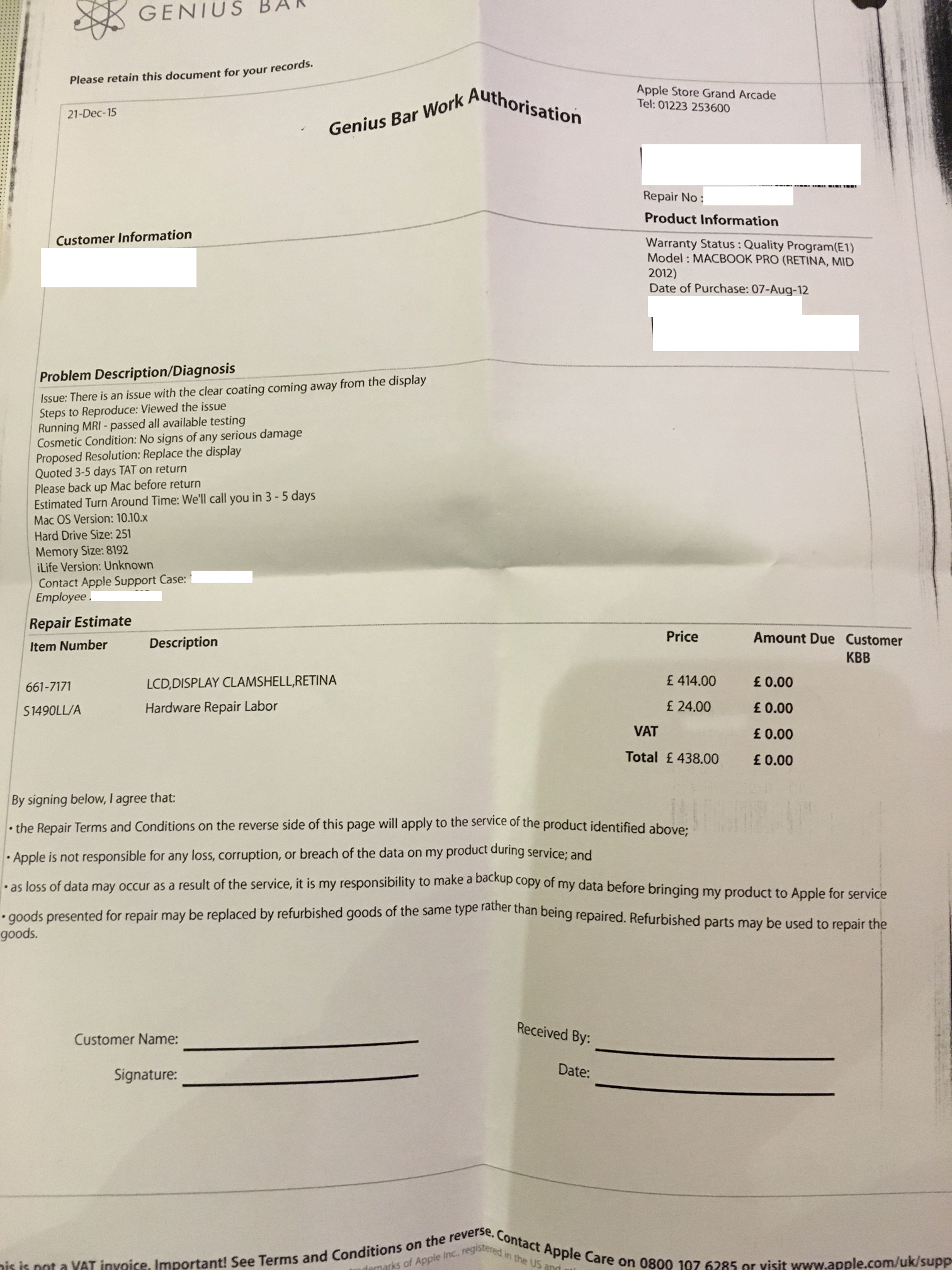

I can confirm that Apple does acknowledge this - see the works authorisation I obtained for my MacBook Pro
To those suggesting people have been "cleaning them wrong," I can say in my case, I've never used any solvents on my screen. I've only ever used a fine microfiber cloth in combination with getting a little humidity on the screen by blowing on it when there's a visible smudge. It's unacceptable for people whose job revolves around visuals—or anyone, really.

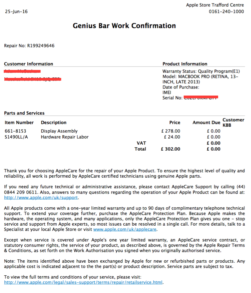

Wow I had this same issue two weeks ago. I have never had any issue with water damage and all of andudden they "found" it inside my computer and won't replace the screen unless I pay 1200 dollars.
I took my 13" Macbook Pro into the Apple Store Trafford, UK, and they accepted it for repair without any hesitation. All I did was show them the delimitation at the Genius Bar, and then said "I understand Apple has a repair programme for this". Left the machine overnight and it was ready the next morning. They replaced the entire upper shell (which was nice, as it had a scratch on it) and also gave the whole thing a good clean - my keyboard feels like new, and I swear even the speakers sound better.
Work confirmation attached.
