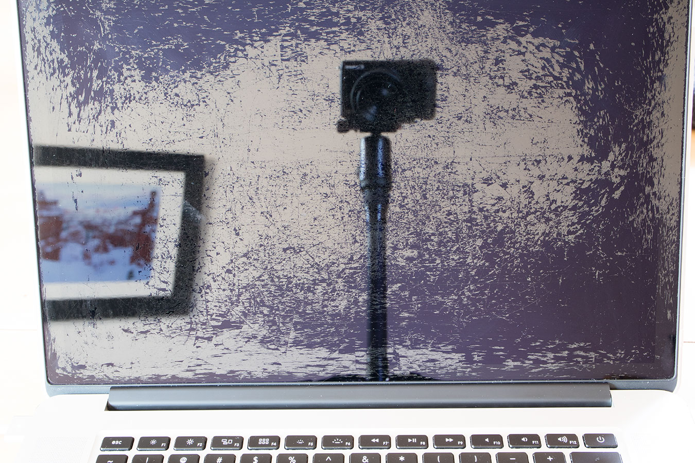

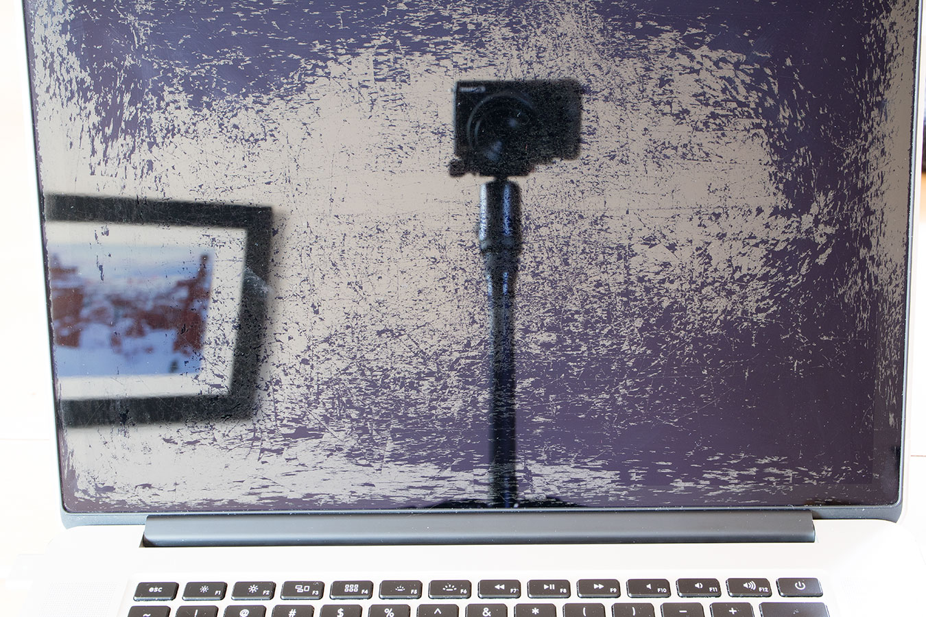

1. Mine has staingate but only in the "black" area of the screen (the black border around the LCD), there is no stain within the LCD area, will they still cover it and repair it?
Only one way to find out 😉 The coatings on my screen were deteriorating mostly around the outside, where the screen gets touched by fingers most, with some slight key shaped staining in the centre.

Here's an update to the Apple Macbook Pro Retina AR Coating issue. Back in October 2015 Apple replaced the screen ($1,400) at no cost under an internal display replacement programme. Only a couple of months ago the same issue started to occur again.
After providing photographic evidence of this issue, Apple asked me to take the system for confirmation to an AASP in Cairns today. 2 hours later Apple Executive Liaison calls me to agree to my resolution. Apple are now replacing the whole computer with the latest model at no additional cost to me. I've had this one for 2 years. N.B. I am in Australia.

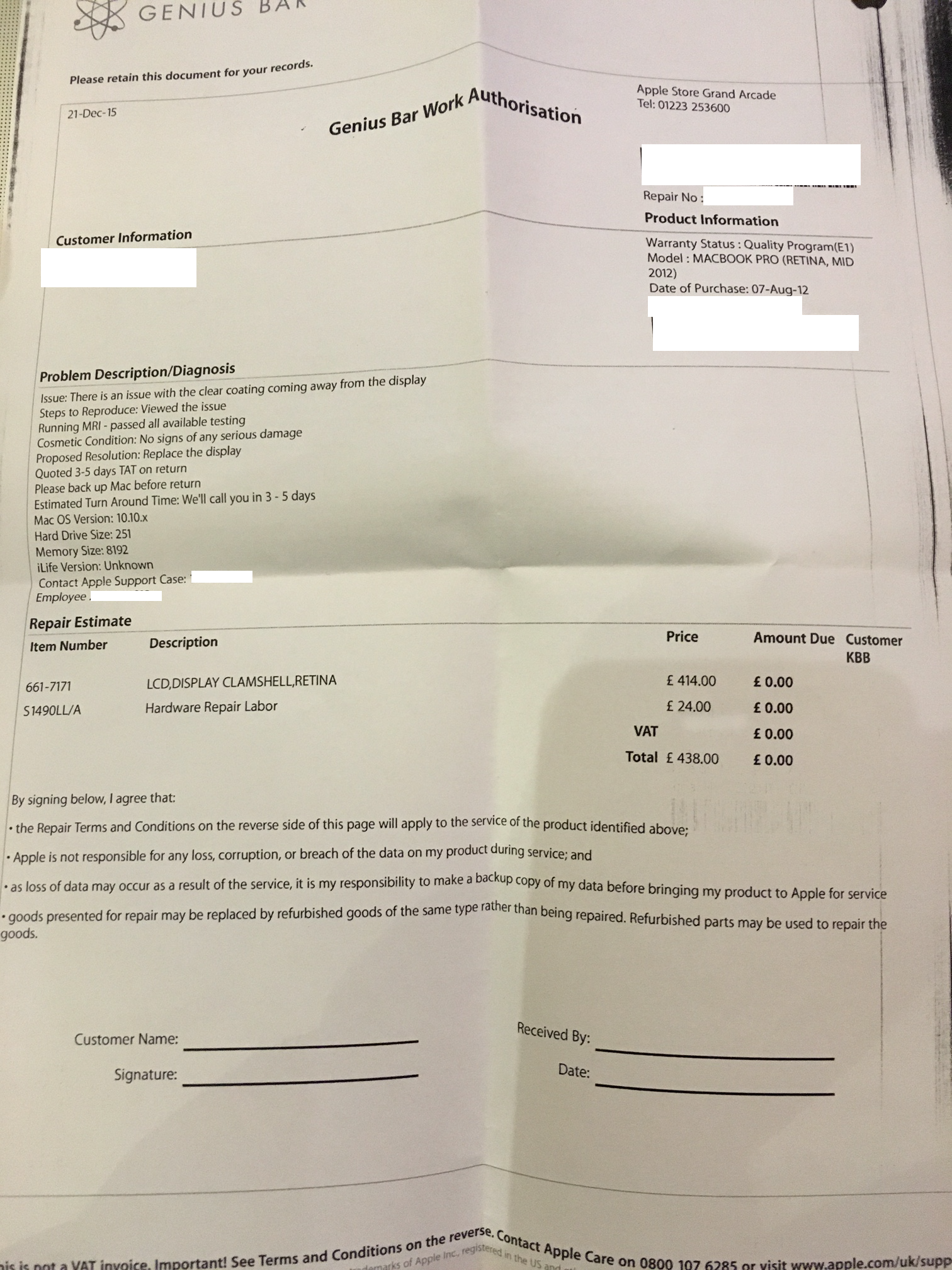

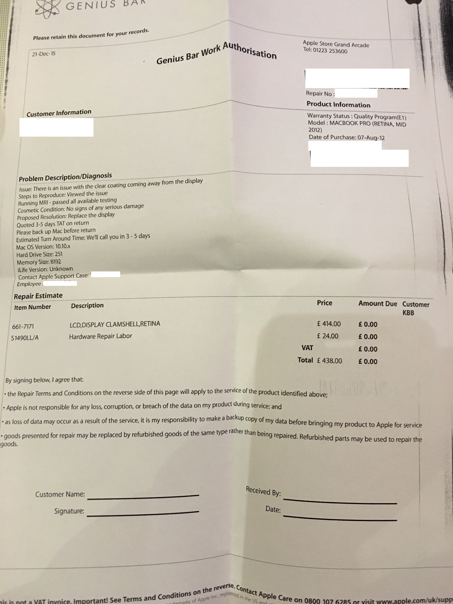

I can confirm that Apple does acknowledge this - see the works authorisation I obtained for my MacBook Pro View attachment 606538
Thank you this is exactly all the info I need. I was concerned that my mid-2012 rMBP wouldn't be covered, but you have the same model. Also the info about the GSX number will be helpful should I get any pushback.

I'm reporting that I just got my screen replaced for free, even if the damage was not nearly as bad as the picture in the article.
Late 2013 MPB 15", very satisfied 🙂
