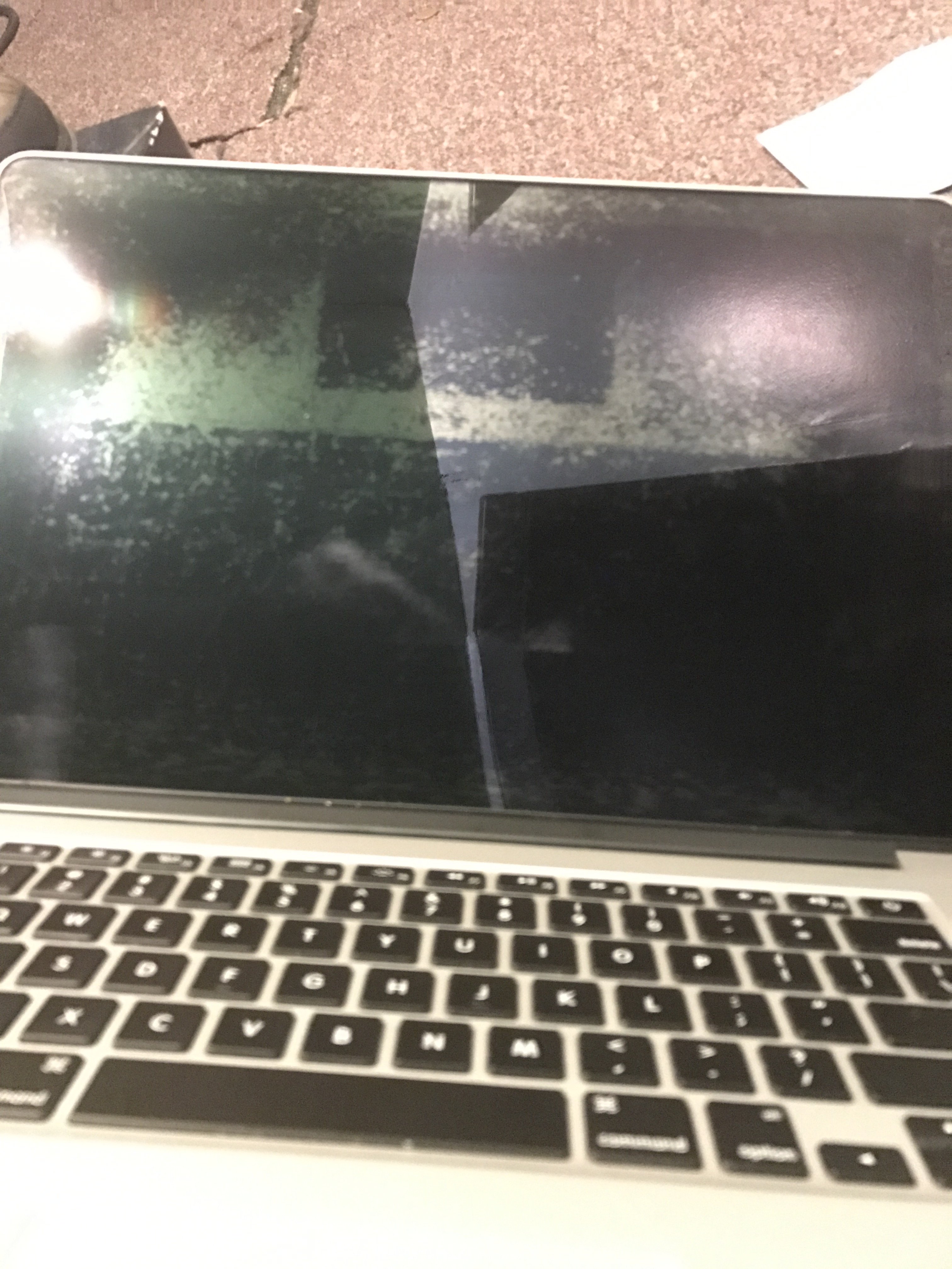

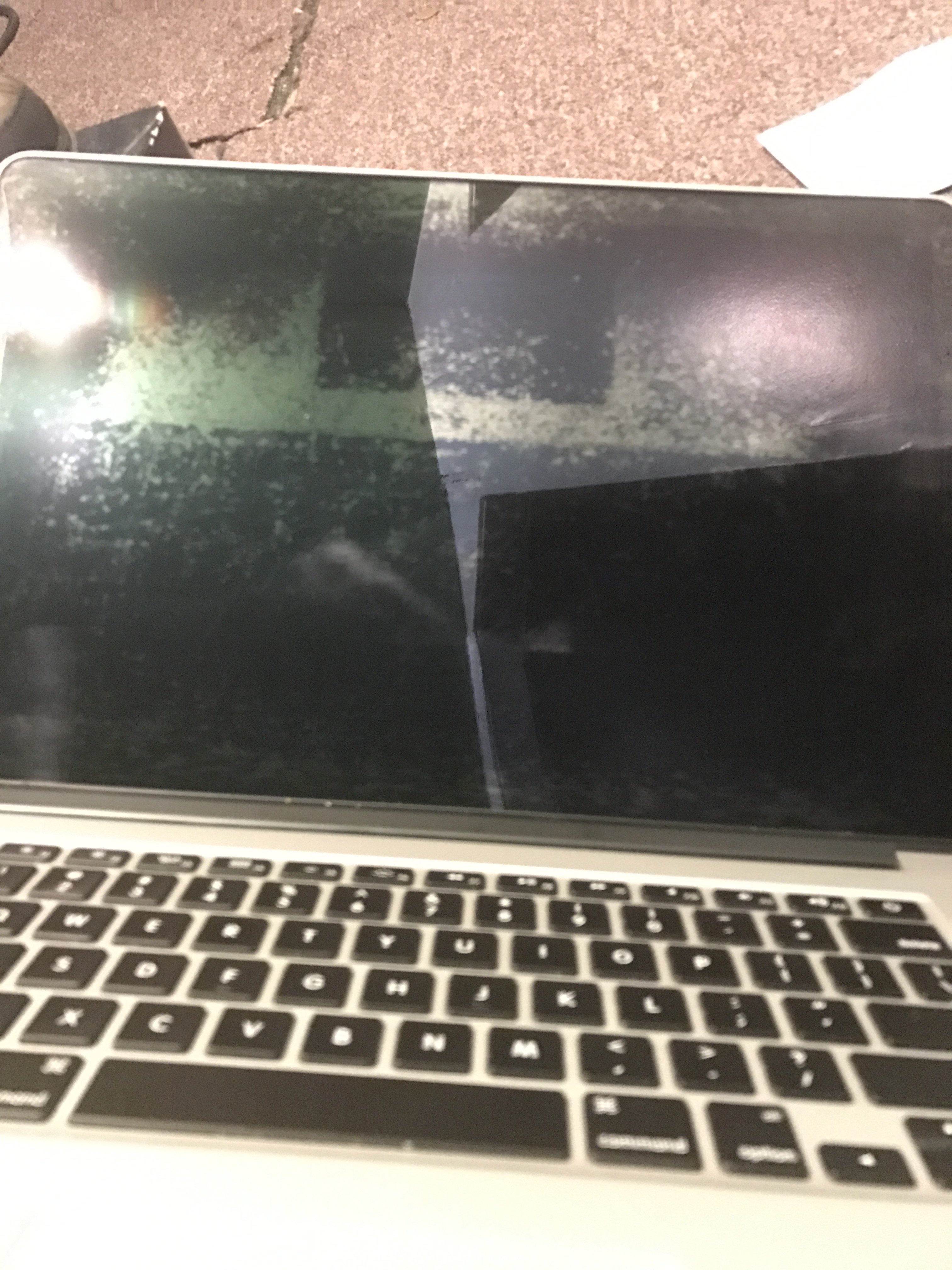

i purchased a computer late 2013 15 inch retina from craigslist that has this issue.... do you guys think apple will repair it or just count my loses ? my other retina units are mid 2014 and they dont have this issue. has anyone had the danburt ct store repair their computer for staingate?

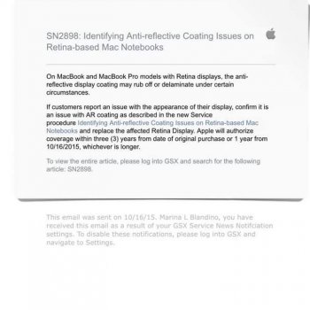

Depends on when it was originally bought. They do replace them (well "should") if it is the anti-reflective coating issue (yours look "typical", should qualify) within 3 years from purchase. Print out the image below and show it to an authorized Apple repair center. Even if you don't have the original receipt I guess they can somehow find out when it was purchased.

THANK YOU !!!
[doublepost=1483517585][/doublepost]im going to see friday when im off
http://appleinsider.com/articles/15...s-quality-program-for-retina-macbook-coatings

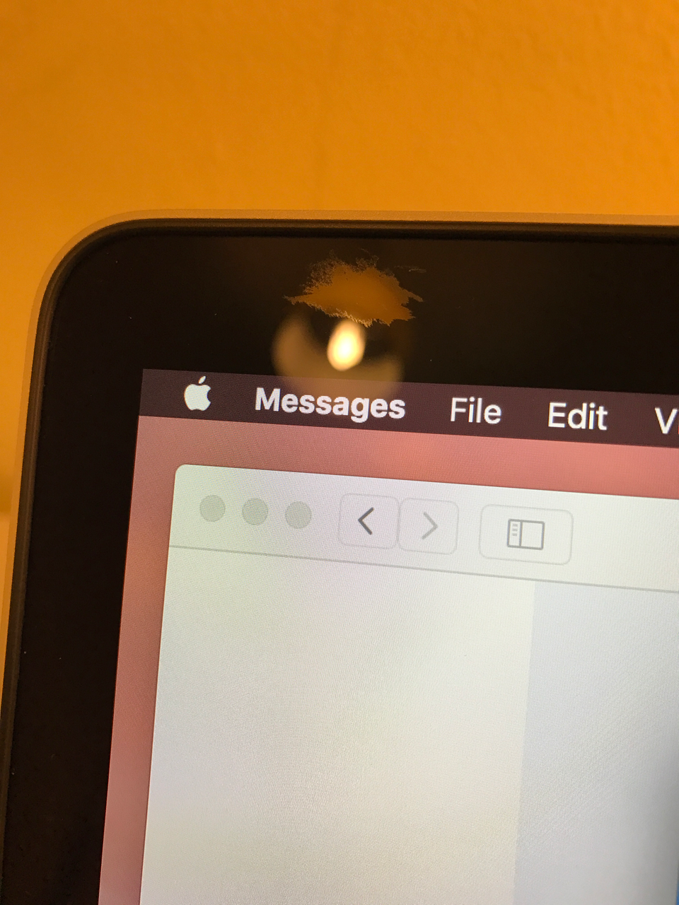

Noticed a very small area on the black bezel of my mid-2015 MBP that looks like this issue. It's very small but it's extremely annoying. Do you think Apple with entertain a replacement for such a small area? My worry is it will only get worse and I'd rather not wait for that. I have Apple Care until July 2018.

I would take it in and see. Can't see a reason why Apple wouldn't replace the display even though it's only on the bezel. I took my sisters mid 2014 in for this problem and it was only on the bezel and they replaced the display no problem.

Hopefully. It's not very big so my worry is they may not see it as an issue. I'm not sure how they assess the issue.
Actually I just gently rubbed it and now it's doubled in size, so it's clearly coming away very easily now and won't be long before it's massive.
Booked in to Genius Bar on Tuesday.

It depends if the store has the display for your model in stock. I was told 3 - 5 business days for the repair and then got a phone call on the afternoon of the same day I took the macbook in for the genius bar appointment saying it was fixed and ready for pick up.

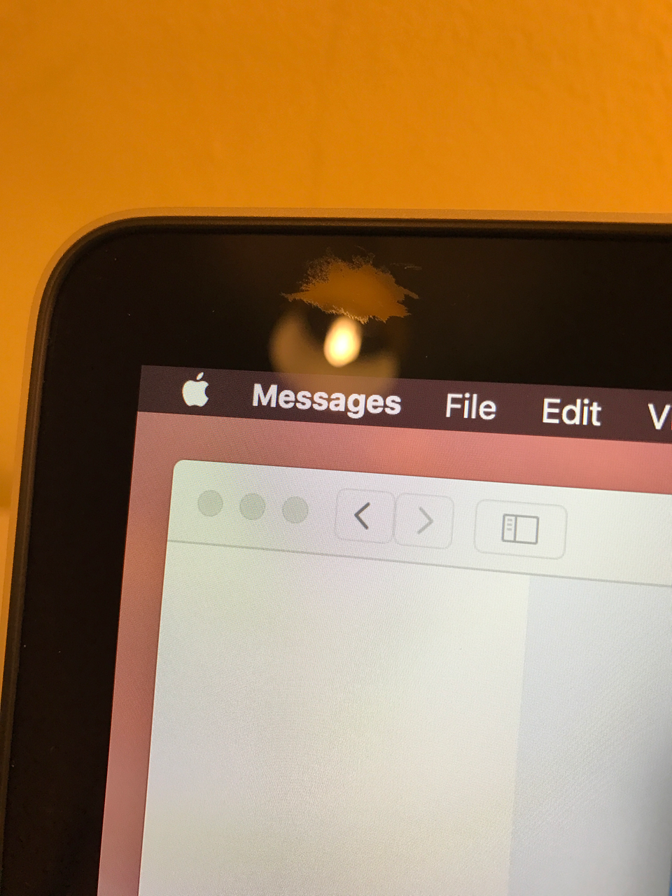

Took a photo of this little beauty... hope they replace it no questions.

Update. Had my appointment with Apple Genius at 12:50 today. Within 40 seconds they had booked my MBP in for a screen replacement, which will be complete in 2 hours. Fantastic result!
The cost otherwise would have been £588. Ouch.

Yes. Mine was small (see pic above)
