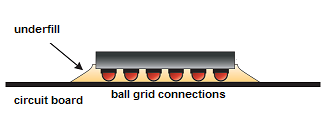

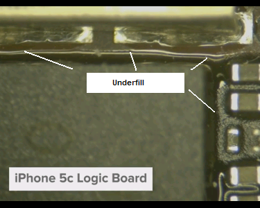

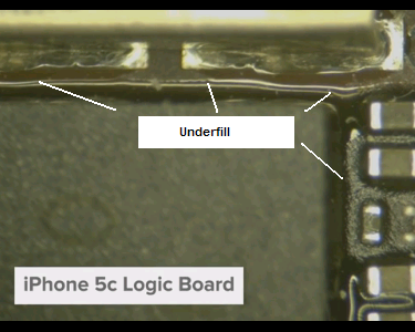

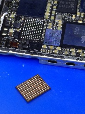

Yep. Here's what happens. Many of today's chips have so many connectors, that they're placed underneath in what's known as a BGA (ball grid array). Here is the touch controller desoldered from its pad on the board:
Now, normally to prevent the balls from coming loose because of circuit board flex, thermal expansion, etc... a polymer called "underfill" is injected underneath.
This stabilizes the connection points.

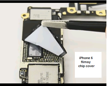

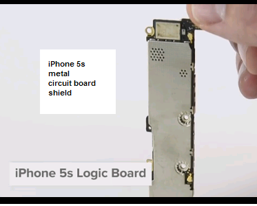

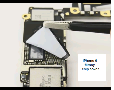

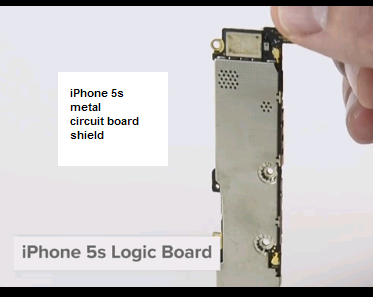

In addition, in previous iPhones, there was a full metal shield that helped make the board more rigid:
But in the iPhone 6, BOTH the full shield AND the underfill were designed out
Those board design decisions, along with a comparatively weak case with a mechanical brace design mistake (Bendgate), allow the board to flex and the BGA solder joints to separate over time.
It's probably not even a question of IF it will happen, but more of WHEN it will happen. Thermal expansion alone could cause it sooner or later, much less any natural flexing during normal use.

I doubt it, the issue is caused by pressure being applied on the chip located underneath the Touch ID button. The flexing and twisting issues are always up at the top of the phone by the volume buttons.
It sounds like apple is claiming the shock of dropping the phone can weaken the bga solder joints. I'd expect that they'd know the limits from shock testing - which should drop a phone way more than anyone would in daily use. Besides, we can't guarantee our phones have never been dropped due to shipping! Vibration from cars also counts lol.
Usually bga failure comes from bad metallurgy or too much board flexing I suppose. Constantly being pushed down on could totally do it!
