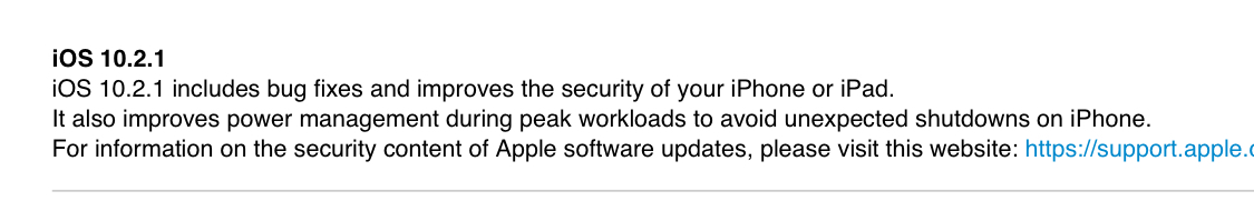

Maybe you should read the upgrade notices if you want to know so badly. https://support.apple.com/kb/DL1893?locale=en_US
Clear as mud that supposed notice was. But it’s similar to the “bug” reasoning, when they were intentionally letting a certificate expire, disabling FaceTime, to save money. Fine let it expire for cost saving reasons but be honest with people please. Had someone known their slow phone can be fixed by reversal of that update or a new battery, how many people would have forgone an upgrade? Many people, and Apple knew that, hence why they were as clear as mud 😉.

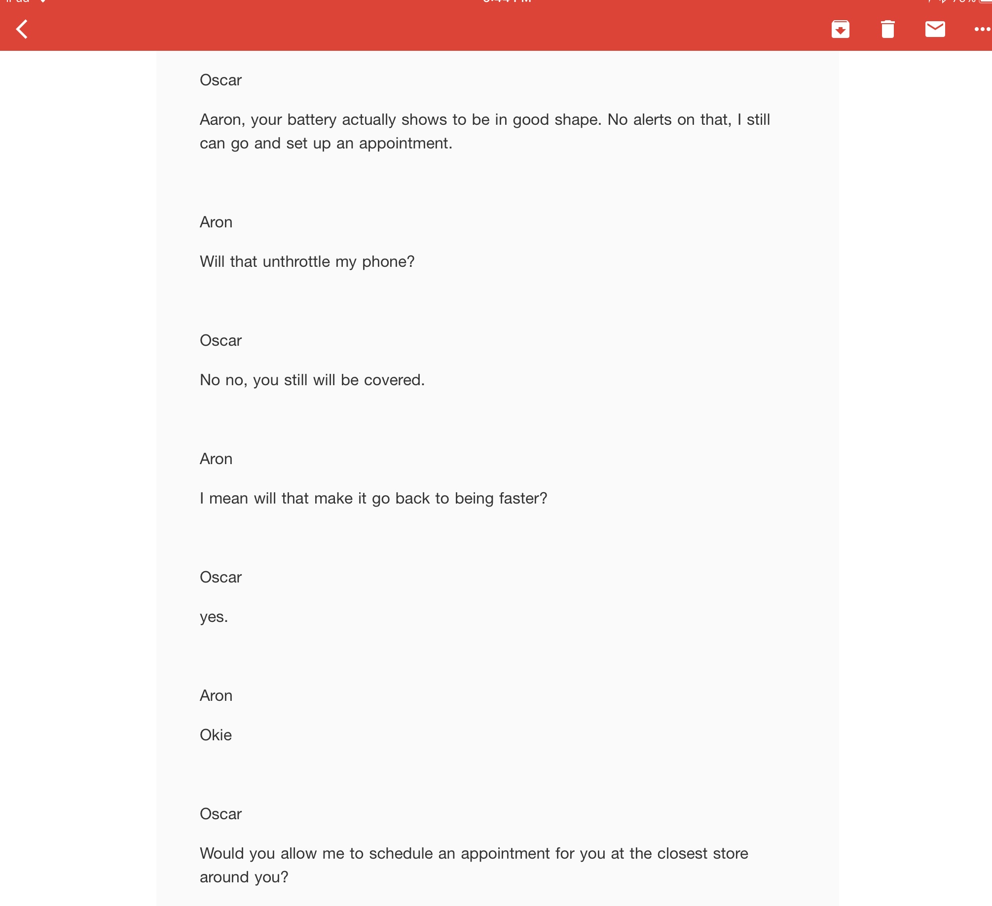

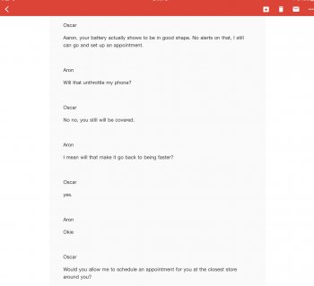

Wanted to give a heads up of my experience. I just attempted to schedule a battery replacement for my iPhoneSE and the support guy said the SE was not covered and I had to remind him that it’s newer than the 6. He then corrected his mistake and he had me run the diagnostics app. The results of the battery test were fine. Here’s an excerpt from the chat session attached.
He confirmed the battery was fine. I asked if replacing the battery would speed the iPhone up. He said yes. So yeah, basically I have to pay $29 for them to just unthrottle my iPhone.
So disappointed.
