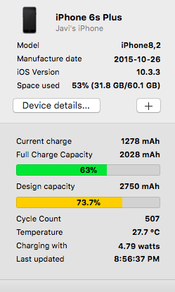

My 6S Plus is covered through AppleCare through February 2018 so I scheduled an appointment at my local Apple Store to have my battery replaced. Through the software coconut, I noticed that the current capacity of the battery is at ~73% when, per Apple, should be at 80% since it has 507 cycle counts.
At the Apple Store they ran the diagnostics and told me the battery was "in an excellent condition", close to 87%.
Could this coconut software be so off/inaccurate or Apple BS-ing me to avoid replacing the battery for free?
I don't know if I should try again or just let it be.
i would try again. i had what turned out to be a software problem that was draining my battery in just hours' time, but i went to the store thinking my iPhone 6 battery was bad. they ran the same diagnostic and told me the battery was fine and sent me home. i ended up wiping and restoring the phone and isolated the app that was causing the problem.
a few months later i noticed i'd wake up to a fully charged phone, but after 20 mins of twitter my battery would be at 80-85%. so i went back to the store and complained. the genius tried to shine me on again, but i told him, look, the last time it was software and it was clear that the phone was hot and just running full tilt. but here, it's just normal usage wearing the battery so fast. he went in the back to talk to a repair tech and came back saying that because the battery had 700+ cycles on it that it would be reasonable to try replacing it.
so you might try waiting a while and going back to the store and see what happens.
I have seen Apple's diagnostics pass on absolutely ****** battery. I had a 3 year old 5S, no one was using it but I never sold and then it basically just lied in my drawer for a long time, used iBackupbot AND coconut battery to know the battery percentage and got the same 73% @ 390 cycles. Apple says battery is healthy, I say BS. 2 softwares on two different computers gave the me same number ie 390 @ 73% and Apple says it's healthy, yeah right.
My suggestion is to keep talking to them. Tell them your phone restarts and the battery life sucks. That should do the trick, keep doing it til they do something about it.
Coconut is inaccurate.
