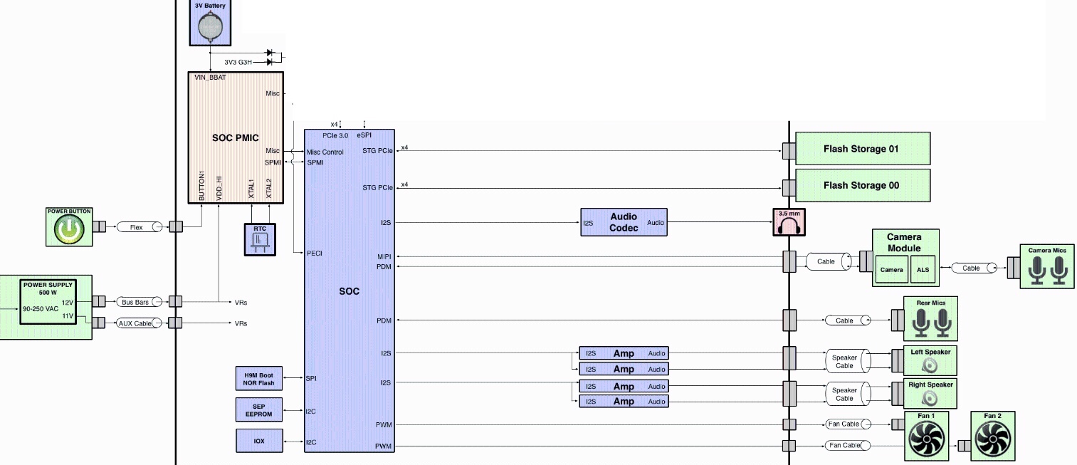

Looking at a block diagram of the iMac Pro south of the PCH it seemed to me apparent that the T2 could easily be an A10 SoC, with some Intel-specific glue added to the the actual A10. Or perhaps it’s just based on the A10, with many chunks re-used, but designed specifically for T2.
Anyway, as I have only a rudimentary understanding of the subject, I’d be interested in hearing from an actual semiconductor design engineer/CPU architect, in his copious free time :)
