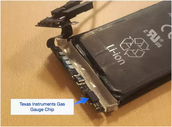

Does that battery have the ability to report the number of cycles on it? If not it is the same problem. The battery health is determined based on several factors, including current cycle count. If the phone does not know the cycle count on the replacement battery, it cannot accurately assess the health of that battery.
As stated in the article and release, the phone will work perfectly fine. The only effect is that the health status reporting function will be disabled as Apple is not able to properly assess battery health. Seems like a reasonable approach to me. Rather than reporting potentially false data, do not report anything.
Of course the battery can report its health. The entire health reporting and life cycle info is stored on the battery pack. This info isn't stored on the phone.
Ah, I didn't realize that. So it has been confirmed that this chip is responsible for battery health monitoring? Or is that just speculation from those who are upset at this functionality? I am genuinely asking.
As I said, this seems like a reasonable move on Apple's part. The overall functionality of the phone is completely unaffected save for the battery health status that Apple cannot confirm. If that chip does perform the health status functions, what is to stop a lesser quality battery manufacturer from replicating it and fooling the phone? Again, if one errs on the side of caution, you do not report data unless it is verified to be accurate.
It's been confirmed. In the past, non-OEM battery packs that use a non-TI chip cannot report battery health. But non-OEM battery packs that have the TI chip could report health.
With this recent iOS update, OEM and non-OEM packs with the TI chip no longer report health.

And again, it is still a more conservative approach to disable the battery health functions unless the data can be verified. I expect that the aftermarket batteries also have a version or clone of this chip in order for the phone to accept them. Relying on that alone would be no different than not having this function/warning at all.
