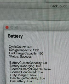

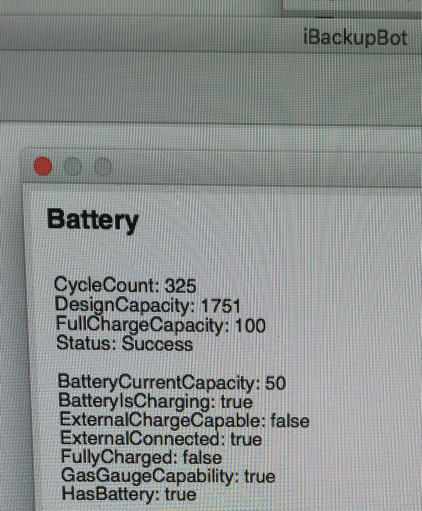

My 6 battery was dying after 325 cycles....although showing a full charge it was in fact only 100mah
Had new battery fitted in a local iPatch bar...15 minutes...easier than booking in to Apple...9 days for a genius appointment and 3 days away!!

I think this is a issue with battery calibration rather than the battery itself. I had the same issue and there were no red flags when I brought to the Apple Store.
No, the voltage physically drops on the battery it has nothing to do with calibration. The voltage drops to as low as 3V (and sometimes even less) which should never happen with normal use. I recorded it happening using a battery app to force them to replace my 6s (before they started the recall stuff). Whatever "test" or "data" they collect from their diagnostics is worthless and conveniently never shows the battery as being bad. The change in voltage though does not lie and shows the true health of the battery. The batteries and or charge controller system seems to have some sort of major design flaw that carried over from the 6 to the 6s. To me it's either a battery chemistry problem or something where the charging circuitry over charges/discharges it (the circuitry is my guess). The charge level on the phone goes up when it's plugged in because the battery is responding to the higher voltage of the USB and the voltage on it jumps. A good healthy battery should not exhibit this massive of a voltage change when a charge is put on it. It should pull the voltage down and draw more amps which it doesn't.

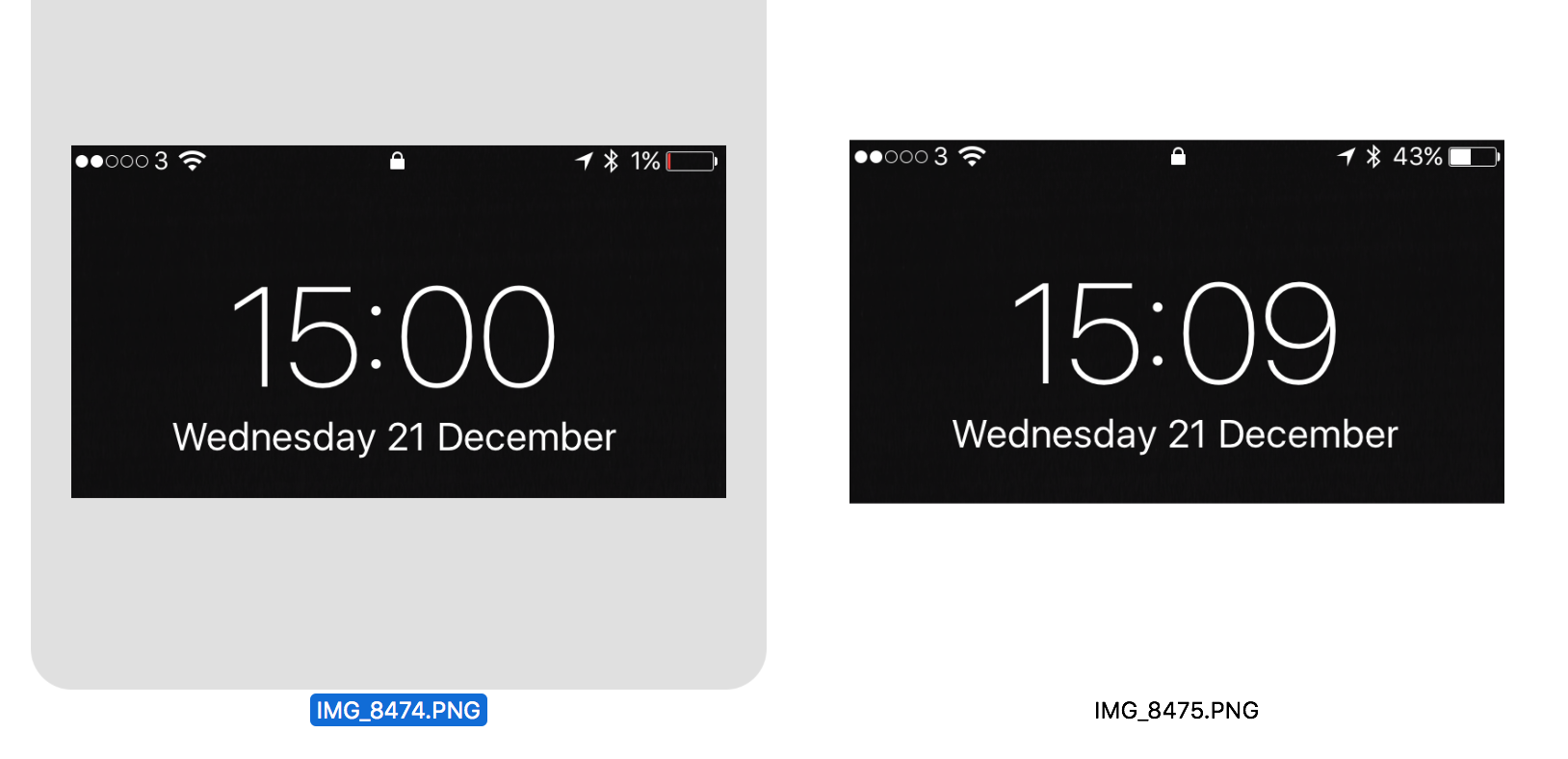

The power management chip is either telling the battery/OS that the battery is flat and just shuts down or something is just really wrong with the phone. So this is my phone running out of juice, turns off from being on 30% to 1% in less than 4 minutes, restarted it when it let me a few minutes later and all of a sudden its on 43%.
