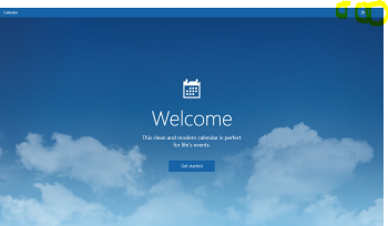

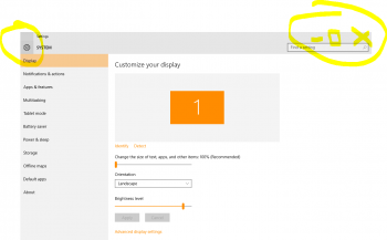

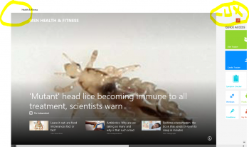

Is anyone else experiencing issues with Windows 10 Metro/Default Apps in terms of icons. For some reason on applications downloaded from the store and default applications like settings, mail, fitness the minimise, maximise, back and close button don't show they DO work for some reason though. It look's like it's just the icons not showing.
I'm on Windows 10 build 10240 (RTM) on a Macbook A1342 (it's the only OS on this laptop). Graphics driver is installed and I don't experience this issue at all on downloaded applications such as chrome/sketchup/autocad etc. Anyone else having this issue/know of a fix.

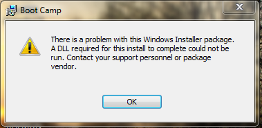

I tried to update BootCamp form link in second page, but once runnig Bootcamp.msi, I am getting
error message saying, that unspecified dll is required for running.
how can I fix this issue?
