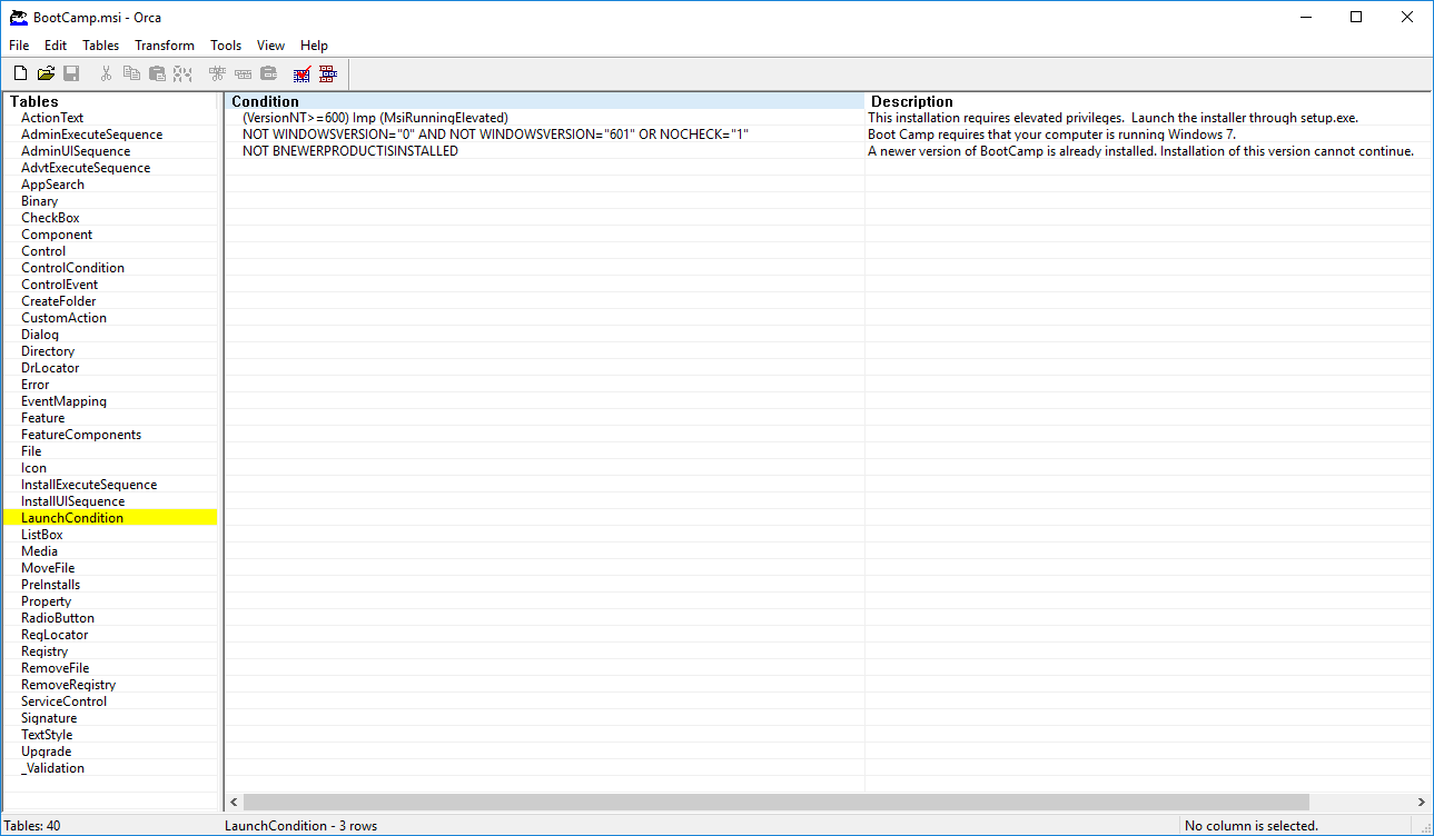

BootCamp 6 worked perfectly on my iMac "Mid 2011" with 256 GB Samsung SSD 840 PRO Series.
1. Installed Windows 10 Pro 64 Bit
2. Edited BootCamp.msi using Orca, deleted the three lines as shown in the screenshot below and saved the .msi file.
2016-03-23_21-34-58-png.622701

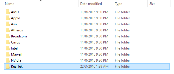

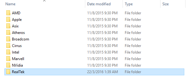

3. I deleted the installation file inside the folder RealTek, it was freezing the installation. However, my iMac is not needed for RealTek driver.
2016-03-23_21-43-31-png.622703

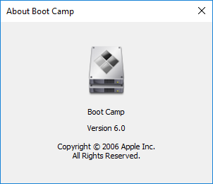

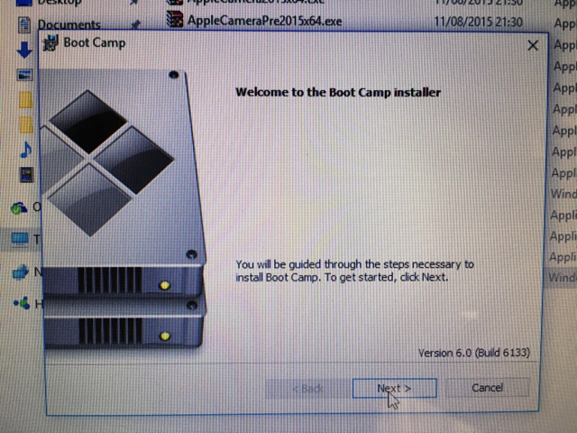

4. Run the BootCamp.msi and installed all the required drivers without a single issue.
2016-03-23_21-33-52-png.622704

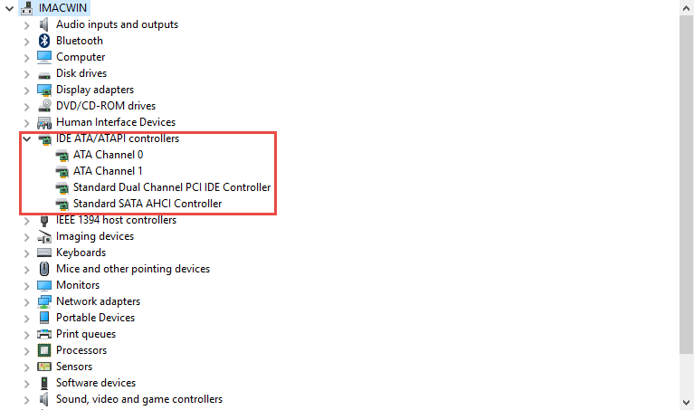

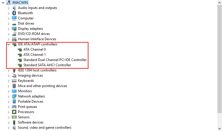

5. SATA AHCI was enabled automatically. I didn't modify anything. Means I am using the full speed of the SSD.
2016-03-23_21-33-26-png.622706

Please help me with this problem when trying to install bootcamp 6
It states i have a newer version installed even though i have version 5 installed
I modified the bootcamp file with Orca
Currently have bootcamp 5 installed. Upgraded from windows 8.1
My biggest concern is that i can't create a restore point.
Macbook pro late 2011

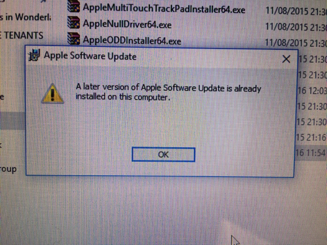

You might need to uninstall "Apple Software Update" on your computer before installing boot camp 6.

I updated to WIN10 on my iMac (Mid 2011) and have the following problems:
- Volume and brightness adjust keys don't work.
- DVD reader don't work too.
I tried to install BootCamp 6 drivers and it don't work:
- When I run "Setup.exe", it appears that "it don't work on this model"
- When I run "BootCam.msi" with the cmd, it appears that "BootCam requires windows 7"
- Und when I modify "BootCamp.msi" with ORCA und then run it with the cmd, an error window appears.
How can I this solve?
I will greatful with any help.
(Sorry for my bad english)
Regarding the boot camp issues of not running review this thread.. There is a link to bootcamp 6.
Volume and other keys won't work unless you successful install BC6 drivers ( and working properly ).
You can't prevent the setup.exe from displaying this error, that is why you must run the bootcamp.msi instead.
