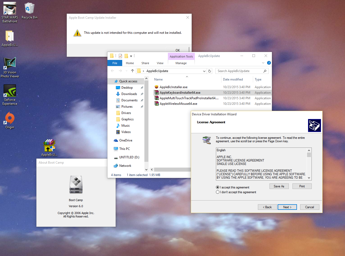

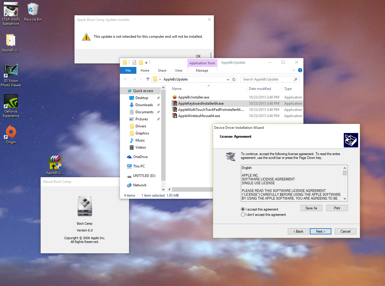

I used my 2014 rMBP to download only the update via Apple Software Update. Sent the file over to my 5,1 and was pissed to see the error "This update is not intended for this computer and will not be installed". Extracted the contents of the exe with 7-zip and sure enough there sat the driver updates for the three devices. Ran each individually and now have full support of the new devices on my 5,1 (basically added normal trackpad support and brightness/volume back to keyboard). All working flawlessly via Bluetooth 4 on my 5,1.
Preface: I had already upgraded to BC 6, but I'm sure I didn't need to once I grabbed the keyboard installer. If there is a big demand for these drivers I'd be happy to post them somewhere.
Thanks for this. Funnily enough I'd done the exact same thing with great results.
I see from your screenshot that you have an NVIDIA card in your cMP. Can I ask what model card it is? And are you running Windows 10 in UEFI or Legacy BIOS mode? START--> RUN -->msinfo32 (this will show you under the BIOS MODE heading)
