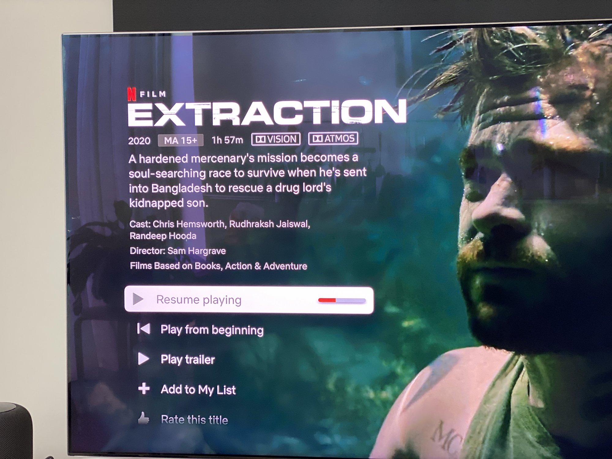

I set the homepods to the default output to Apple TV etc and couldn’t see the Atmos option in Netflix. I closed the Netflix app and opened it again and now can see atmos listed with the title. Not sure if it’s outputting in atmos though 🤷🏻‍♂️
edit. Before it said 5.1 whereas now it says atmos.

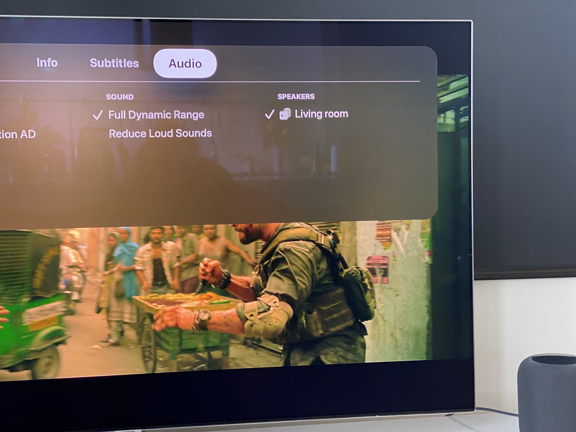

Same here. Seeing Dolby Atmos in Netflix. Although curiously after coming back to the TV and waking up the Apple TV the Immersive Audio settings I saw were gone...

I can be almost certain it isn’t my TV - as before completely resetting the HomePods, I saw the Immersive Audio settings when my TV was the default device, but when I switched to the HomePod pair, it did not (and showed only Auto, not Auto, Dolby Atmos Available in the A/V summary screen). Once they were reset, re-paired, and set as default again, the option appeared. Furthermore, this wasn’t an option at all with the 14.2 beta I tested.
I removed the beta earlier from the HomePods and reset and repaired and updated to the release of 14.2. It doesn’t show anything for immersive audio, and in apples description they talk about enjoying stereo, surround sound and Dolby atmos.
So, I’m pretty sure you are seeing what you’re seeing because of the TV. In theory, if you have the HomePods able to process the new sound stuff you should be able to select surround sound separately to just atmos and also just stereo too. Do you see those options?
Yeh strange. I put mine to sleep and turned it back on and Atmos on Netflix still shows, but there is no immersive audio option, if that is something that needs to be turned on?
