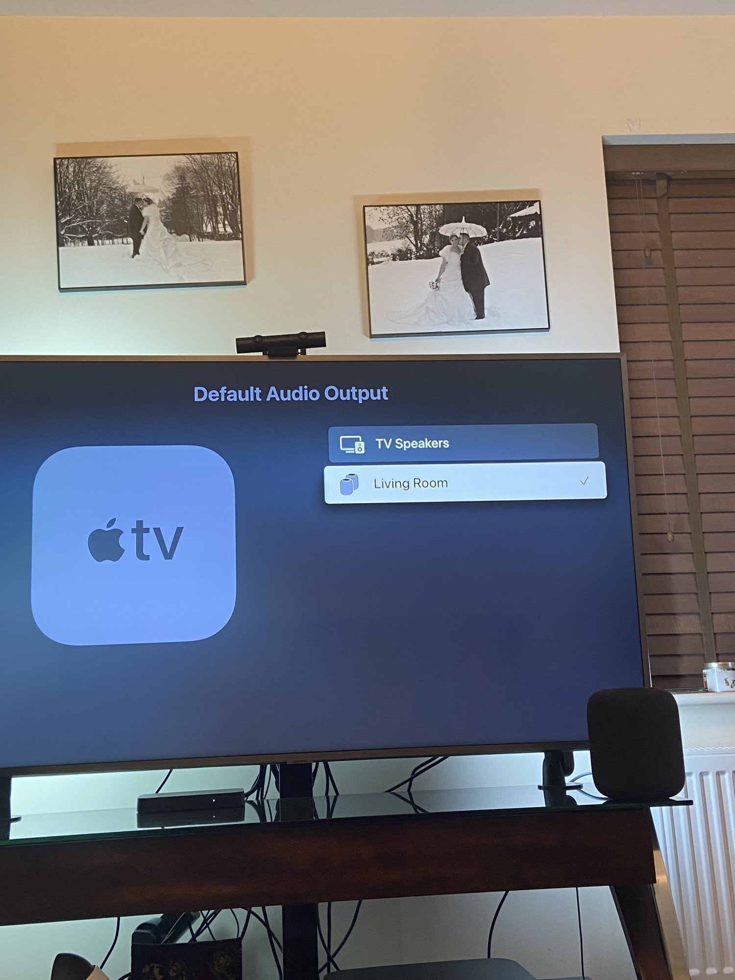

Try this. Go to the Home app on your Iphone. Your Apple TV should appear there, along with your Homepods. Click on the Apple TV card and in the menu that will pop up you should see a default audio toggle. Select the Homepods.

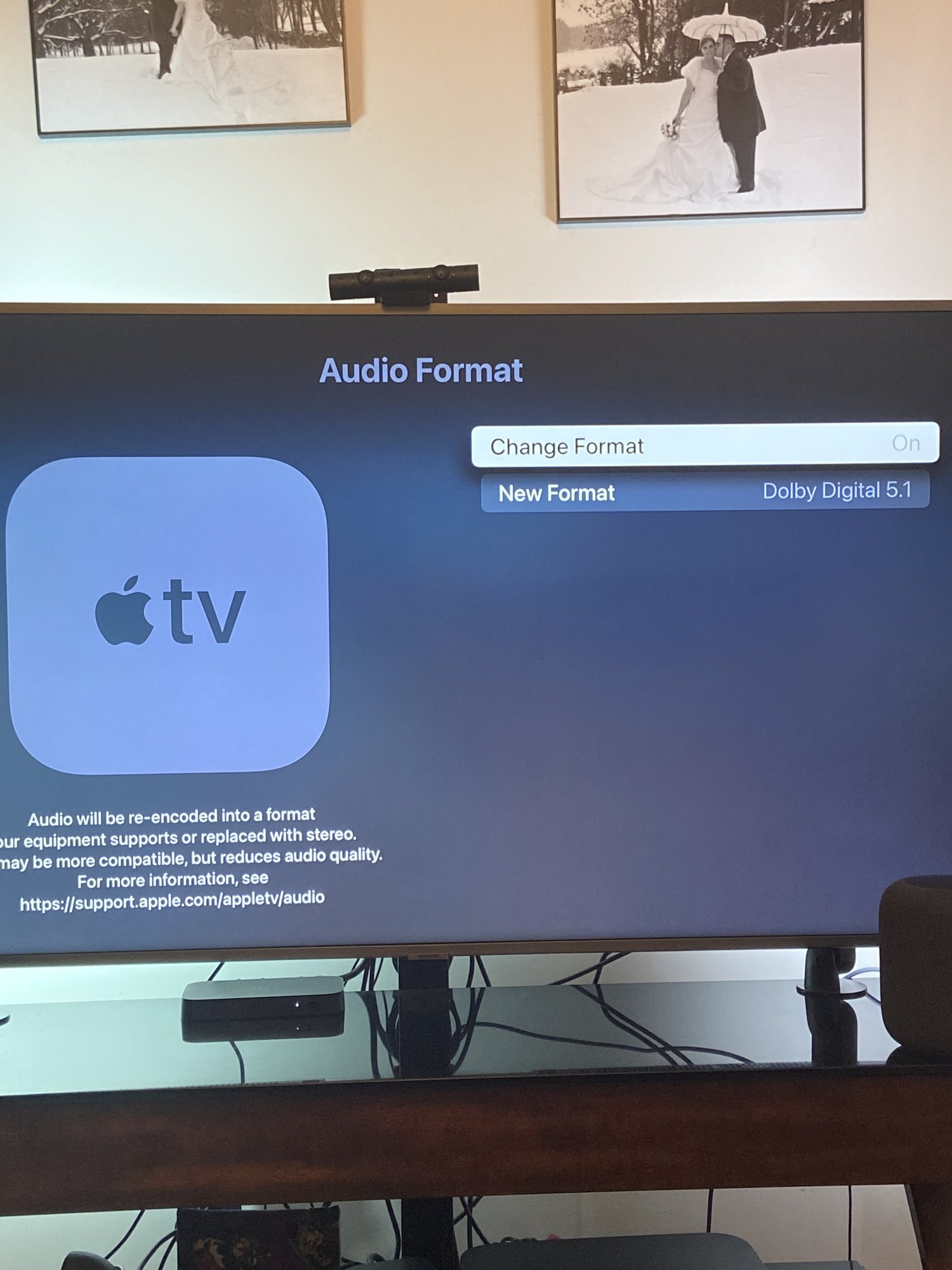

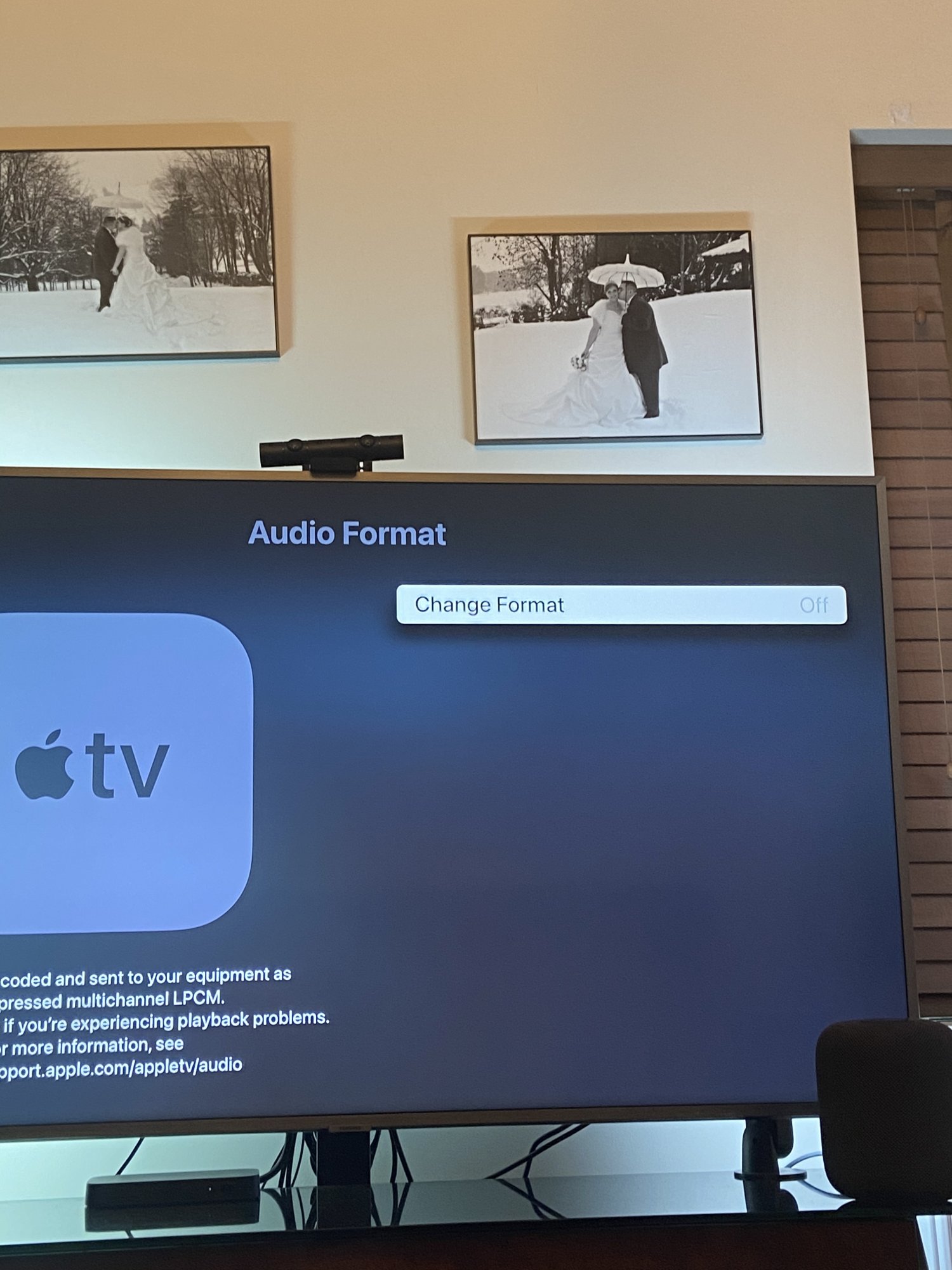

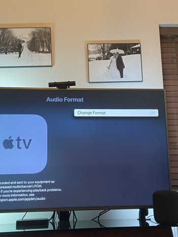

Disable change format. Atmos should now appears, if you have the Homepods set up as the default audio option of the Apple TV.
Definitely set up as default but no immersive anywhere
Doing "B). Make sure that the Homepods and the Apple TV are in the same room (via the Home app) as the Apple TV" makes all the difference if anyone else is having issues with this. My Apple TV was in "Living Room TV" with my Apple TV and the Homekit TV. My HomePods were in "Living Room Audio" with other homekit Audio devices. Created a new "Living Room Entertainment" and dumped them all in it and now the Apple TV sees the HomePods as a Default Audio Source

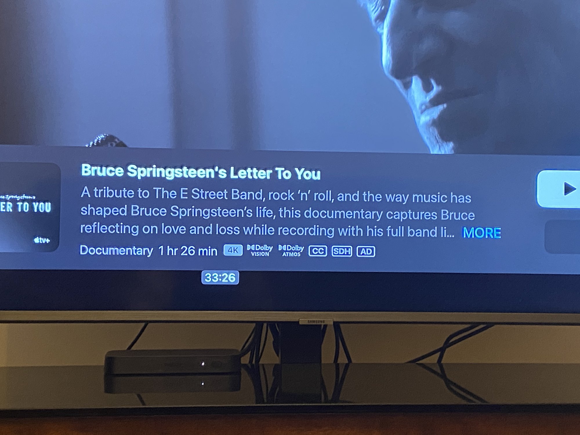

Do your TV set support Atmos?. If you go to an Atmos title on Apple TV+, Disney+, or Netflix?. do you see the Atmos logo?.
My Apple TV does and the homepods are through the Apple TV...however this atmos logo on Bruce Springsteen did not show earlier but is does now
Fantastic! Now the important part... how does it sound to you?.
I´m definitely seeing the Atmos logo in Netflix and Disney. Try force quitting the apps and reopening them.

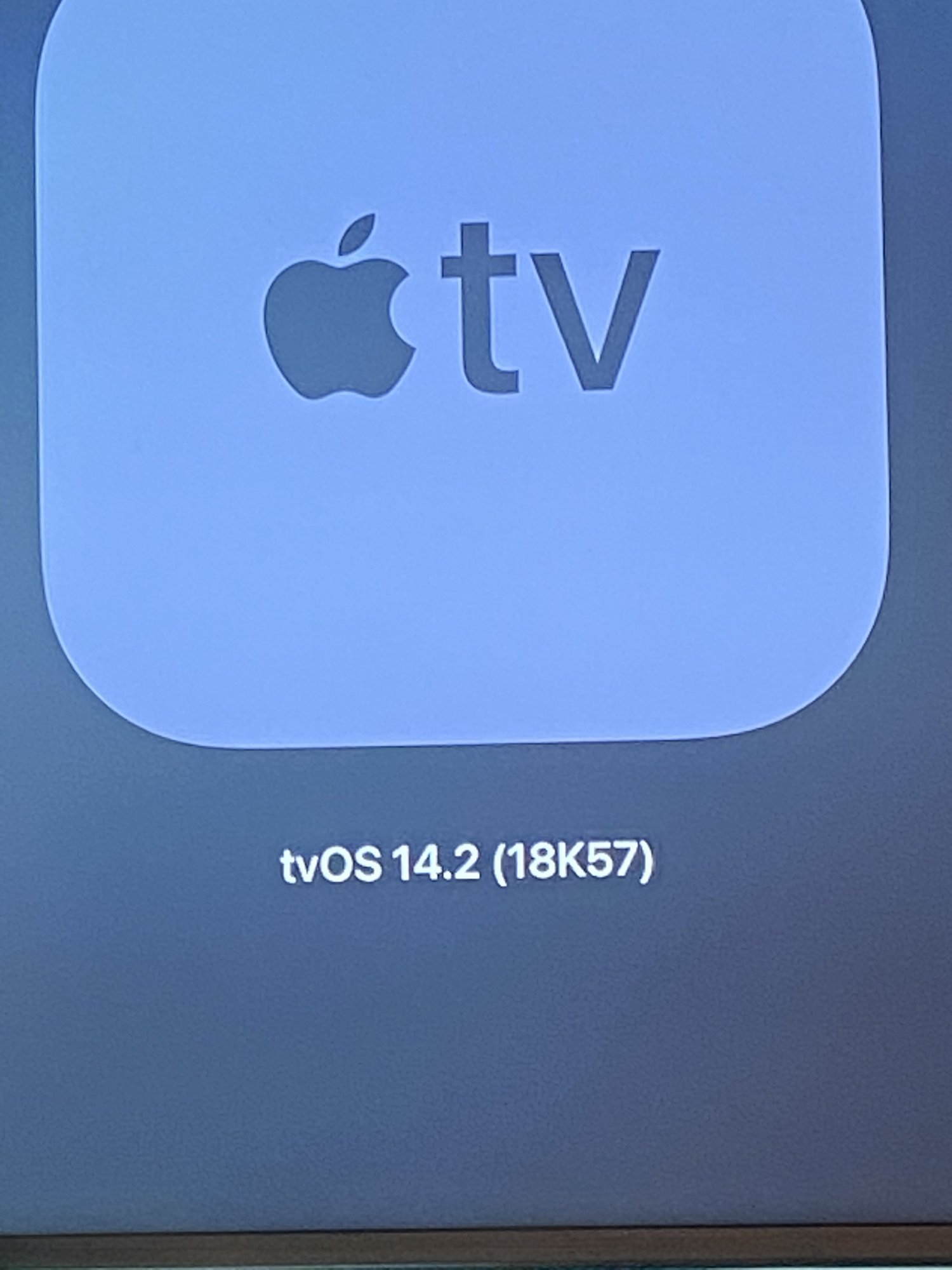

Do the numbers in brackets mean I am on an iOS beta?
