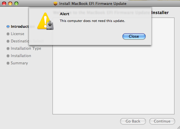

this update doesn't apply to the current generation Penryn-based MBPs. I manually downloaded it and ran it on my 2.4 and it indicated that it did not need the update.

Just downloaded the firmware updater and it says my system doesn't need the update. So some people are getting this major bug fixed while others (like me) have to keep f***ing living with it?!?!

Now working on my MacBook with...
Model Name: MacBook
Model Identifier: MacBook2,1
Processor Name: Intel Core 2 Duo
Processor Speed: 1.83 GHz
Number Of Processors: 1
Total Number Of Cores: 2
L2 Cache: 2 MB
Memory: 2 GB
Bus Speed: 667 MHz
Boot ROM Version: MB21.00A5.B07
SMC Version: 1.13f3
