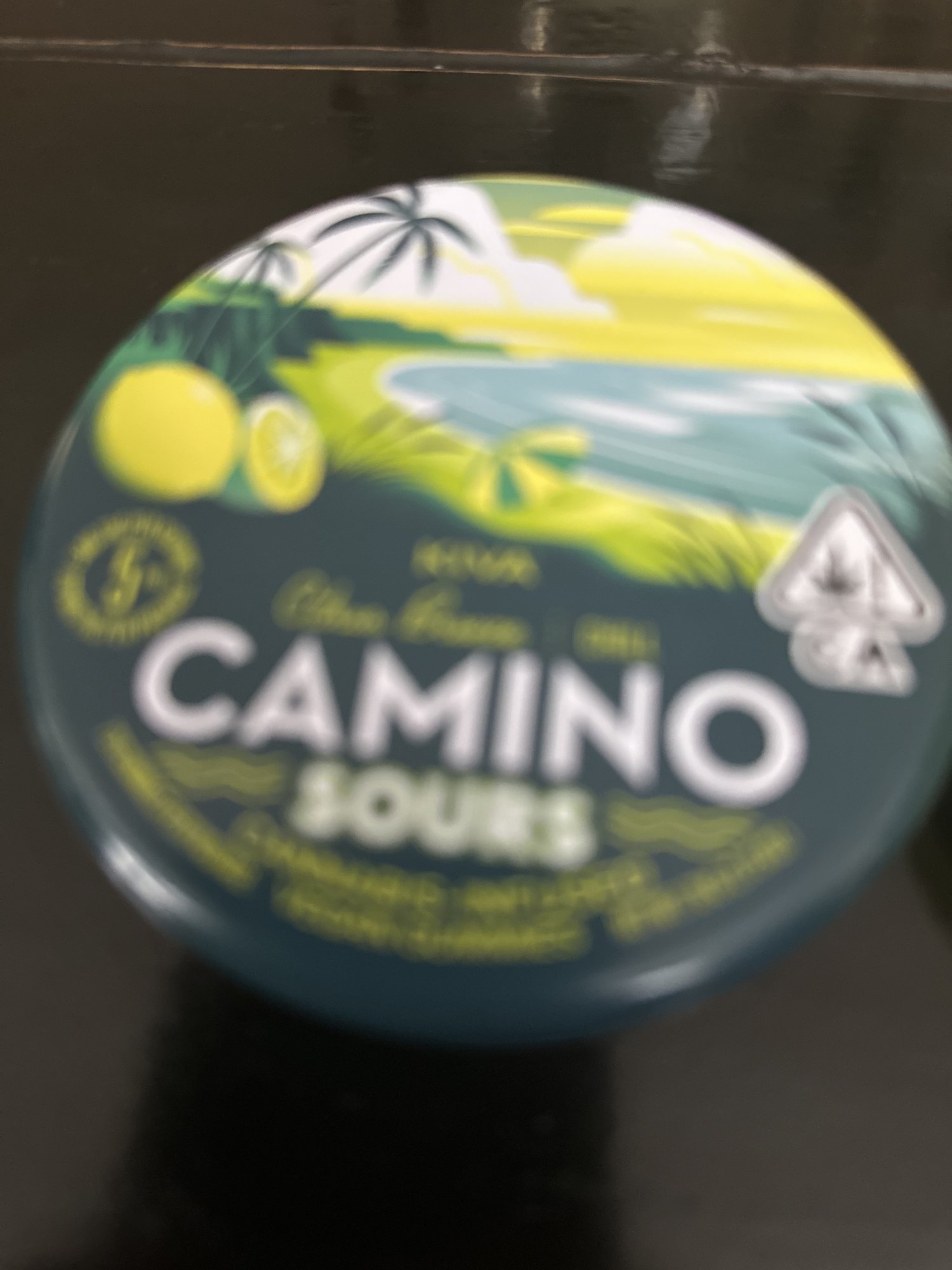

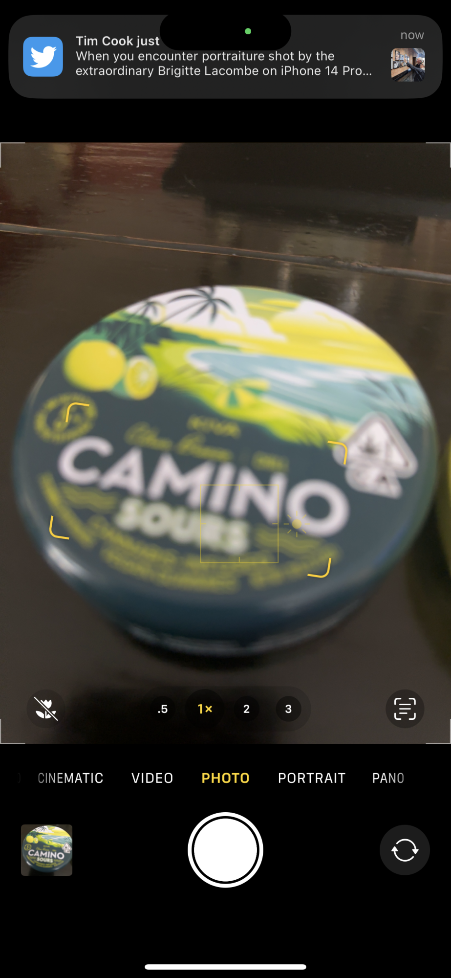

Any photos to show this? I am in SoCal too and have been looking for a replacement to no avail. I only experienced the rattle for a mere 2 seconds on two occasions and my camera appears fine. Update is working flawlessly on my end. However, my OCD has me checking store stock in this 14 day window to get a replacement possibly.
Here you go. Photo and a screenshot of it recognizing the text and also trying to focus manually. I was trying 4-10 inches away, had to get like two feet away for it to come into focus. Then I pointed the phone further out in the room and it refocused but it won’t focus on closer items it seems. Hopefully yours works better than mine. Luke Miani mentioned this permanent damage in his video and it was almost hard for me to believe until now.
You have macro mode off. The flower should be yellow
I wasn’t trying to use macro mode. Sometimes it comes on before you get close enough to make use of it, and presents a worse image than the regular camera does.
Images will always be blurry close up unless you use macro mode tho. Unless you cropped that photo. the focal length of the iPhone 14 is diff. Film a video. Does it rattle or shake. And can you zoom in and it’s good?
I believe the focal point is now around 7 to 8 inches on the 14 Pro Max, rather than 6” on the 13 model. So with macro mode off and being that close up, it’s going to produce an image like that.
The 14 pro max has a different minimum focus distance than previous phone (12PM),
iPhone 14 Pro Max - 200 mm (7.8 in)
iPhone 13 Pro Max - 150 mm (5.9 in)
iPhone 12 Pro Max - 115 mm (4.5 in)
