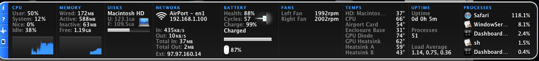

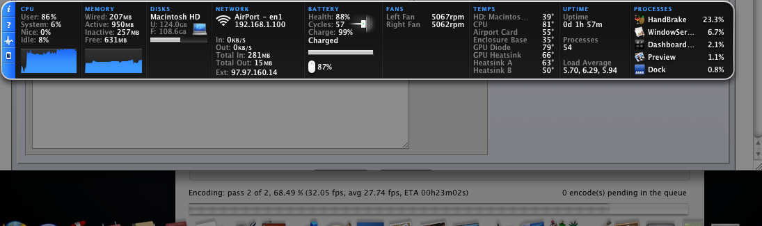

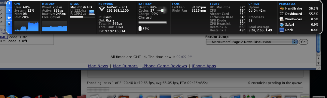

Three pictures.
1) right after watching an HD youtube video for 1 minute
2) right after watching an HD youtube video for 3 minutes (did not get higher)
3) right after watching a regular youtube video for 4 minutes.

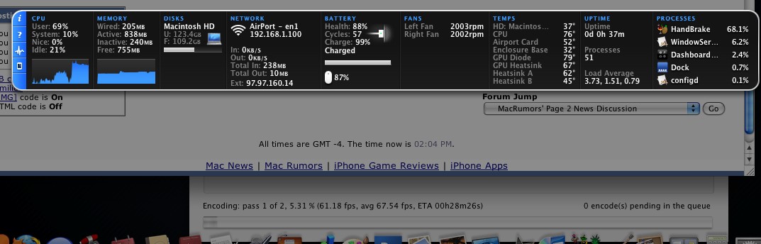

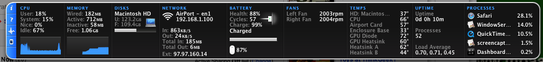

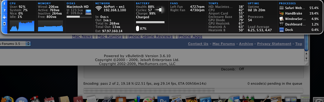

These are with handbreak runninh @ different times.
It is staying noticeably cooler with the fans @ 4500-5500. Maybe it underclocked the GPU?
This is encoding a copy of a DVD that I own. The DVD runs 1:24 minutes. Encoding is set to basic-> Normal. Size is limited to 850mb.
Geekbench has dropped about 100 points since 10.5.7 and this SMC update.
God I hope that's not true. Why would they decrease the power of the GPU? Just because it's potentially faulty?
