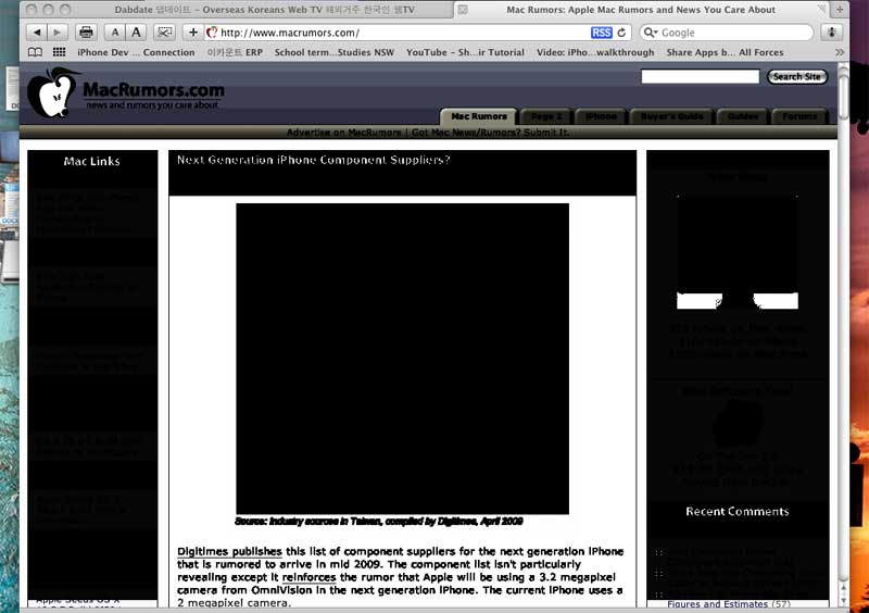

Didn't fix blackening issue...
I was told by they are working on this issue and kind of hoped that this would fix it...
I guess this issue will be dealt by driver update.
