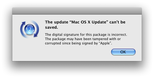

I've tried to install about 10 times now, but I just get this message (about 10% into the download) after it tells me it's going to take 4 hours!!:
http://img4.imageshack.us/img4/668/osx107.jpg

It starts off downloading then freezes and I get the digital signature error...
Same issue here. Trying it over again.

I got around this by downloading the file from the 1st post of the thread. The only issue though, is I got stuck on a blue screen, had to power down hard style, then it self-rebooted 2-3 times after I powered up; now all is well.
Updating through software update didn't work. I am now downloading from the website.

EDIT: Looks like install is going smoothly... I would suggest that people who get the error when using software update download from apples site.
Thanks, download seems to be going smooth from the website.

Did a manual reboot and it worked that time. I had the digital signature error a zillion times for the 200 meg version, so I grabbed the 400 megger from apple.com.
