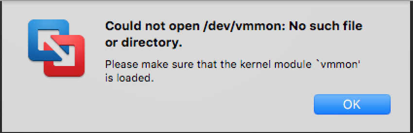

Going to post this as a warning here - on a clean install of High Sierra, VMware Fusion 8.5 (currently 8.5.8) does not work. When launching a VM it throws an error:
Don't know if it is any different with an upgrade over 10.12 to 10.13.
Edit: VMware Tech Preview 2017 can't also start VM's
Edit #2: it works afterall!
During the installation it shows a notification about software from VMWare.inc being blocked and that it can be enabled in System preferences, Security & Privacy.. and indeed, after that there is a button which allows the kernel extension to run. The button disappears afterwards.
Confusing, but... that’s the Apple of today :p
