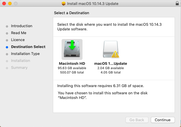

If you have 10.14.2 you can use the 10.14.3 delta instead of the combo from https://support.apple.com/kb/DL1991?viewlocale=en_US&locale=en_US
and that one DOES install:

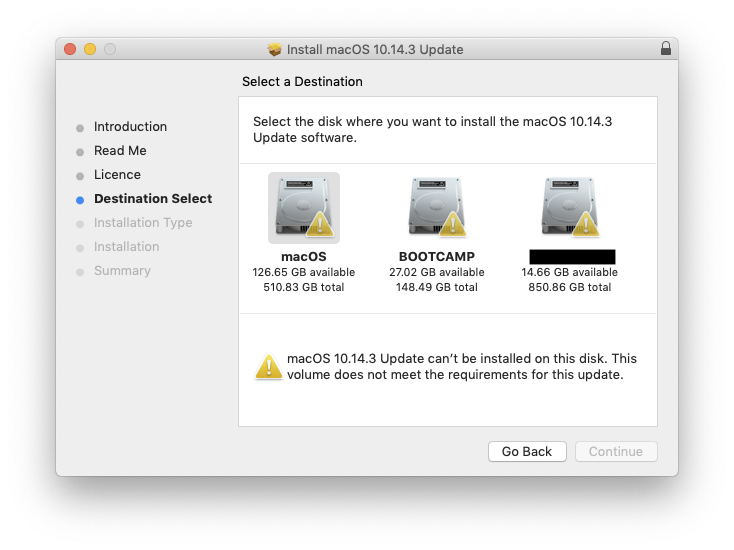

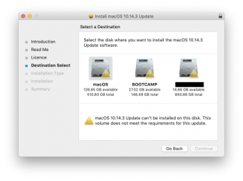

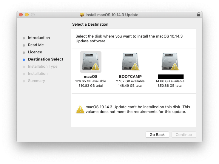

Just downloaded Combo. Denies to install on the only SSD partition I got (labeled macOS on scr.) Says, "macOS 10.14.3 Update can't be installed on this disk. This volume does not meet the requirements for this update"

Have no idea what's wrong with it. Everything was fine with my setup before this very combo.

So I just figured it out. And this makes no sense. You must first do the update from within software update and then you can do the combo. This means there was some sort of security patch in the update from within the software updater. I’ve seen this before.

So I too had the same problem with the Combo. Unpackaged the file and looked at the Distribution file.
The Distribution file does a series of checks to see if your Mac can accept the update,
In the Volume check, it references previous build numbers of Mojave, if your build number is not on the list it stops the install with the error we are seeing.
Guess what, Apple have omitted to include quite a few of the previous build numbers of Mojave, so that is why the Combo
is stalling. If I add the build number for 10.14.2 (18C54) to the array and save the Distribution file and repackage the files
I can now install the Combo.
I had a look at the Distribution file of the Delta update and that has considerably more build numbers in its list, so I wonder if the developers got them mixed up.

Another one who can't update using the 10.14.3 combo updater on my MacBook Pro 13" (late 2016 with USB-C) from 10.14.2.
