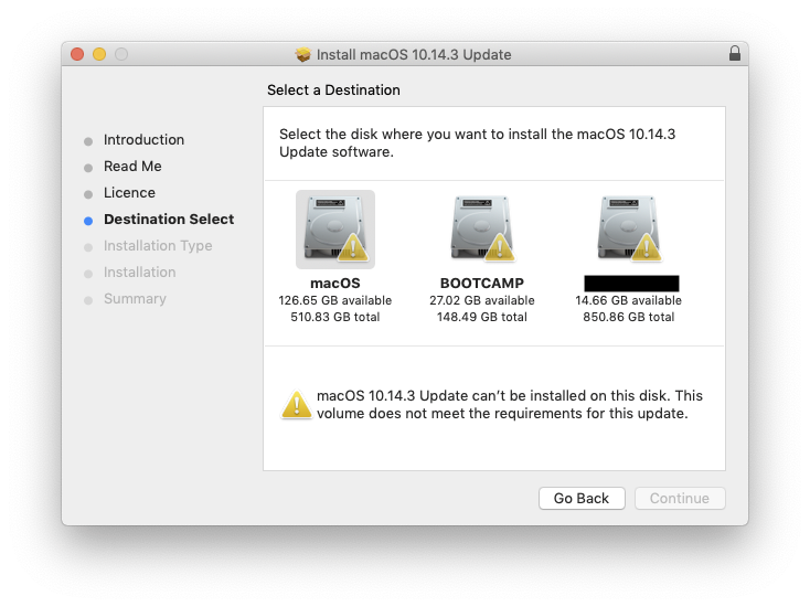

Just downloaded Combo. Denies to install on the only SSD partition I got (labeled macOS on scr.) Says, "macOS 10.14.3 Update can't be installed on this disk. This volume does not meet the requirements for this update"
Have no idea what's wrong with it. Everything was fine with my setup before this very combo.

Good morning i had the same problem on both my mac. So this is what i did ,my drives were formated in mac os extended journaled THATS THE PROBLEM that everybody is getting included me so i copied my drive to another that was formated as apsf problem solved rebooted my mac and installed the 10.14.3 on the new drive worked for both my mac .happy as mac & cheese :apple:🙂
For me, at least, that is not the reason. When trying to install the combo updater on my Mac Pro 4/5,1, all drives are noted as "...can't be installed on this disk." This includes both SSDs formatted to APFS and HDDs formatted as HFS+.
I'll wait for a fix to the combo updater from Apple.
Just install the delta updater. If you really feel it’s necessary, you could download the full 10.14.3 updater from the App Store and use that, or install the combo updater on top of the delta updater. In the vast majority of cases there’s no need for the combo updater at all.
You can still update your Mojave APFS installs using the Delta updates or the 10.14.2 Combo and then the 10.14.3 Delta.
So if you are on 10.14.0 or 10.14.1 use the 10.14.2 Combo and then the 10.14.3 Delta. All can be obtained from here,
https://support.apple.com/downloads/MacOS%20Mojave That said if you are running Mojave on an SSD with APFS you should be able to update directly using Software Update in System Preference.
As for Mojave installs that are on HDs and have the HFS+ file system you cannot use Software Update. For the standalone updates the distribution file needs to be modified in the Volume check section. It's a bit of a faff. The other alternative is to download the full installer via the App Store and do an in place install.
Or, I can wait until Apple releases an Combo update that works. If they can't make it work, why should I try and work around it?
I think a Recovery mode OS reinstall does the same thing as the combo. I did that this am. Only took 45 minutes.

Apple has re-released the combo updater with an updated distribution list of compatible builds -- now includes 18C54 so it will run on 10.14.2.
var buildNumbersArray = '18A384a,18A389,18A391,18A2063,18B45d,18B50c,18B57c,18B67a,18B73a,18B75,18B2084,18B2103,18B2107,18B3094,18C31g,18C38b,18C48a,18C52a,18C54,18D21c,18D32a,18D38a,18D39a,18D42,18D43'.split(',');
Installed fine on iMac Macbook. Subsequent Time Machine backup on the iMac was fast but the Macbook TM backup is huge and taking ages. Hopefully that is a once off.
That last build number 18D43 is interesting.
The new combo seems to be the only way to get build 18D43. It doesn’t show up in the software update pane either if you are already on 18D42.
Those who happened to download the old combo can compare the dates for the two combo packages. There is a 9 day difference between them. Yet the combo page https://support.apple.com/kb/DL1992?viewlocale=en_US&locale=en_US still says January 22, 2019 with no indication whatsoever that it is in fact a new combo with a new build. The new combo actually was released several days AFTER January 22.
Also the full installer is still build 18D42! It is quite rare for a non-beta combo to have a higher build number than the full installer.
I rarely install combos but I installed the new combo over build 18D42 and indeed ended up with build 18D43.
