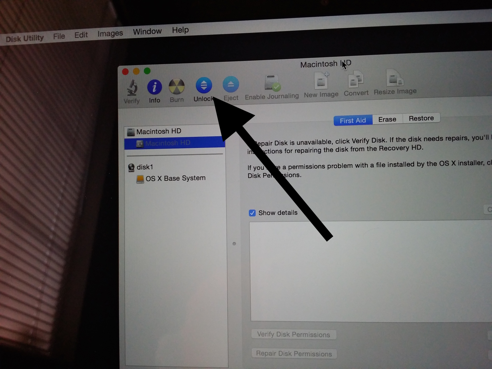

You don't need to. Go to Disk Utility and unlock your disk first, then go to Verify/Repair.
Make sure you mount/unlock your encrypted file vault disk first or else you can't do anything.
Then repair disk although there was nothing wrong with mine, however. I just selected the STARTUP DISK and then rebooted and it worked fine. I am not about to restore or reformat! Apple sucks these days with updates and fixes. Just terrible! I know what I'm doing but imagine the typical apple laptop consumer. A trip to the apple store!
I had the exact same problem! I tried selecting the start up disk in recovery as well, but that didn't work for me. I tried to repair the disk, and it reported it was fine. I'm now forced to reformat.
I repair permissions first, then repair disk and then selected the startup disk which showed up with 10.10.3 and it worked for me. I was not about to reformat! Apple really is terrible.

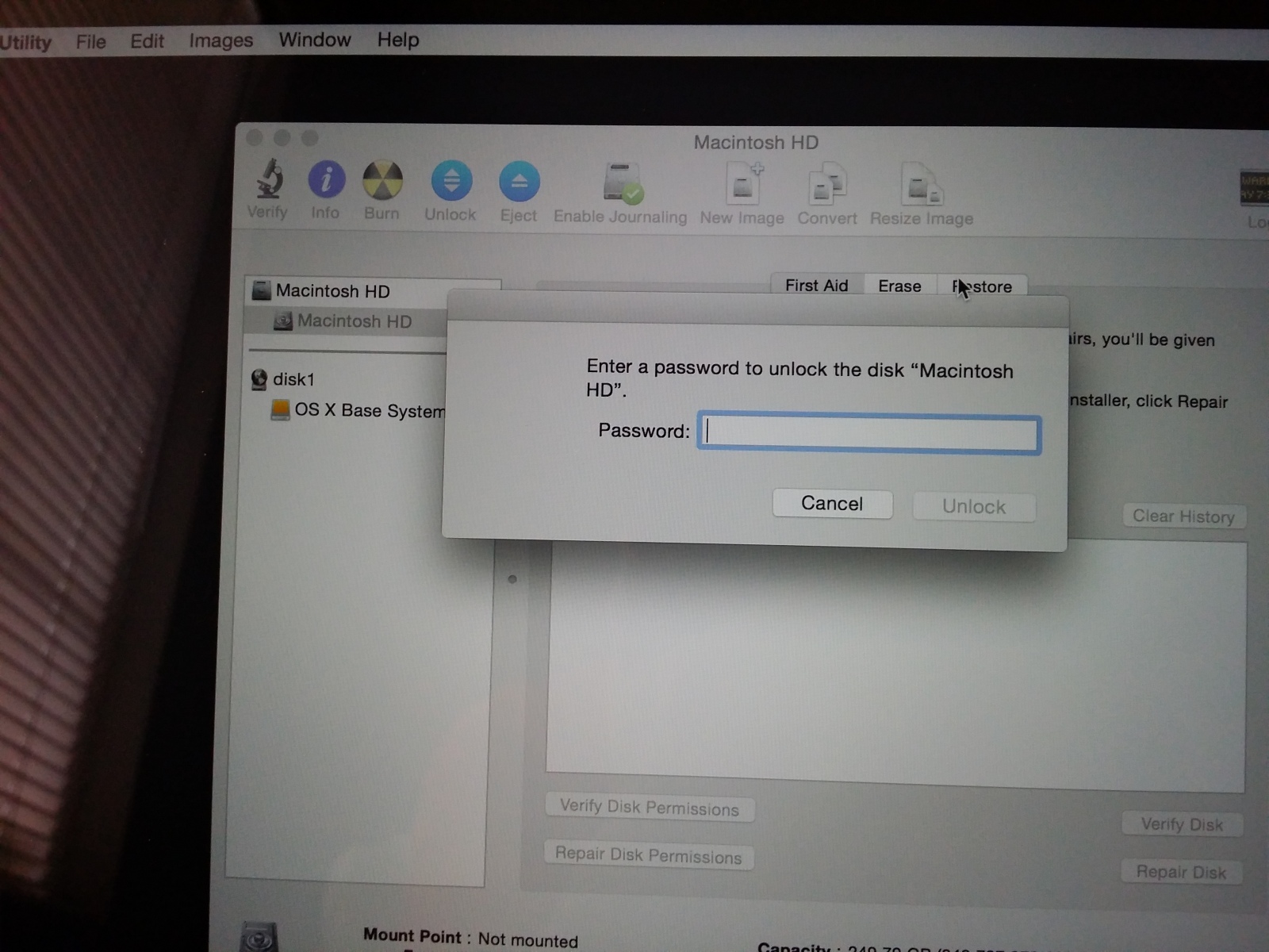

You can't unlock a disk that is encrypted with FireVault 2 from recovery. At least not to my knowledge.
NO you can! You select the whiteout/greyed out disk icon - then on top inside disk utility you can choose UNLOCK.

Installed the 10.10.3 update via app store on my 2015 broad well 13" and waited for system to do it's thing. It finished then I started and see the white loading bar then it another restart and nothing - a blinking folder with question mark.
Zapped PRam didn't do jack, so booted into recovery mode via command-R while powering on and selected startup disk and it worked.

Turn off Mac, power on and keep pressed alt button and select your HD.
I'm not a new user. Been using Apple products and OS X since 2005. However for me i didn't see a option for this. I checked for repairs on the entire hard drive. It reported back fine. The disk where my files were however I couldn't access.
Wish I had knew this before. It's a little too late now. I only have a few minutes left of reinstall.
You can just quit disk utility and in the apple logo menu, click on select startup disk. Select the 10.10.3 partition and it will reboot properly.
