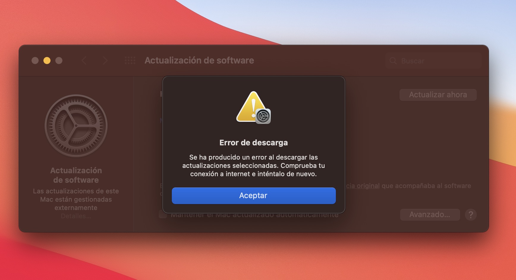

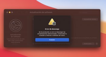

Typing "softwareupdate --install 'macOS Big Sur Beta 2-20A4300b'" into terminal gave me the following message:
Failed to download & prepare update: Error Domain=SUMacControllerError Code=7722 "[SUMacControllerErrorPreflightPrerequisiteCheckFailed=7722] Failed to perform PreflightPrerequisite operation: com.apple.MobileSoftwareUpdate.preflight.error(Preflight):MSUPreflightErrorTargetIsNotSnapshotBooted(6) | The volume can not be used because it is not snapshot booted
Try this from Azezal: #182
It worked for me and I had the same issue.

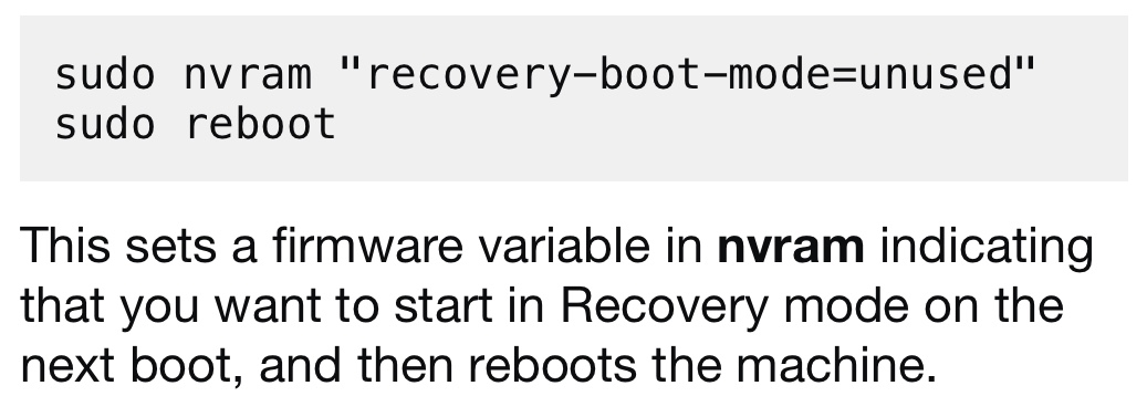

I am getting this error in Terminal:
nvram: Error getting variable - 'sudo': (iokit/common) data was not found
I am trying to force the iMac Pro boot into Recovery Mode via terminal...
I didn't get the same error, but it could be that I'm already on beta 2. Can either try copy/pasting or typing it yourself. Alternatively you can try booting into recovery by restarting then holding CMD+R immediately after you hear the startup chime or see the boot logo.
Thanks will try the traditional way!

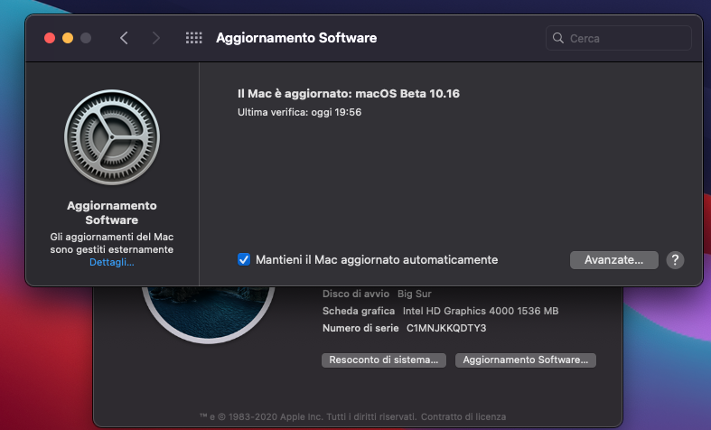

tells me that the mac is updated, do you think that beta 2 does not find me as it is installed on an unsupported mac ??
macbook pro mid 2012
