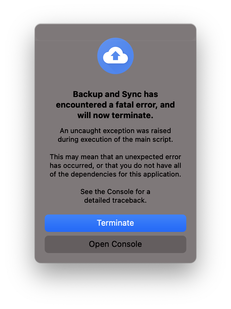

Does Dropbox / google Back & Sync work yet?
U=It does not 🙁

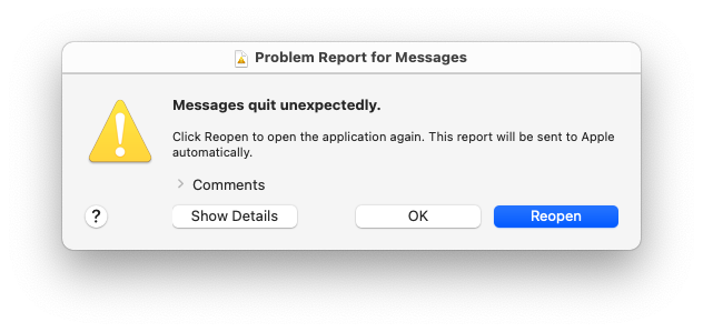

I have had this problem only on my Mac Pro (MacPro6,1) when I launch the Messages.app it bounces once, shows the dot under the icon, then the dot goes away, and I get the error message:
Now, on my MacBook Pro (will get identifier later) 15", which is the model prior to the 16", Messages launches without any issues. It's the only thing I have had problems with testing... I will probably deep dive into this to see what else I can find...

I am really curious if other people have experienced this issue with Messages...
I have had this issues on my mac Mini 2018 from beta 1, and today, no change.
