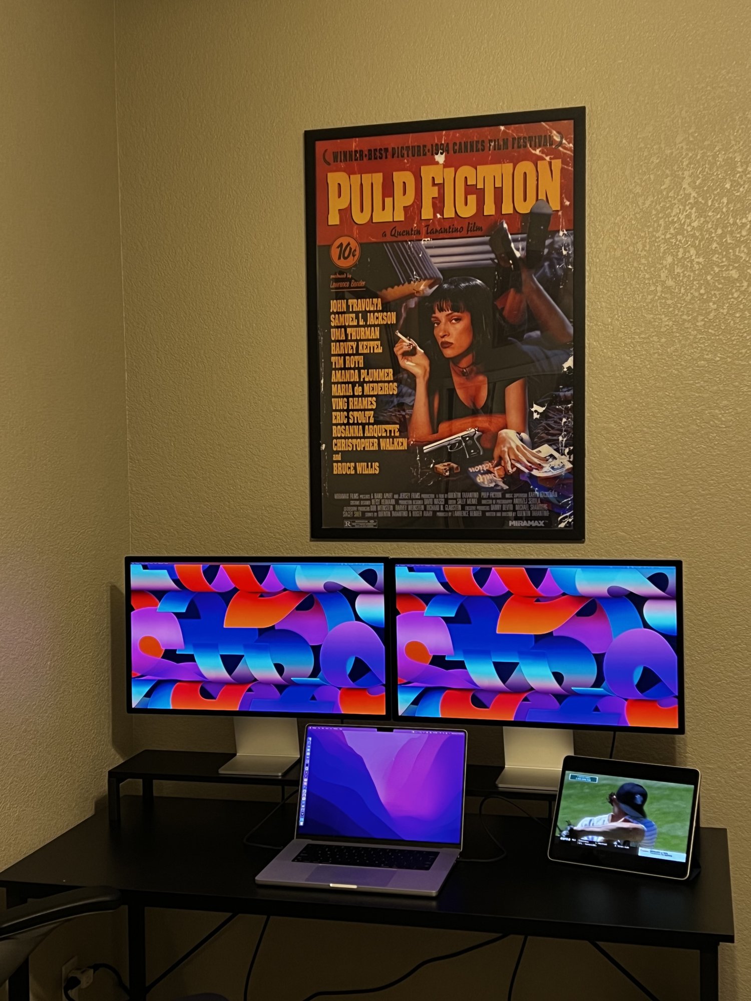

Received my ASD’s last week but finally had time to build my desk and set them up. Amazing build quality.
