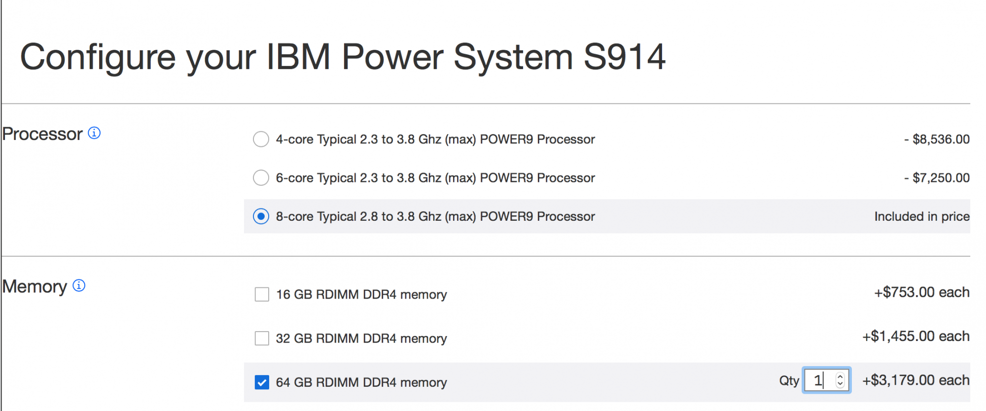

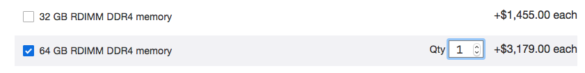

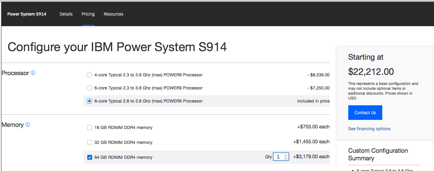

Also, Apple charges $10k for 12 x 64GB RAM in the Mac Pro. Imagine how entertaining the reaction would be if customers instead had to pay 12 x $3,197 = $38k! :eek:
