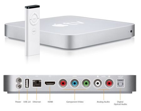

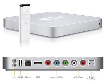

This article overlooked the genuine 1st generation Apple TV (2007). I still have two of these....
