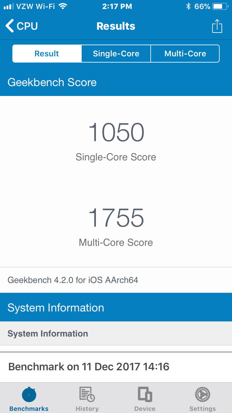

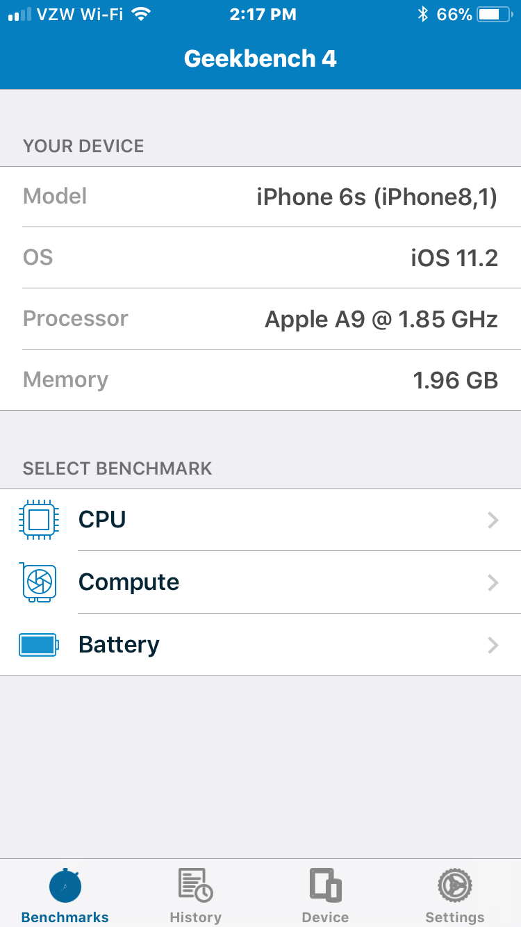

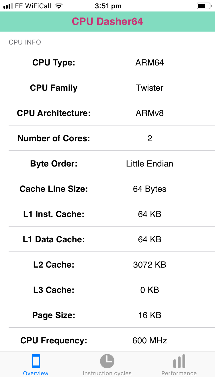

2557/4408 Geekbench Score while at 100% battery life
1052/1758 Score while at 20% battery life...
Sporadically shows 1848, 1500 and 600 MHz in CPU Dasher
iPhone 6S. iOS 11.2

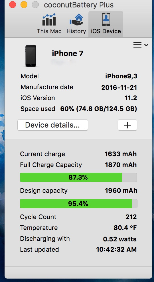

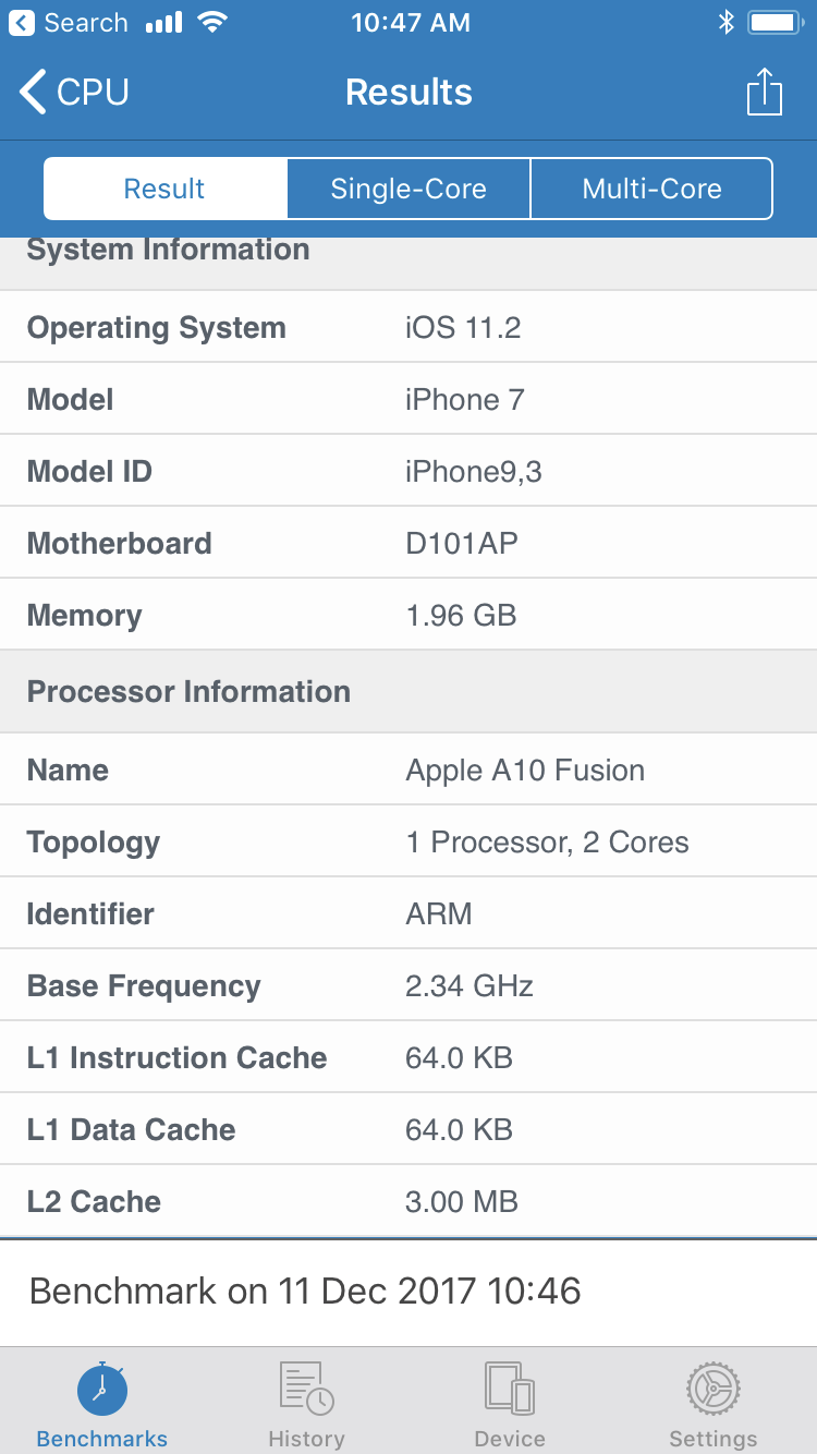

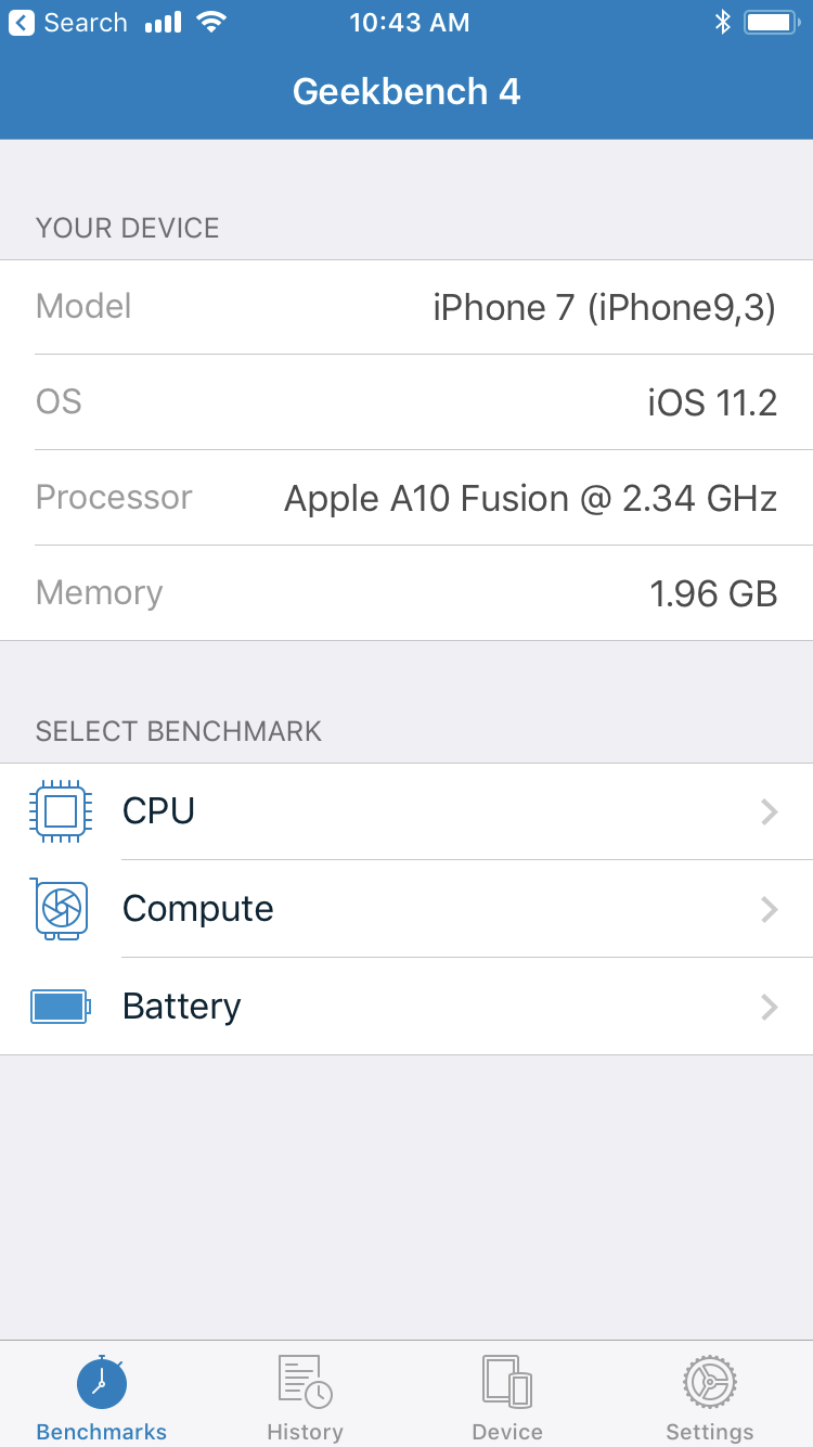

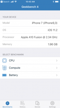

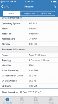

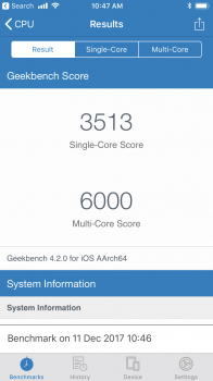

All I can say is that my iP7 still runs a champ.

This whole thing rubbed me the wrong way. A lot of outlets never picked up on that the software band-aid for the 6S shutdowns just throttled back the SoC to not be as bursty, reducing performance quite a bit (I think I more than doubled time in Octane).

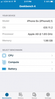

Crap, I just checked mine (6S), battery was at about 45-50%, CPU at 1515 Mhz, started to charge and it went all the way up to 1800+, it's just over 1 year old.
Not good.
iPhone 6s is already an old phone now?
Nope, Apple is still selling the sucker now. Without the optimized stock iOS 9 though...
My 6s is still running great, despite passing 2 years old now. YMMV, but my experience was that it performed better with iOS 10 than the original iOS 9 and performance on iOS 11 is similar to iOS 10, but battery life was somewhat worse initially, but seems to be back to normal with iOS 11.2. I did have my battery replaced under the 6s battery replacement program about a year ago through. If my phone was sporting a 2 year old battery I would probably be looking at either a replacement battery or a new phone...

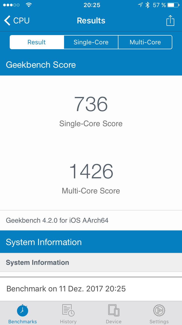

Omg. For years I was wondering about the speed of my devices. Now I "know", it seems. I don't know how my batterys health is but a score of 736 for an iPhone 6 seems like a disaster. Sad. :-(
