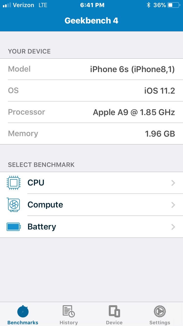

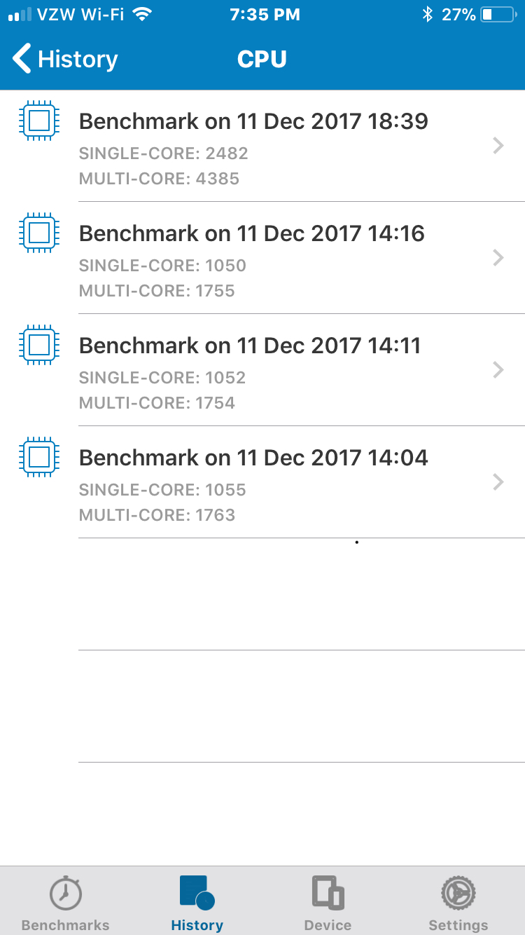

iPhone 6S 64GB (battery was replaced during the battery recall about 1 year ago):
- Ran test at 80% battery, not plugged in
- Single core: 2,517
- Multi core: 4,427
- Clock: 1.85 GHz

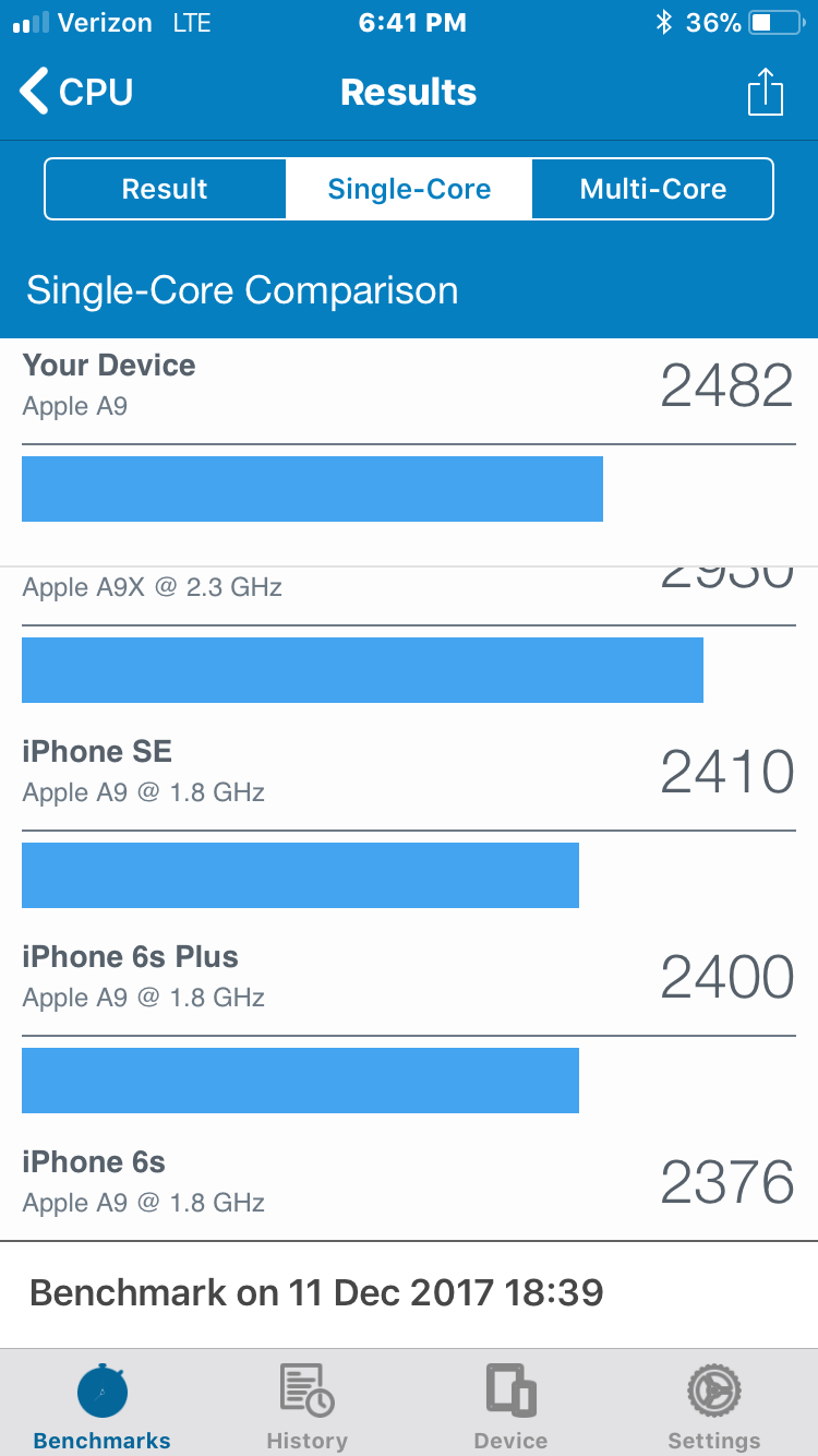

I literally got my battery replaced 30 mins ago when I read about this(was part of the recall but never got around to it). Went from about 719Mhz to ~1800Mhz immediately post battery install and its been there since. It was dogged slow for some of my apps, and its back to normal now. Conspiracy? Not to me. Its proof that apple does slow it down. I for one would prefer normal speeds to loss of battery life. I can prepare for low battery life(turn on low power etc), but when I cannot run apps I was able to run easily before, its infuriating.
Battery percentage is around the same, I had reset the phone etc. Nothing other than the battery change.

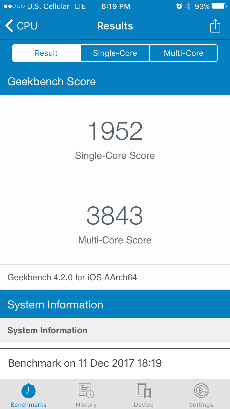

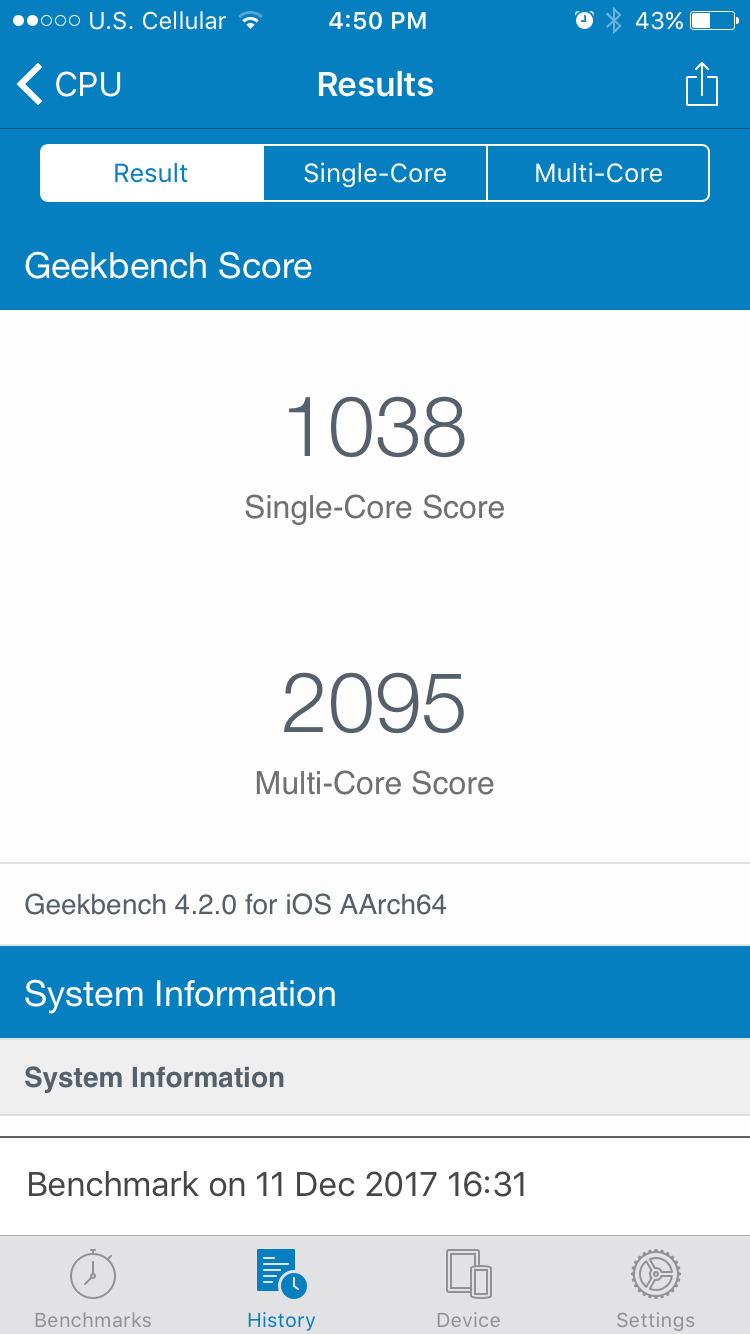

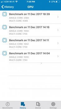

My stats iPhone 6s about 1.5 years old.
[doublepost=1513032715][/doublepost]
With low power mode on stats. Something is definitely weird here. With low power mode on I am getting a better score.
Reactions: BigMcGuire
Wow, almost in the triple digits for single core. Have you tried restarting and retesting?

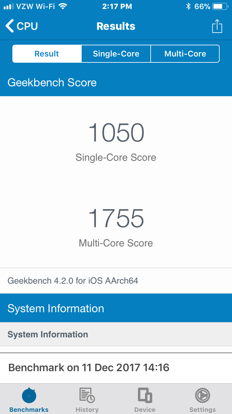

[doublepost=1513037916][/doublepost]I have a 6plus. Remaining battery capacity is 81%, Clock speed is reported at 1400MHz.

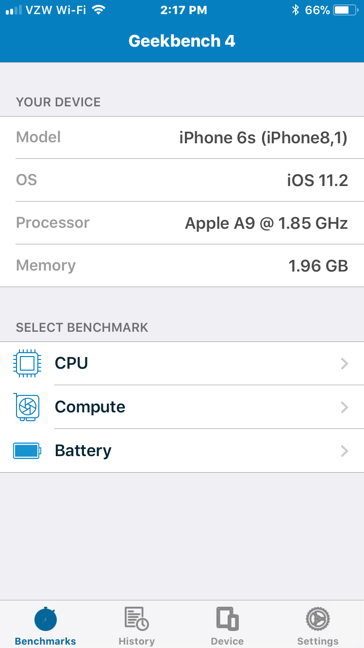

I restarted my phone and closed all apps and reran it and this is what I got. I also charged my phone in the meantime and this is my score at 92- 93% battery life
