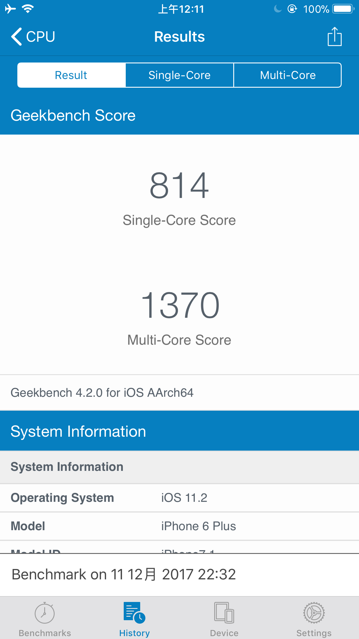

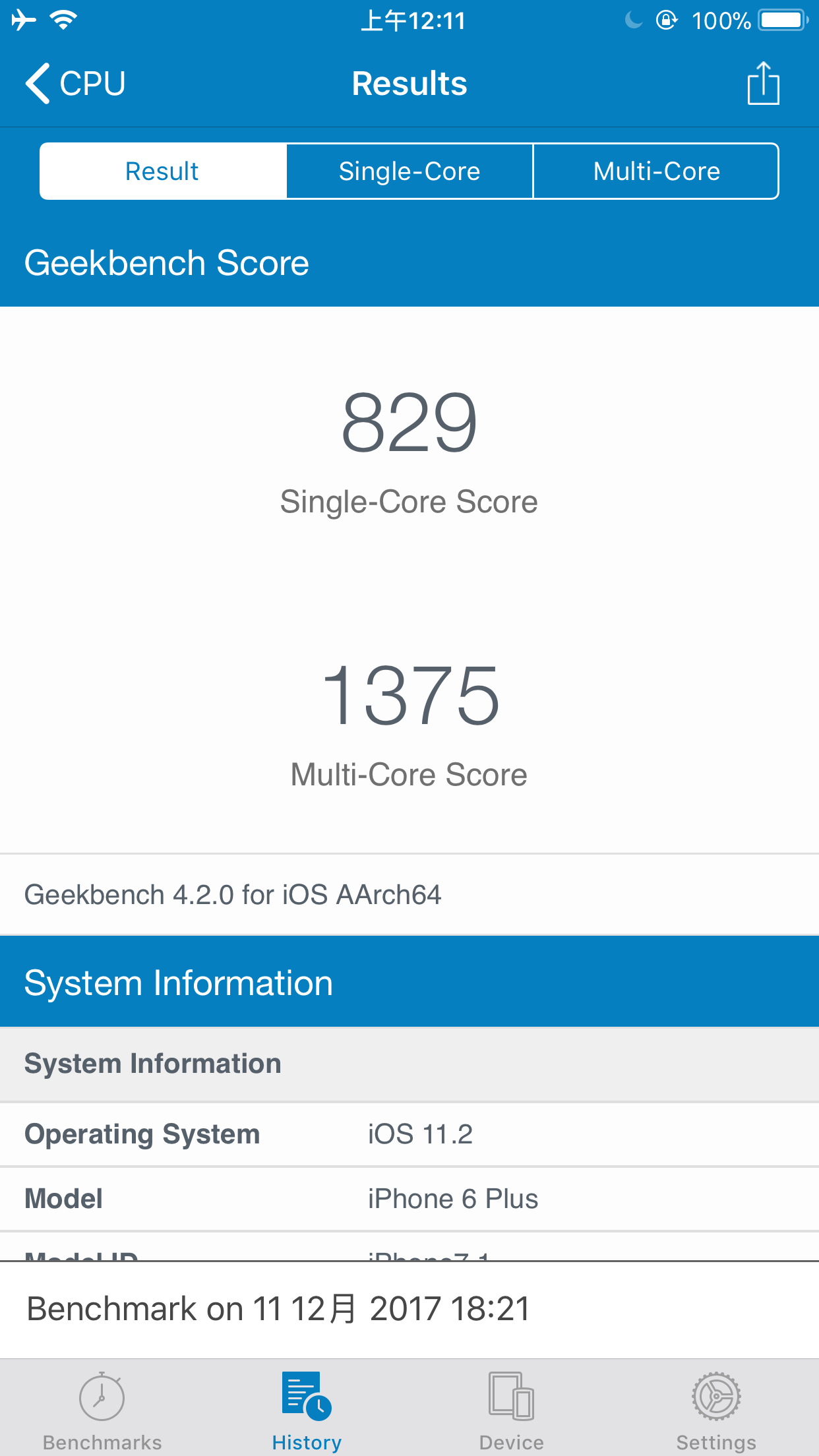

My iPhone 6 Plus is throttled from 1.4 GHz down to 600MHz.
Without me knowing that?
WTF?? Apple?
Look at the Geekbench scores below! It basically becomes a f**king unusable iPhone 5! And I miraculously tolerated it for over 6 months until I was eventually forced to switch to a new iPhone this year.
Before you say anything about my not replacing the battery, most of the time my phone is charged in my office, plus I have a decent portable charger if my battery goes too low, so I kept using the degraded battery in the 6 Plus.
How can Apple do this without telling us? Well I guess Apple always get away with their arrogance, hopefully not this time.
For me, using the 6 Plus during those 6 months was agony. Now I am deeply offended by the lack of transparency. Shame on you Apple.
