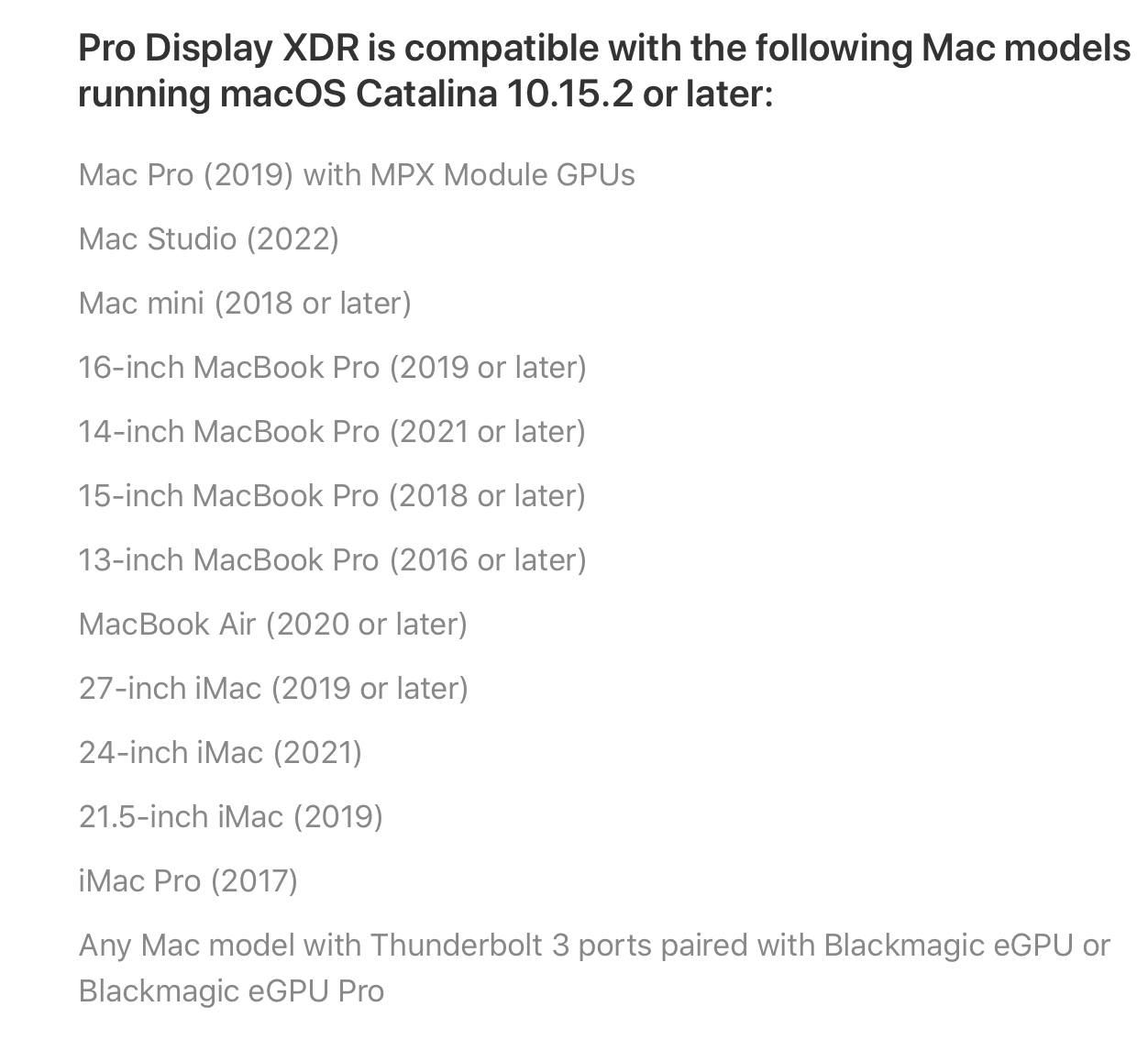

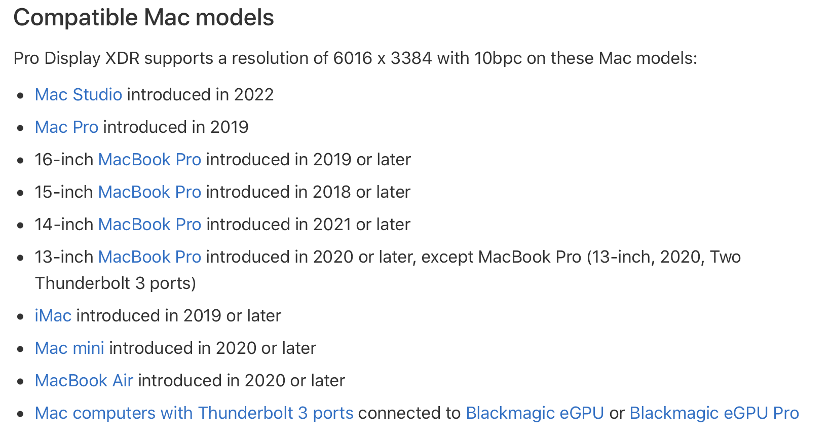

OK, I just found this list of the Macs that can drive the XDR at 6k (and I believe 60 Hz):
And then we have the following superset of all Macs that can officially drive the XDR, irrrespective of resolution. So the Macs on which the XDR is officially supported, but which can't do 6k, would be the disjunctive union (aka symmetric difference) of these two sets, i.e.:
iMac Pro (2017)
Mac Mini (2018)
13" MBP (2016–2019)
13" MBP with two TB3 ports (2020)
