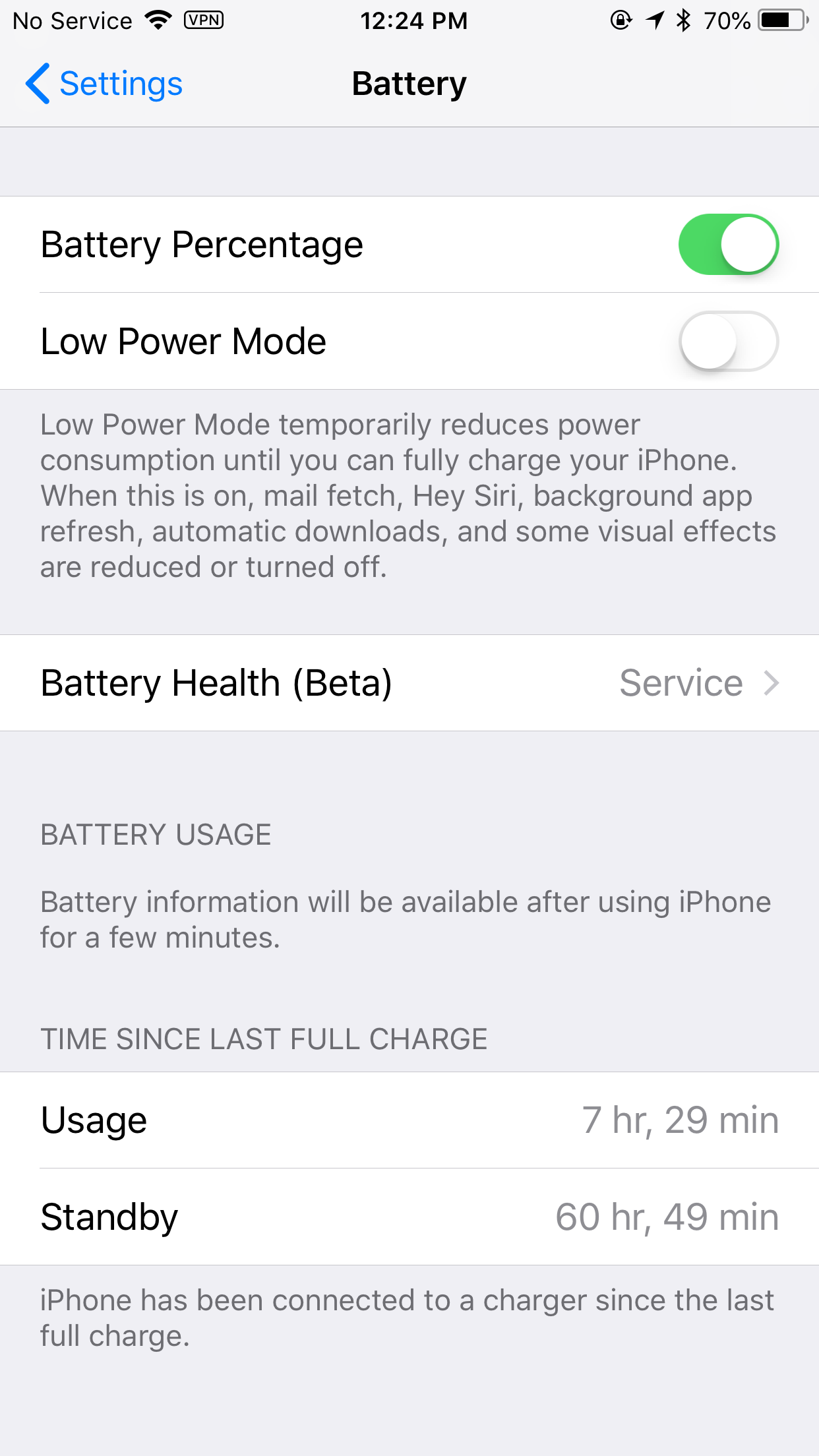

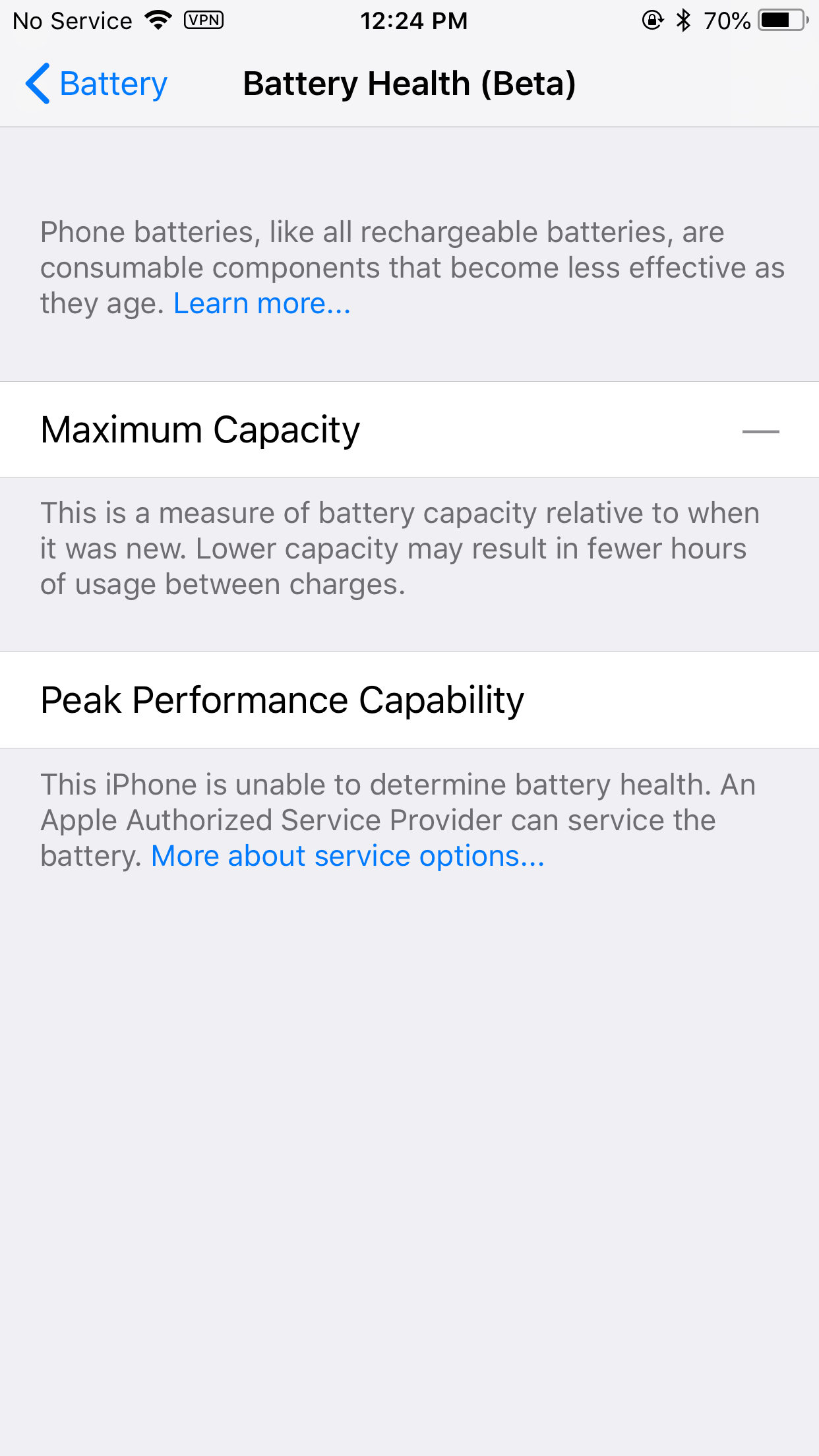

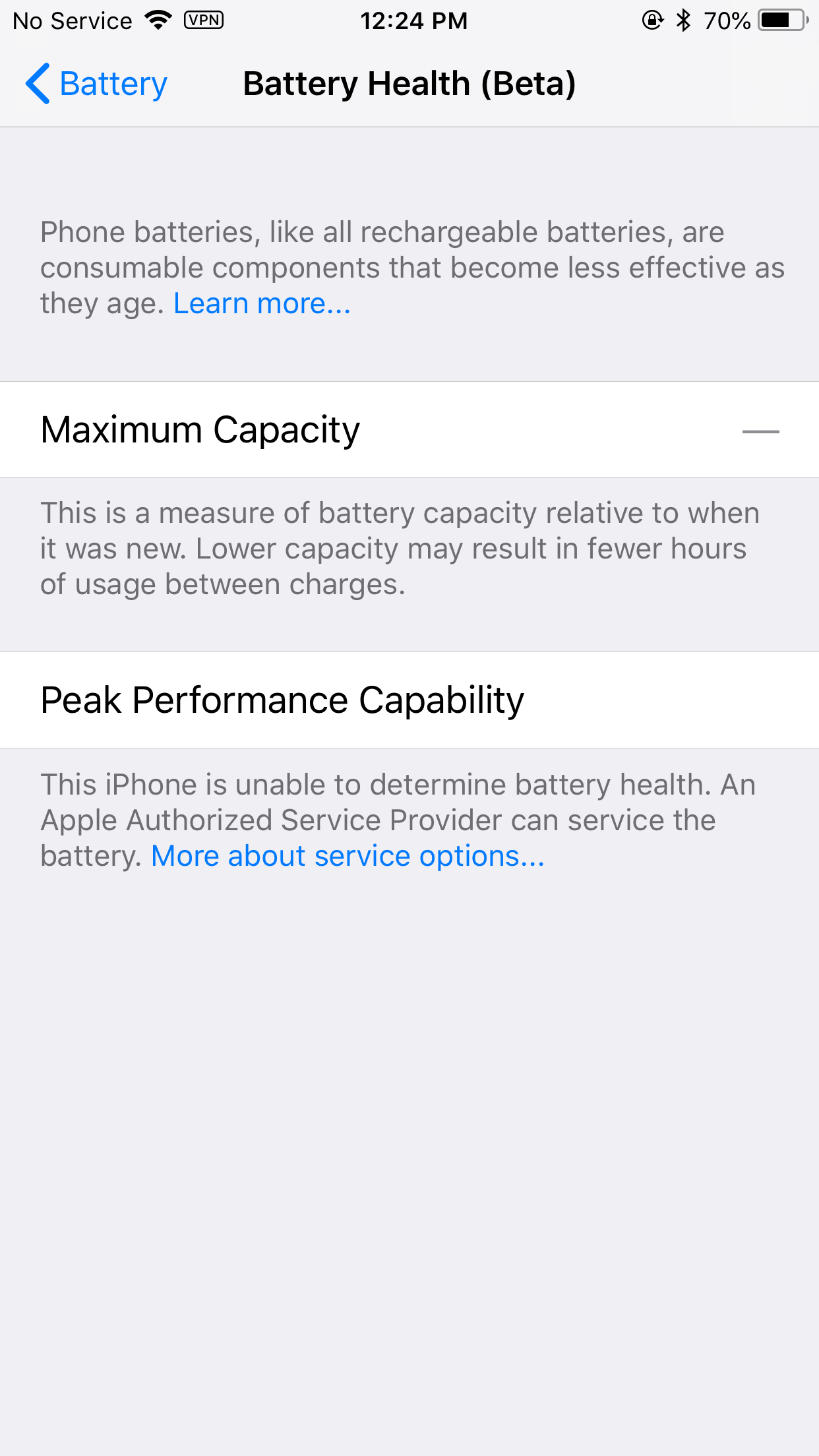

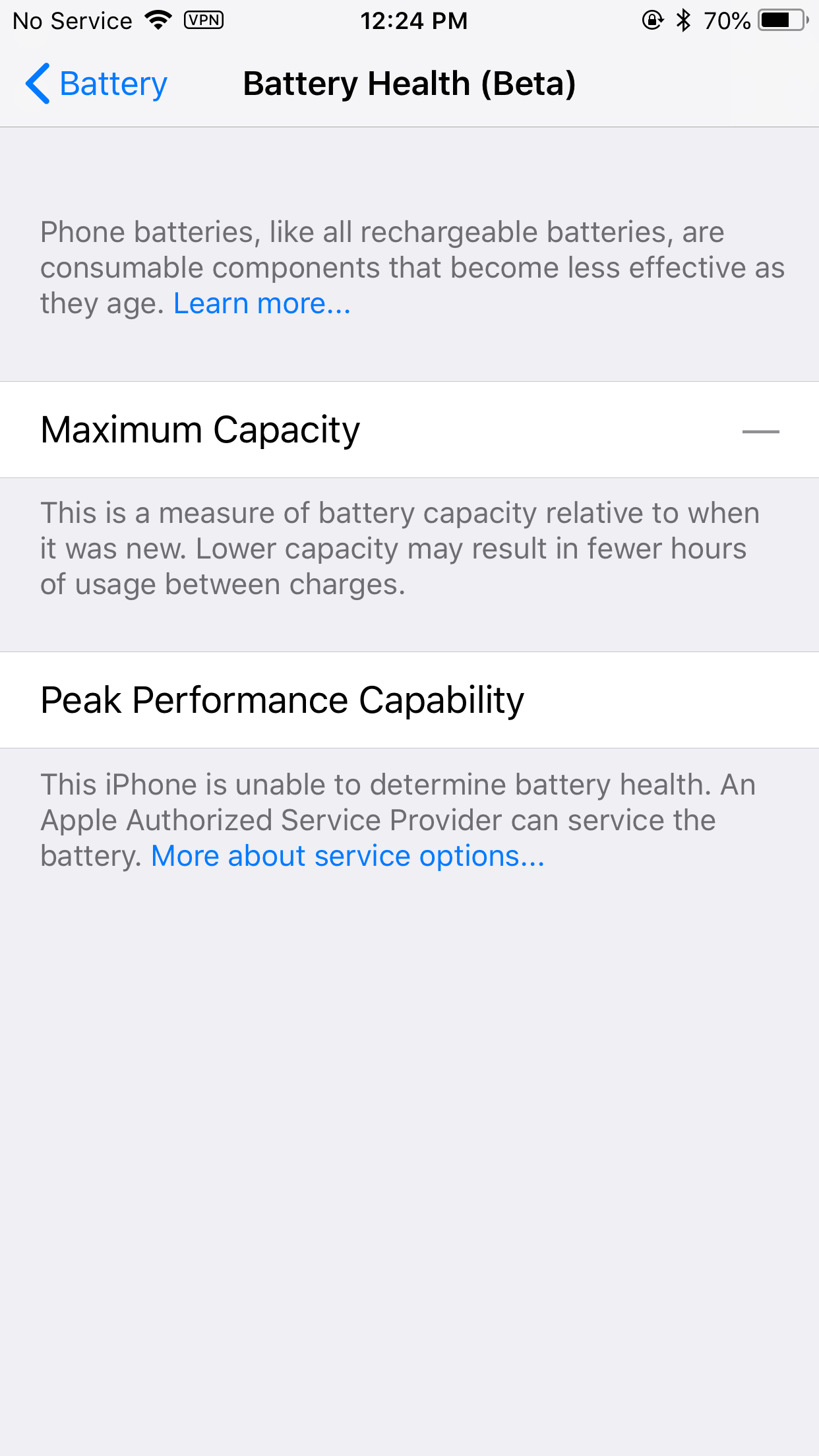

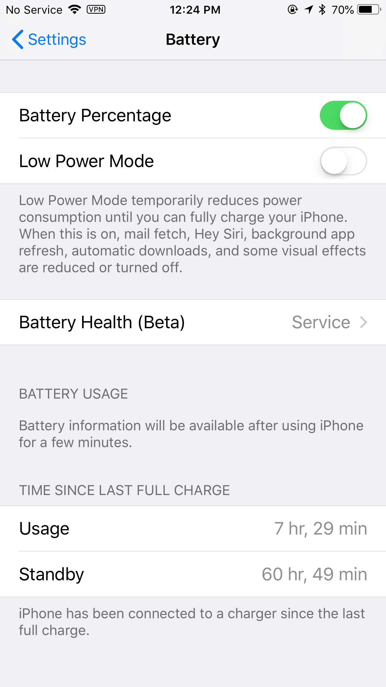

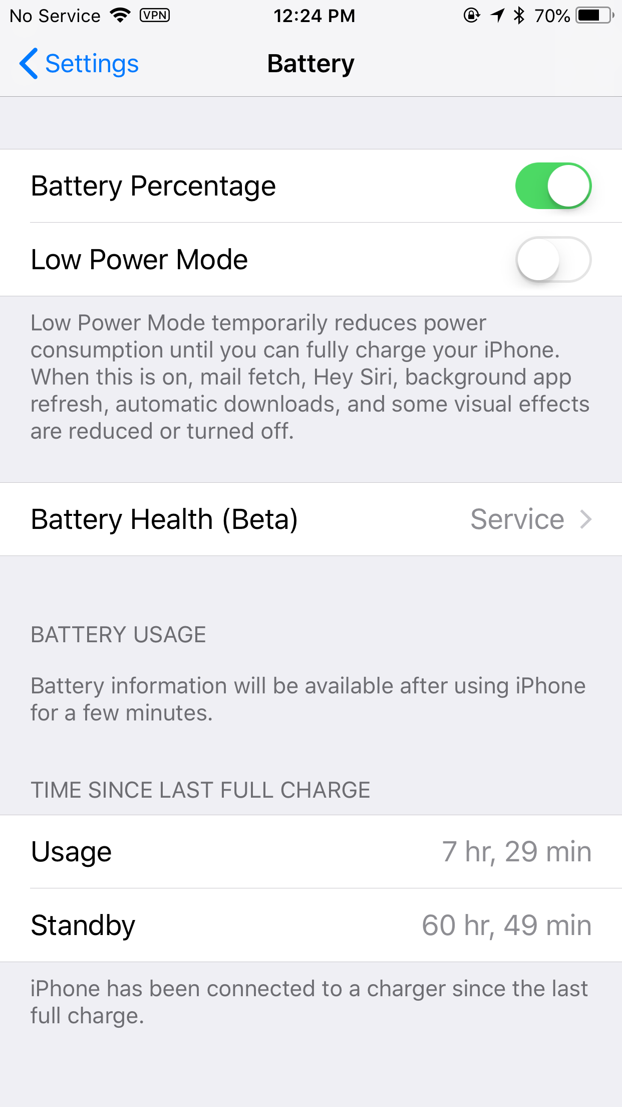

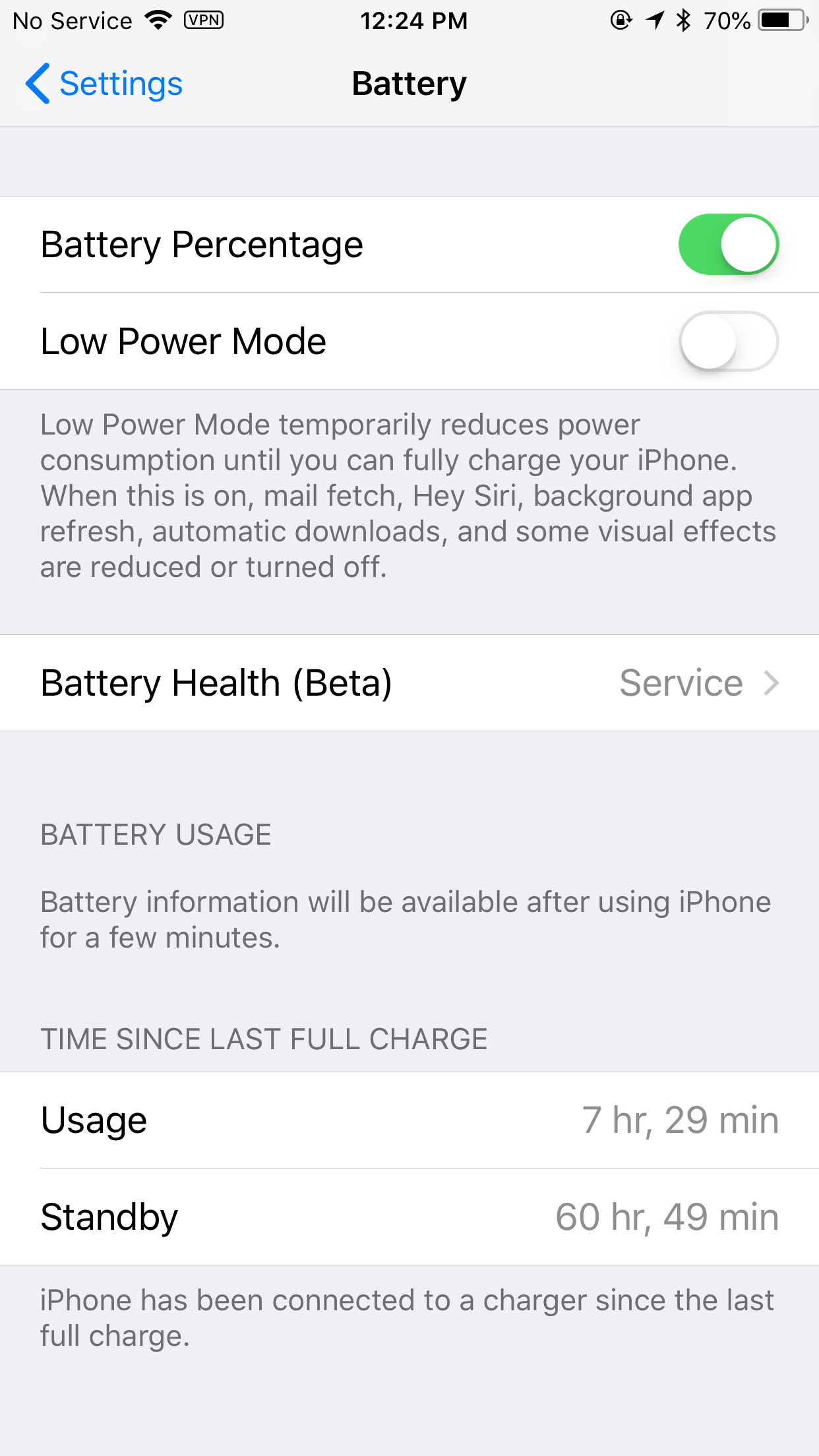

Just realize that when replacing the battery, iOS will now say the battery needs service since it is not an Apple battery.
What's this about? I don't have an Apple battery and iOS doesn't say anything like this. Is this in the latest iOS version only?
[doublepost=1527703681][/doublepost]

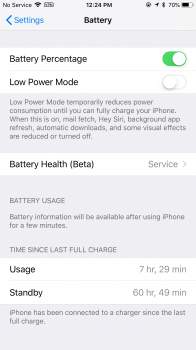

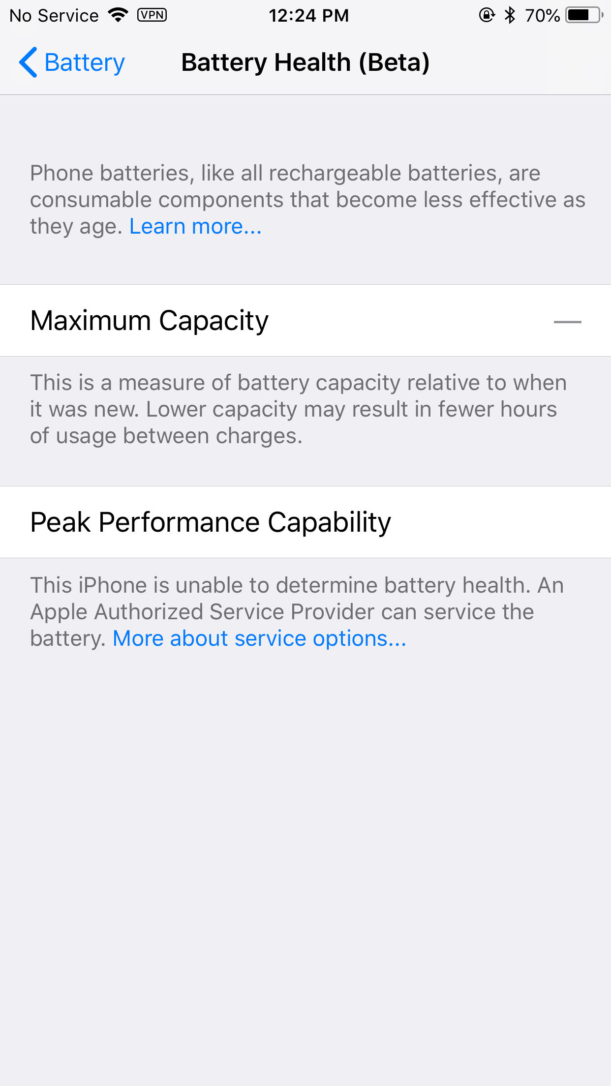

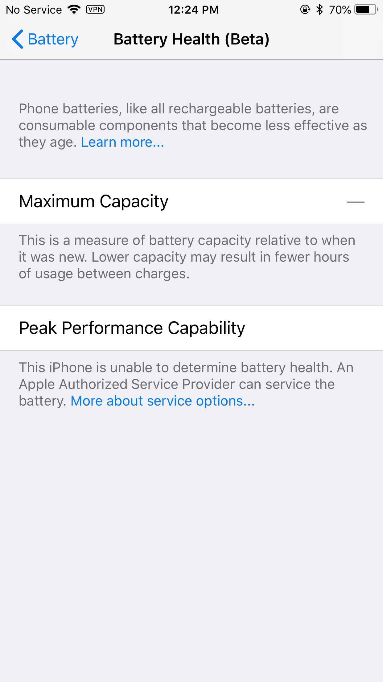

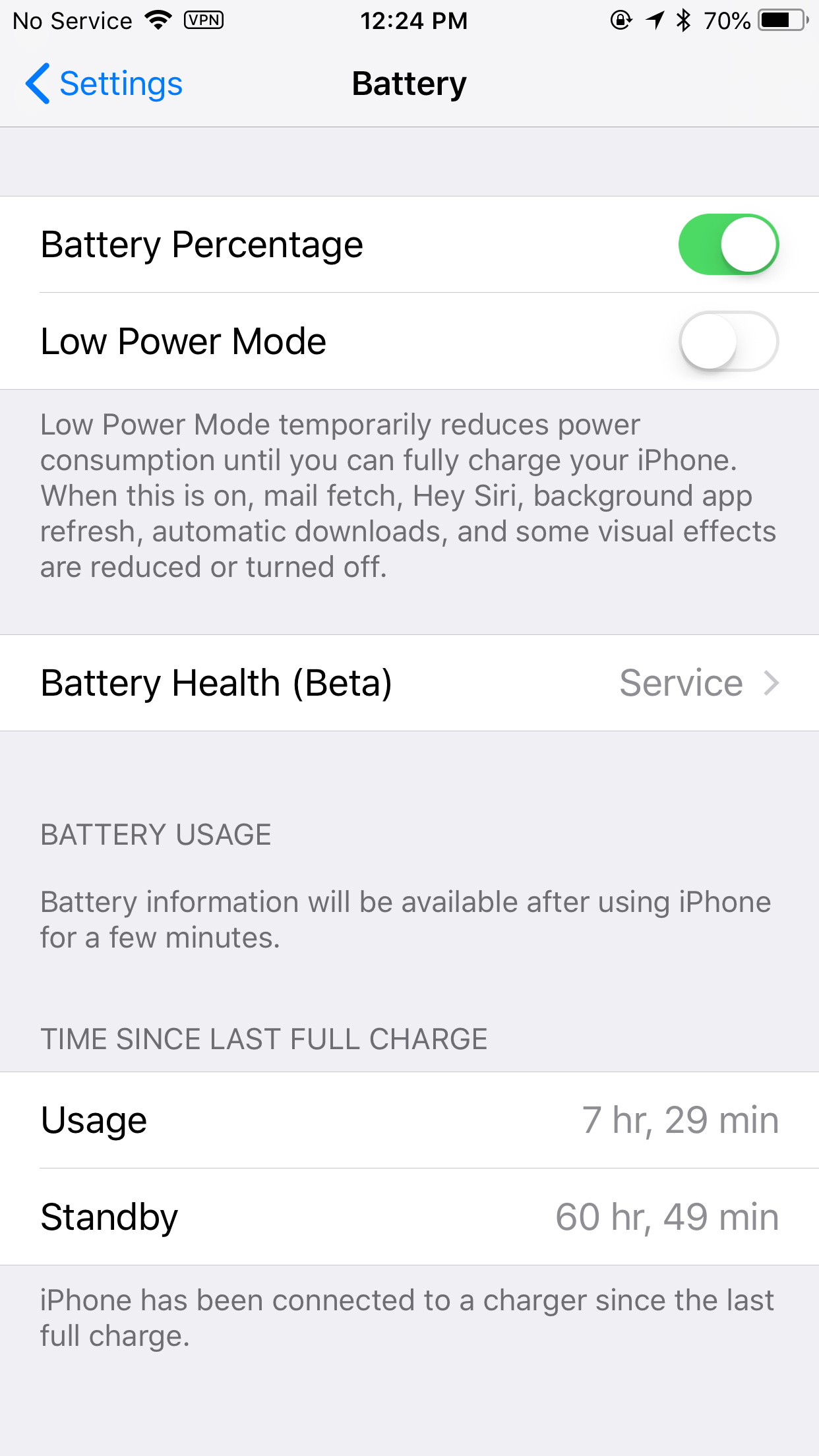

Yes, with Apple power management system.
Interesting. I'm still on 11.3 so I don't get that message in the Battery Health. It's useless anyway since it shows 100% and I know that the battery is jacked (and Coconut Battery confirms).
Does it, in any way affect the phone? I see that it still shows the batter indicator on the top bar just fine. Is there anything detrimental?
I haven't noticed the phone being slowed down in any way. I don't really use it much now. The day I replaced the battery with an iFixit battery in November, I went and ordered a 7+ and then in April, bought an 8+. I'm using the new iPhones on my T-Mobile lines so I really have no use for my 6S+ now. I'm just keeping it as a spare.
I upgraded all these phones from 11.1.2 to 11.3.1 just a few weeks ago.
