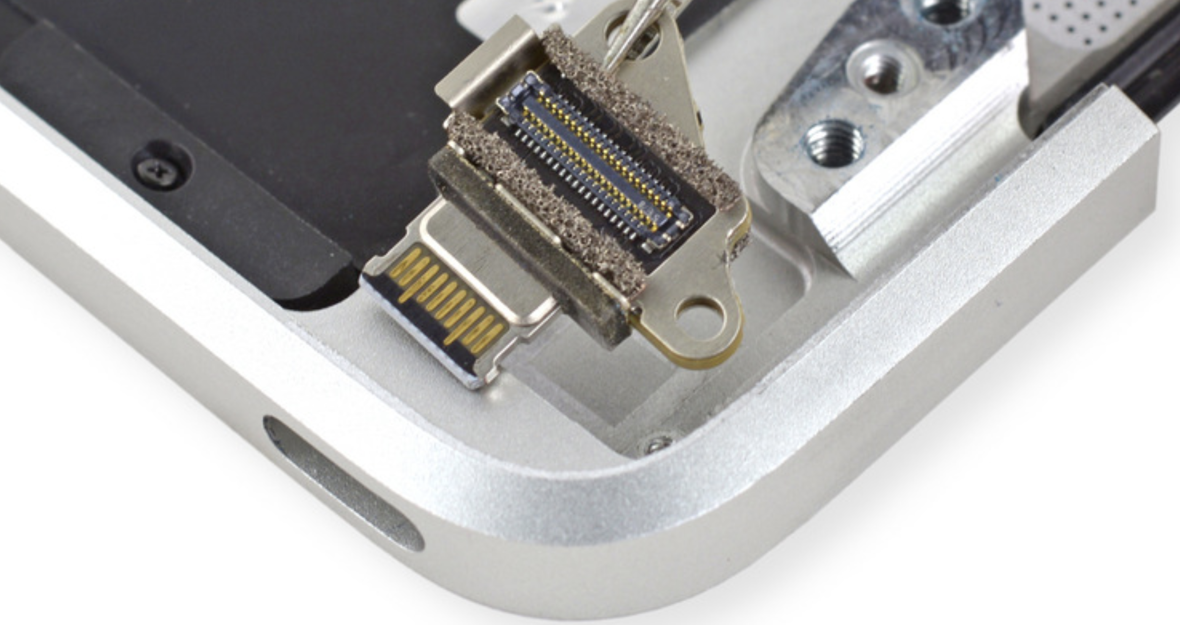

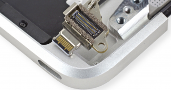

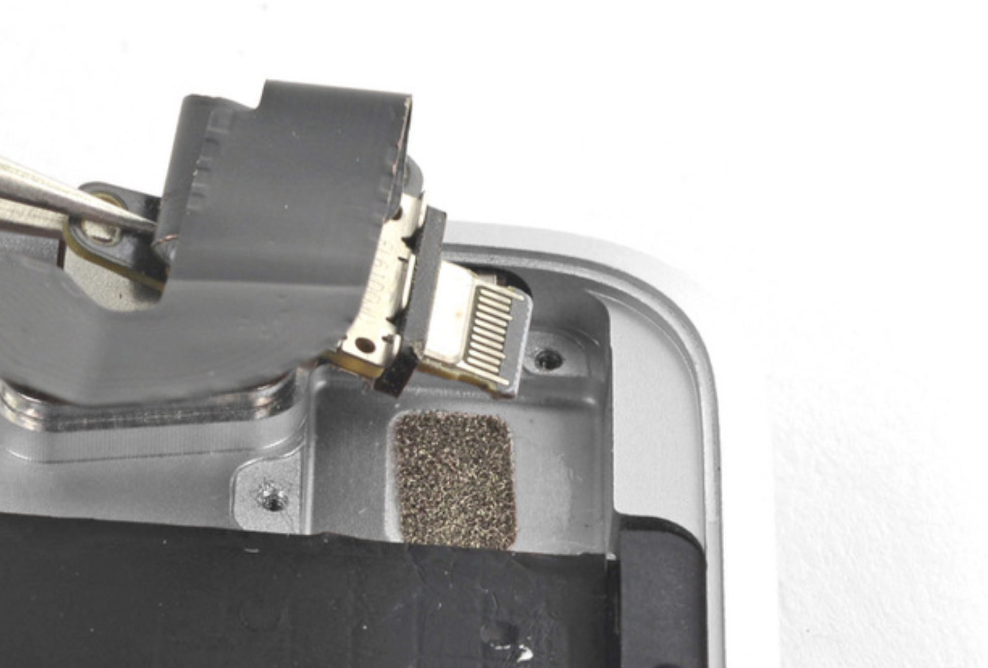

I had a 2015 rMB which had a USB-C port that never clicked. When I got my 2016 MBP (pre-order), I noted that it had a much better feeling when plugging in cables because of that click. However one of the four ports died on me and I took it in for repair. I can't recall if it stopped clicking but it did not charge and it did not recognize anything plugged into it, ever. No amount of wiggling the cable helped.
USB-C ports are on a separate board and can be replaced independently of the logic board. I had mine replaced and they did mention it was a common complaint, so I think they may become a little loose with time.
Anyway it's a simple and cheap repair, if you've got AC then just ask them to replace/adjust the ports. Mention that they have loosened over time. But I wouldn't try convince them that they should 'click' as you keep noting, mine have never clicked, no USB port I can think of has ever clicked. But it should hold the connector snugly.
