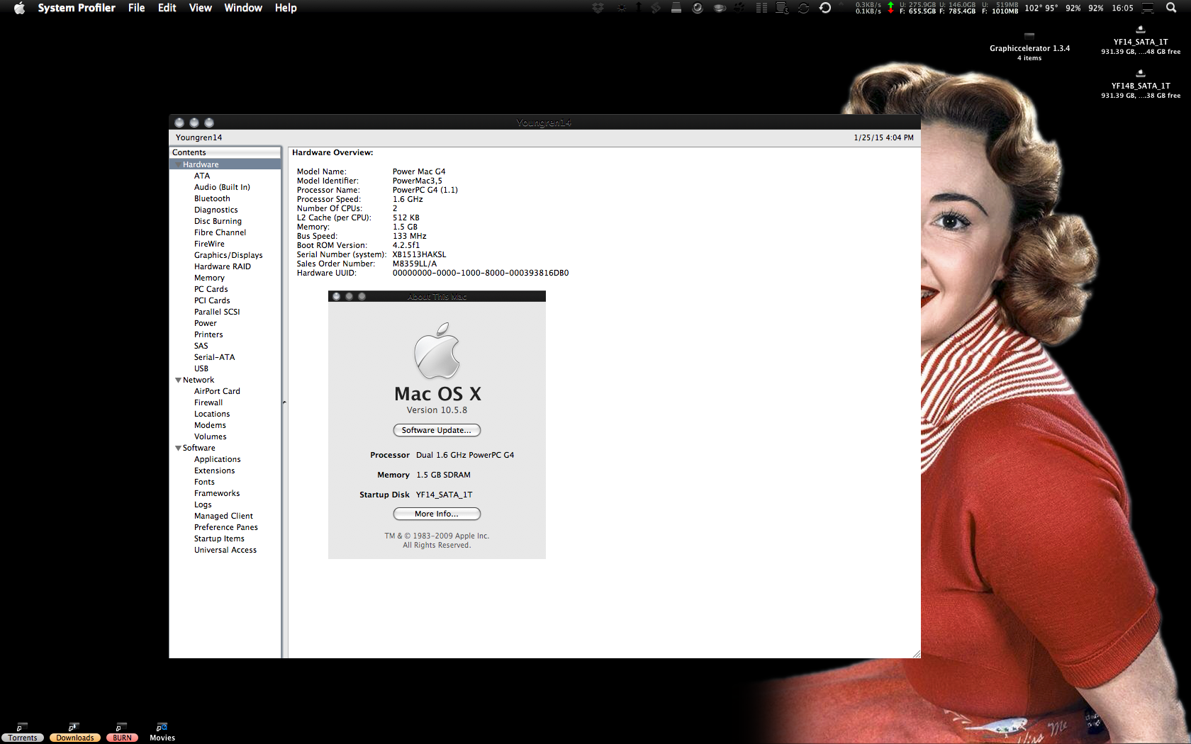

P.S. In other news, this weekend is not a total loss.
The GigaDesigns dual decided it would work for me at 1.6Ghz and 1.5v. That's something!

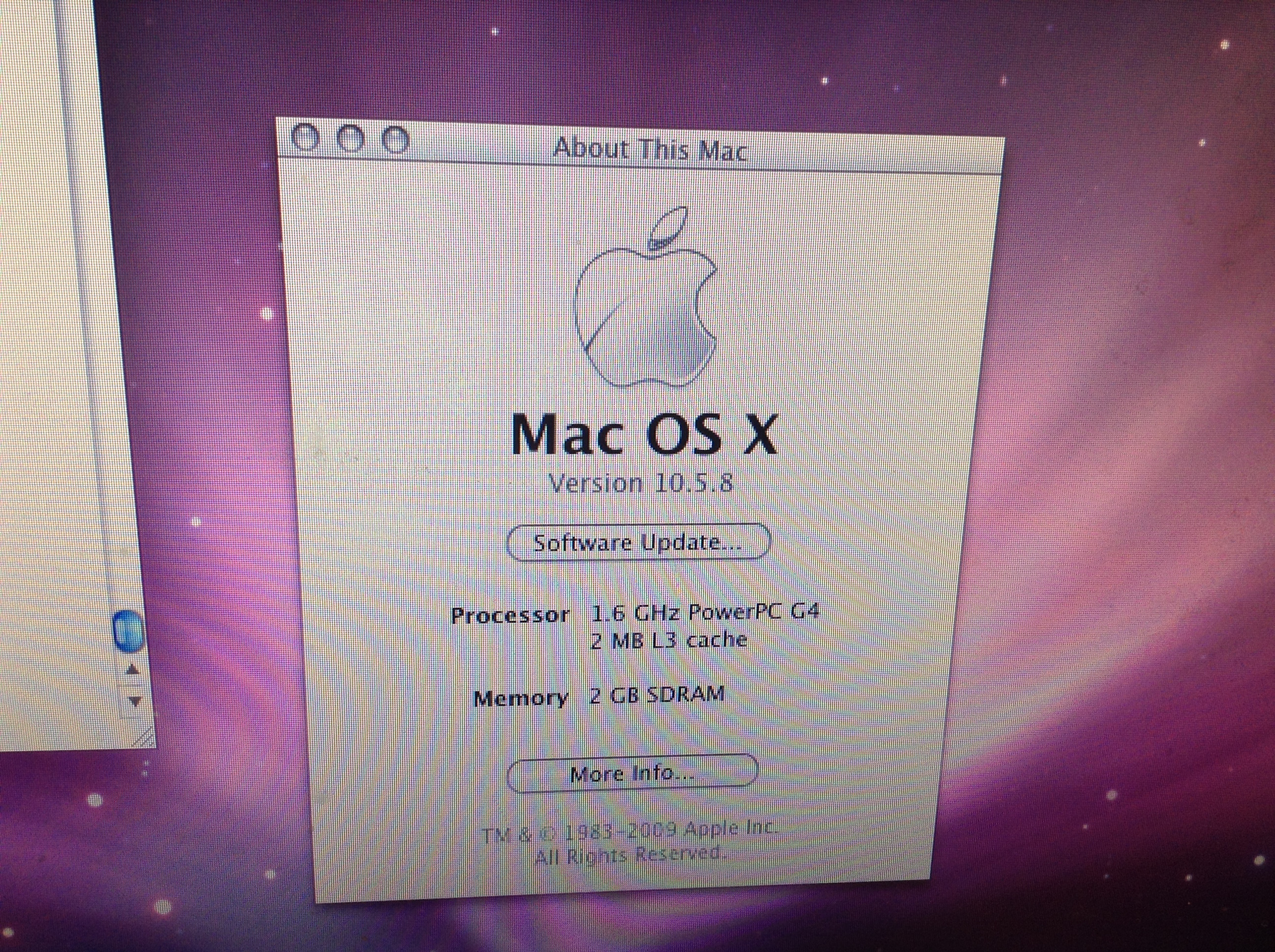

thats cool. Nice going on the giga designs CPU I have a 1.4Ghz Single 7455B Giga designs CPU upgrade sadly its only a 1.25GHz chip factory OCed to 1.4Ghz But I have it running nicely at 1.5Ghz and I even got it to boot and run a bit at 1.6Ghz But applications like geekbench would crash when running its test (even if it ran at 1.6Ghz i cant go any higher as on a 100Mhz Bus i have to use my highest multiplier LOL)
