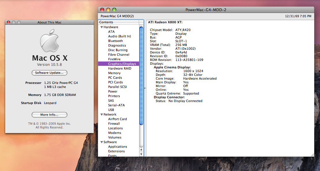

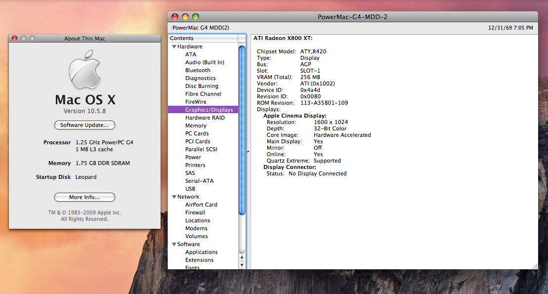

Thought I'd follow up and report that the card is now officially working in an MDD. I did need to install ATI drivers(even under Leopard) to get away from the grayscale screen. The drivers are available on the ATI website, but for those searching you will need to specify 10.4 or 10.3, as selecting 10.5 will tell you that no driver installation is necessary.
In any case, "pics or it didn't happen", so here is the screenshot.
Still no luck with this card in a Quicksilver or DA, but at least it's not collecting dust. Or, more properly, it's now collecting dust in a seldom used MDD rather than collecting dust on my desk 🙂

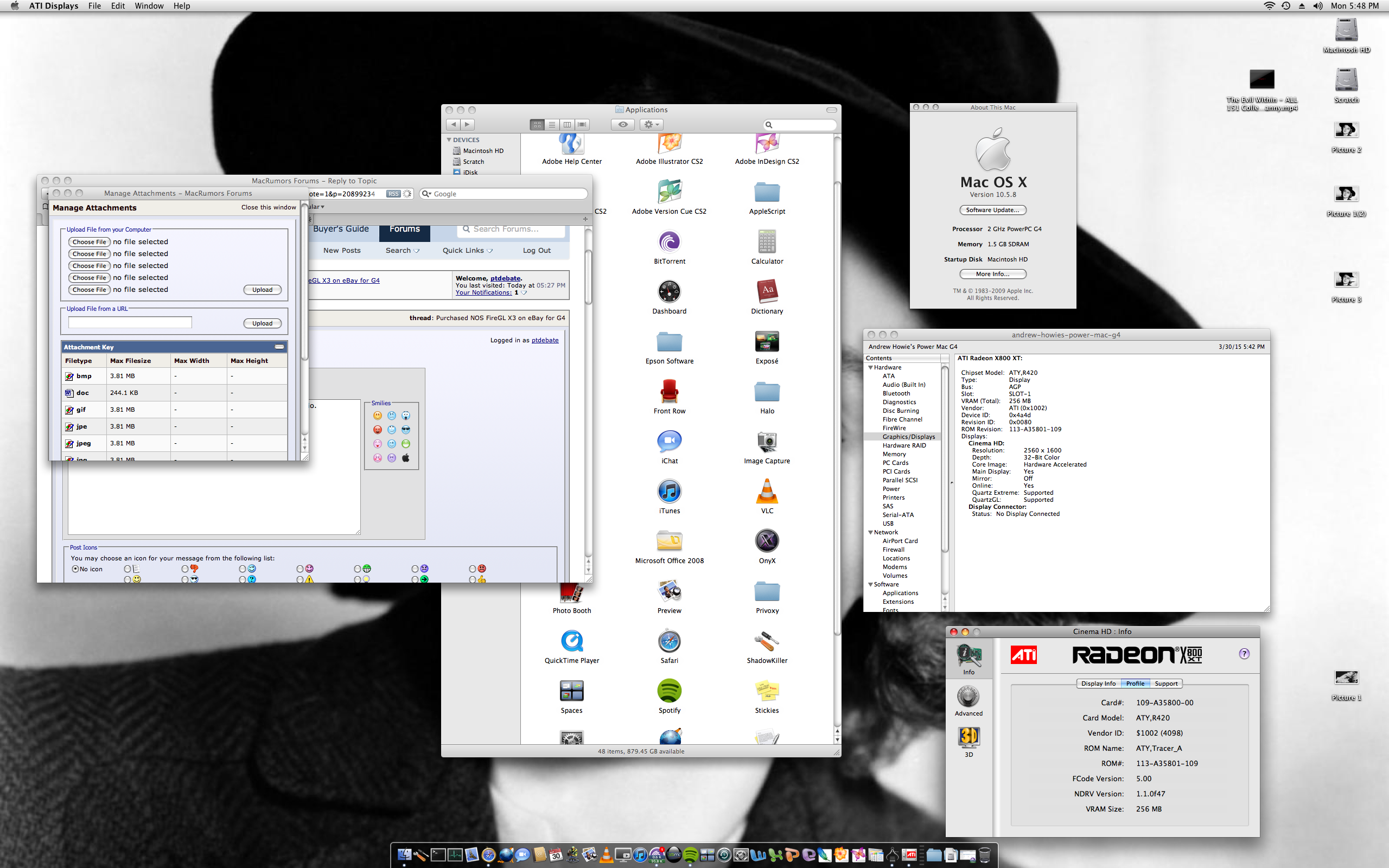

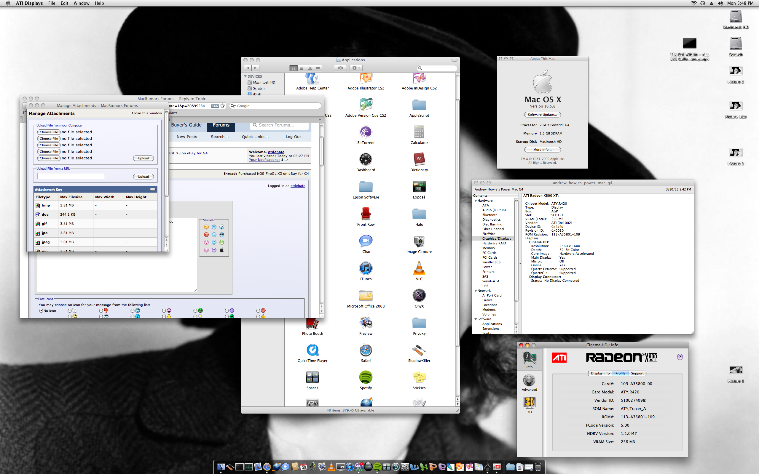

Glad you were able to get it working! Just to follow up with my own results (also posted elsewhere), I was able to get a PC-flashed FireGL X3 running in my Digital Audio 466 (2.0GHz CPU card).
The specific ATI drivers I installed were version 4.5.7 found at the below link:
http://support.amd.com/en-us/download/archive/atidisplays4-5-7
Below see the card in action:
